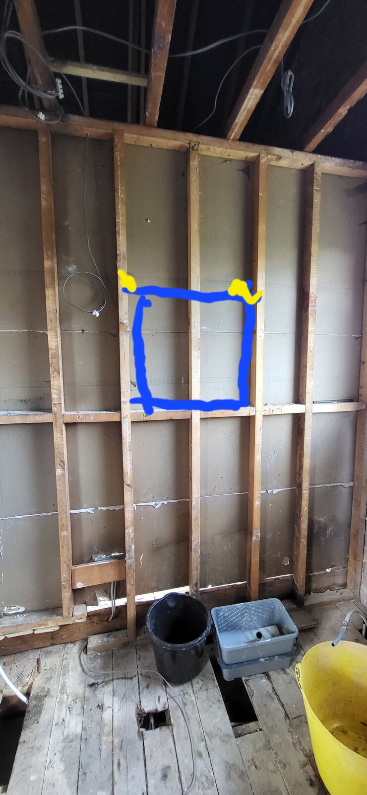

Hi there, currently working on our bathroom renovation and I want to recess a vanity unit into a timber stud wall. The unit itself is 60cm wide so cannot fit in between the 32cm centers. Basically it requires to cut out an entire section of one in order to fit it in. I have all the tools required to do it but just unsure how I would put in the new timers to restrengthen the chunk that will get taken out.
Pic attached shows the existing, and where I want to place the unit

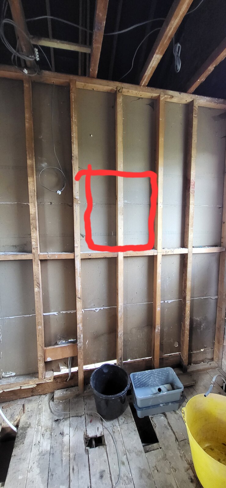

This is what I originally thought. The yellow bit would be 2 joist hangers for the top piece and then another 3 pieces of timber all together in what would essentially be a square frame going around the unit.
Just basically to ensure that the vanity unit wouldn't be bearing any load. Thank you for any advice in advance
320mm is an odd distance for centres. What is on the other side of the wall, or is it a load bearing stud wall? (This is normally evidenced by double thickness sole plates/headers, but not always). I'd be concerned about the studwork at the bottom left of the first picture - the horizontal trimmer terminates before it reaches a vertical stud, leaving the end unsupported. It needs to be doubled up and tied into the vertical stud to the fight of the back box with a vertical piece to the floor at the other end if it doesn't already have one
TBH that wall looks to be a plasterboarded, but is it plaster skimmed on the other side? If so if you should definitely use screws to add your trimmers, not nails, as nailing risks cracking the plasterboard joints. Yes, you ideally need to install two horizontal trimmers at the top, but the PB should hold stuff together for you whilst you cut out. You will need two vertical trimming pieces to carry the PB at the sides of the cutout, but unless the weight of the vanity us excessive, a single horizontal trimmer ar the bottom should suffice
BTW forget the joist hangers, though, they are completely inappropriate and unnecessary for this type of work. Set you work lines with a laser level or a long spirit level and just use 5 x 90 or 5 x 100mm screws - that's all you need

Yes it's plaster boarded on the other side, the room on the other side is getting skimmed next week so I thought that I'd best do this install for thr vanity unit now so that if the board breaks at least then we can re-board before the skimming takes places.
Ah ok nice so two horizontals at the top, yeah the vanity unit isn't crazy heavy, probably around 10kg as it is a metal one. And then obviously with stuff inside it might be around 12-13kg overall.
Ah yes I have 2 laser levels so I can easily do that to ensure they are clean cuts along with ensuring the lines are accurate.
Should I also like get it as tight as possible to the unit so that its essential flush with the joists or should I leave some space either at the top/sides? Thank you btw
I'd leave 5 to 10mm space all round and use packers for the final fit. Timber framig isn'tvalways perfect, as timber isn't always perfect, so a bit of leeway is always a good idea.
As you haven't yet plastered I'd recommend adding a bit of strength the the bottom of the stud wall as notedcin my previous post (somehow I missed it out so I edited it in afterwards)
