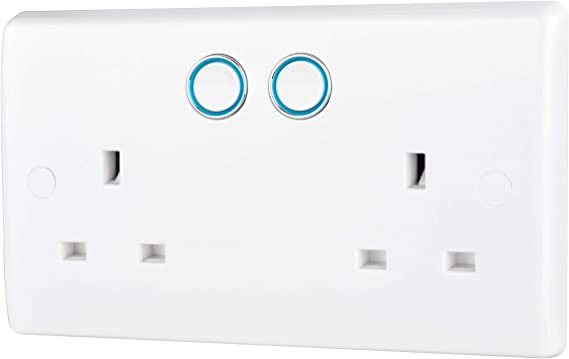

I’ve also got a BG wifi controlled double socket outlet, and have seen lockable double shrouds this might be the way to go???

My first thought was a smart socket, but they also have a button to turn them on/off. The problem is a ring final must feed all sockets to be a ring, so the switching needs to be in the socket or socket box, you can get smart relays, but getting enough room to fit them is the problem.

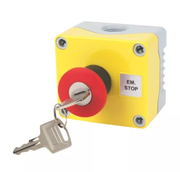

Although not quite it's intended purpose (and in this example, can only handle 10A), I sort of like the idea of one of these...
"OK, you've had your final warning!" - Press the big red button!
And the key is required to reset it.
