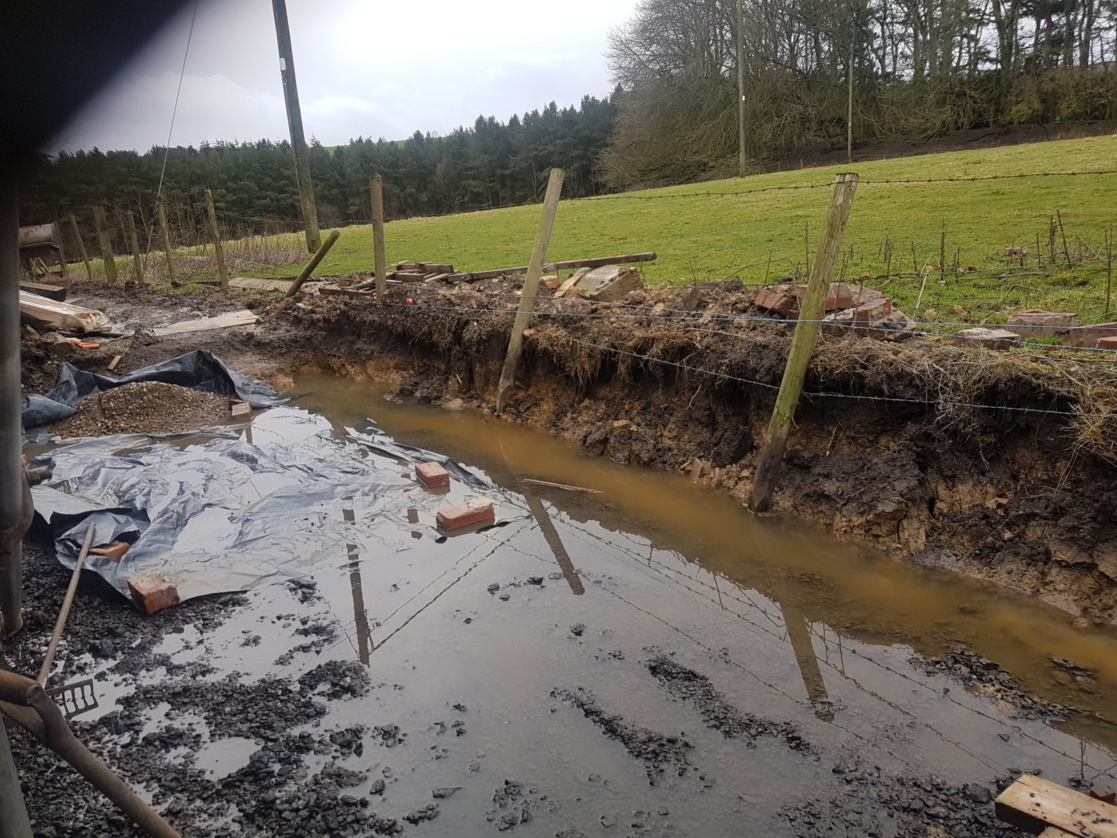

Shortly I hope to begin my retaining garden wall. It will be arounf 7m long and 1m high.
I have dug the founds and have everything ready to pour base.

This is the area I am retaining...It's not this wet anymore!
