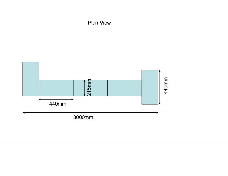

I am about to start building my retaining wall which is going to be 9m long and 215mm wide (7n blocks laid flat) and was wondering if i caqn build the wall right across or if i am meant to put in movement joints. The wall will be 1m high.
I read somewhere that movement joints should be 3m from wall end and every 6m after that going the full height of the wall......does this sound right....will this not weaken the wall?
If i do have to do this should i be laying the end blocks (the ones near the joint) at right angles to the rest....ie 440mm wide
a bit confused about this and just want to get ot right.

It won't weaken it, but, personally, I wouldn't bother with any joints over that length, as you've got "free" ends either end. You could always build some Brickforce into the joints to give it some more resistance to cracking, if you're concerned about it.
Hi, Trevor,
Yes Shytalks is right, 9mt does not require movement joints. expamet in the bed joints would make the wall tremedously strong, but as your laying the blocks flat it will be plenty strong enough anyway.
Just don't forget to put some weep tubes in near the base just in case there is any water build up, and some gravel or small hardcore packed in behind will help with drainage.
