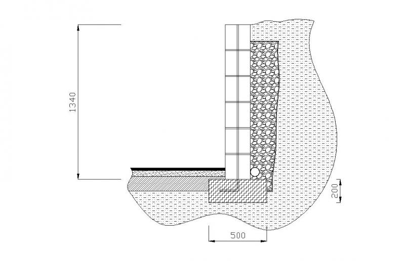

Good morning all...
I've been trying to sort a retaining wall in the garden for ages but never really sorted it. Anyway I've dug out the area "nearly" and am ready to begin the wall.
From everything I have read the best option seems to be the hollow blocks on a good foundation with re-bar through the holes and then back filled with cement.
I'm building from ground level approx. 1200mm height. Backfill with stone and a drainage pipe around the back of it. I have made a small sketch attached.
Does this sound like the correct option? Is my foundation deep enough? The ground is heavy clay.
How do I hold my rebar inplace while casting my foundation and do I need to bend the ends?
Thanks,
Ant

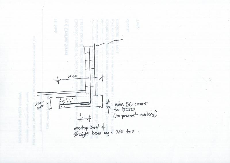

Maybe a proper SE can tell you,
the rebar sounds over kill, building regs state the wall must be 1/4 of the height its retaining.
I would extend the fondation into the retained side, this would act as a cantilever.
If you reallly want to go down the rebar route you could make a jig to hold it in place, or mix the footing very firm then build a course immediately.
best ask a proper SE though!
Ideally your foundation should extend considerably further forward than the front face of the wall, and the reinforcing bars bent and taken further into the concrete.
This enables the whole structure to be monolithic and shaped like letter 'L'. Any lateral pressure on the wall from behind is then partly resisted by the bearing of the 'toe' of the concrete on the ground.
What should I extend the fondation too? Out to 900mm? Does the depth look ok at 200mm? How deep do you think the rebar should be?
Also how do I hold the rebar in-place?
Thanks,
Ant
Just updated the drawing.....also this my help but its a horse shoe shape that will help its strength.
That's it but;
I would go for a slightly longer base (particularly iff the retained soil is not very cohesive);
Make sure there is sufficient concrete cover to the bars;
Overlap the bent bars with some straight ones, to develop the full resistance moment of the concrete.
The curved shape will also help.
Personally I would flip Tonys base around so it projects under the earth at the rear - then the self weight of the earth stops the wall overturning. Also consider that you might need to get the bars bent for you - they're not easy to bend! It could also be done as a gravity wall if you just wanted to lay loads of brick and block, probably about 450-600 wide at its base tapering to 215 at the top.
Yes, that is another way, though I presumed the OP would not want the hassle of digging away the earth at the back only to reinstate it.
And yes, if space is not a problem, it might be easier for him to do a gravity wall.
