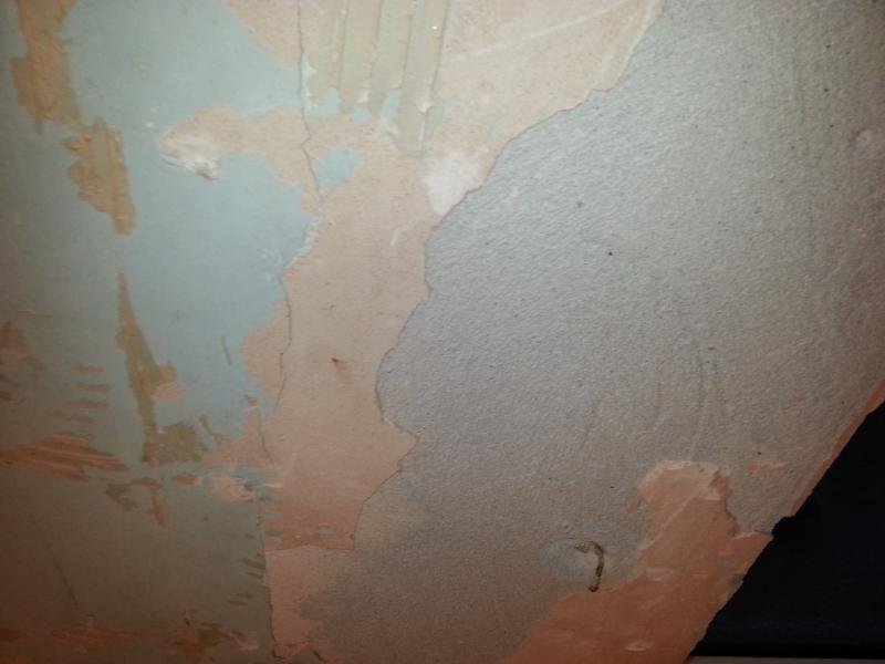

retiling on cement surface in the bathroom
16 Dec 2013
3
Bristol
my bathroom need a bit retiling. I knocked some loose tiles off. There are two coats on the brick wall. One is cement base with thickness around 10mm. The other pale red-Brown coat on the surface is much thinner with thickness around 1-2 mm. The thinner coat is loose.
I was wondering how can I redo the thinner surface Is this a
Plaster surface? Is it OK for me directly tiling on the cement coat without redo the thinner surface? And how can do the retiling properly? Do I need some primer for the adhesive and grout?
