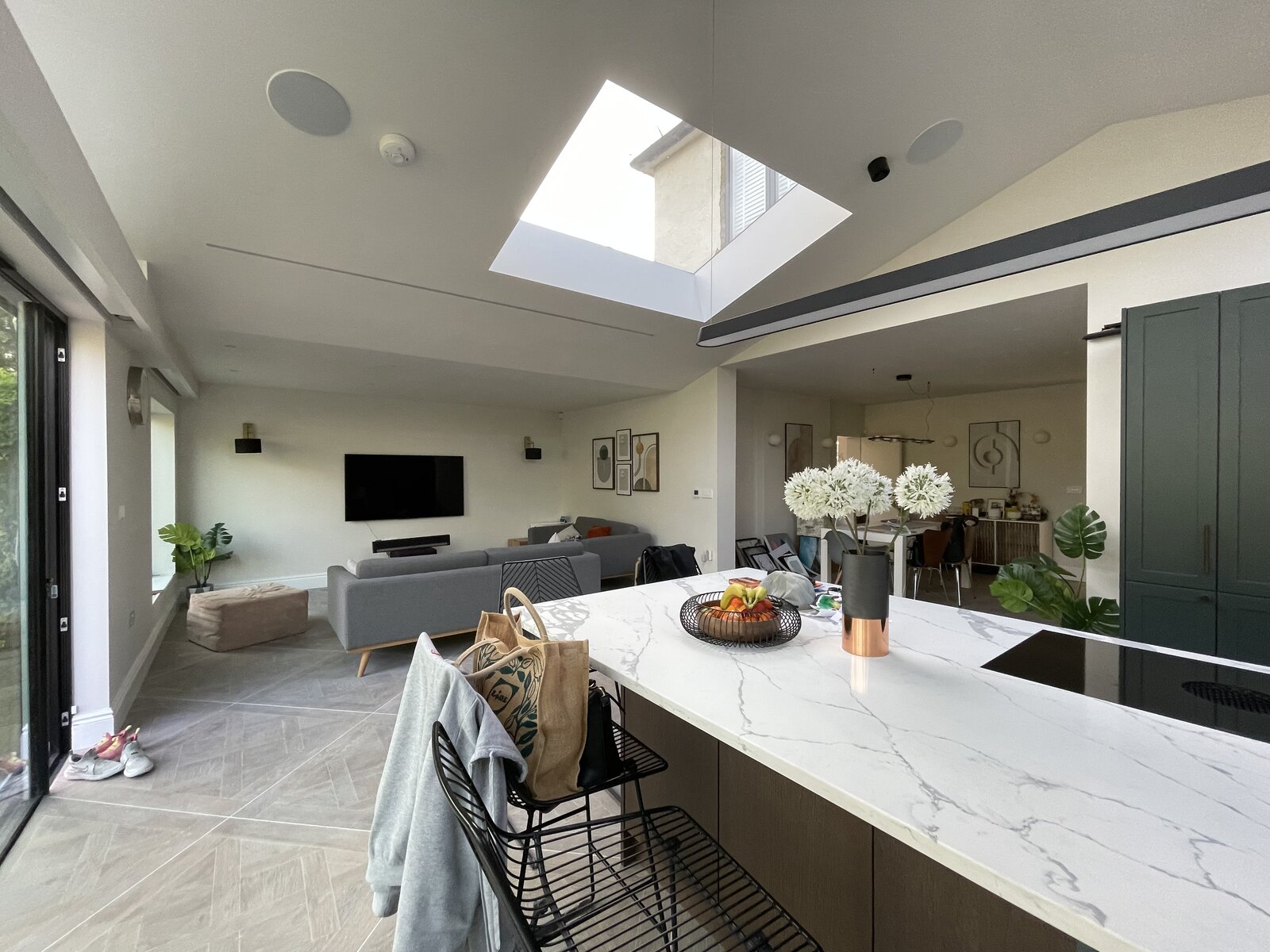

While retrofitting UF heating is a BIG task, end results are different level.
Done up this in last three houses son has been in
All of downstairs no radiators, all overlay 10mm pipe
