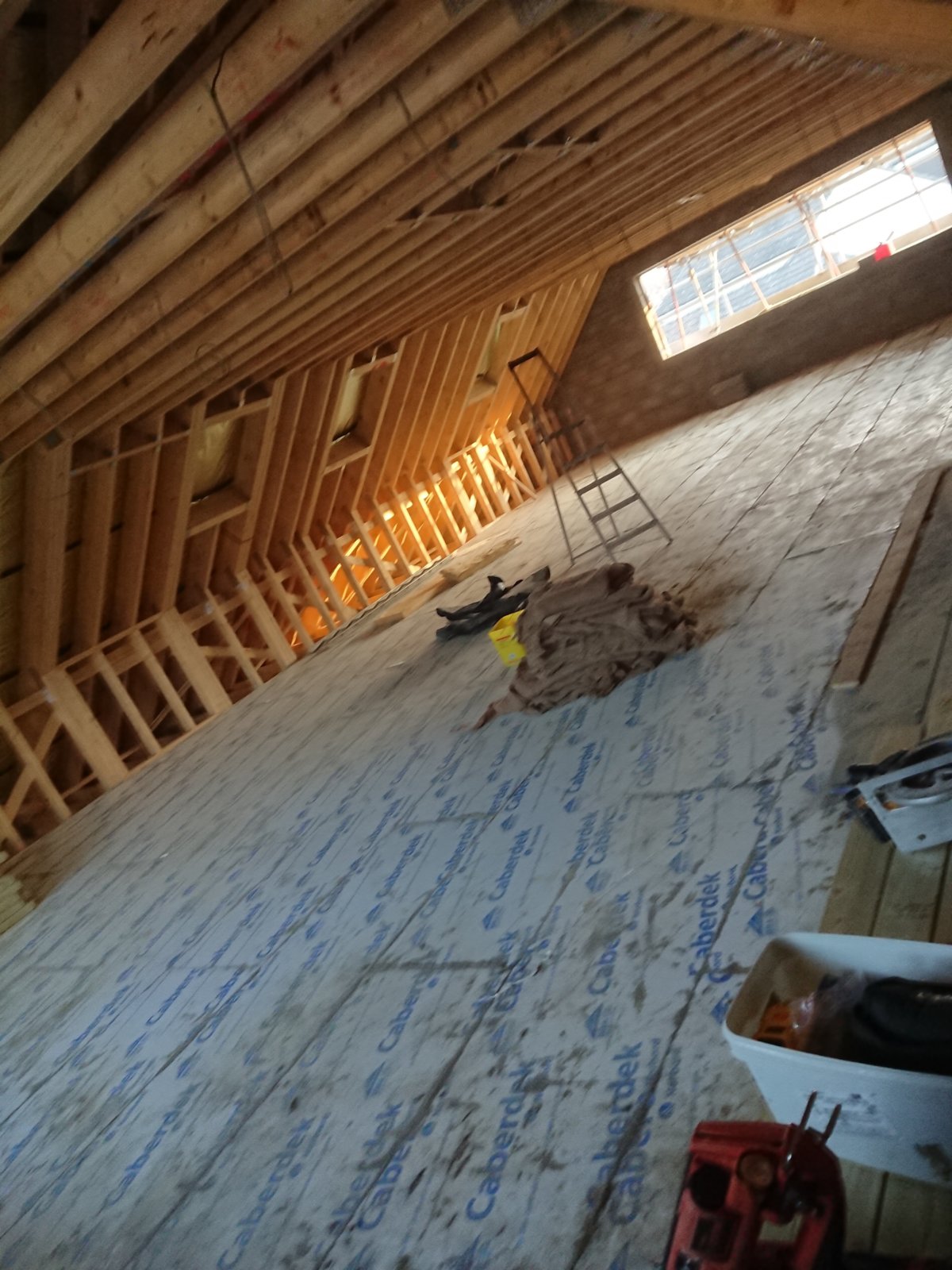

attic trusses are added to a lot of houses as a bonus when coming to sell as there is peanuts between the cost but they are left unfinnished
it can be done if they are spaced at 400cc then you could put 780 wide veluxes in no problem an ideal place will be oppisite staircase as this area will be cut
as you can see in this photo for these veluxes the t trusses cut instead of infill ignore the fact they have been doubled either side as these trusses are a 17m un supprted span so a bit more involved
you will proberly have to take the plasterboard of the whole sceiling side you want them just get somone that knows what there doing not just some general builder
