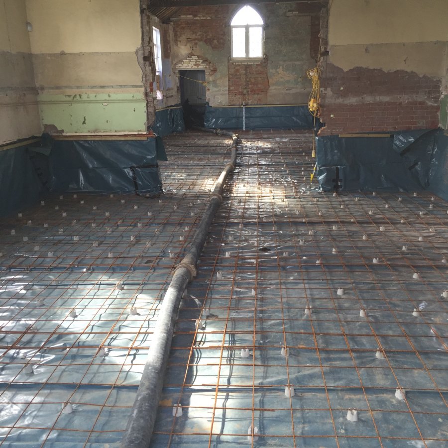

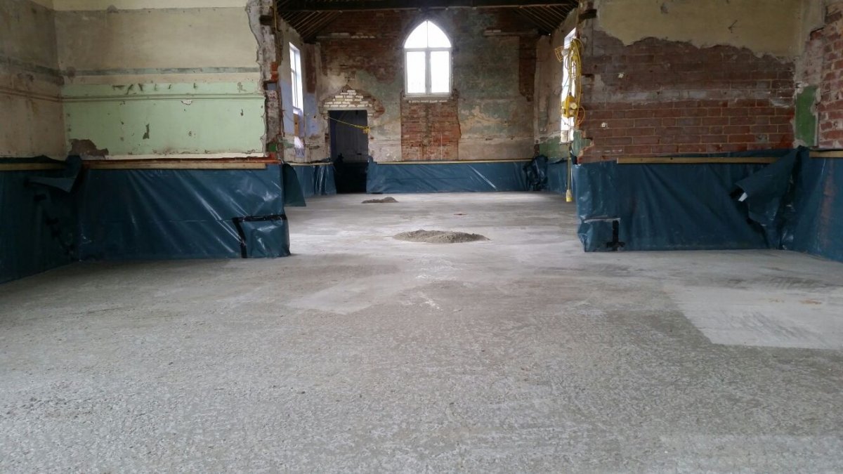

I'm refurbishing an old School Building. It has 9" solid brick walls.
We are building an inner timber 'skin' that will
A. Take the load of a mezzanine floor above (taking advantage of the height of the School), to give us a second floor.
B. Allow us to comply with Thermal Regs
C. Give us some straight walls as the existing brick walls are a bit all over the place.
The wall structure is (from outside to inside)
220mm Bricks (Imperial)
50mm Air Gap
100mm Sawn/Treated Timber (4 x 2 at 400 centres)
between the Studs 100mm Rockwool
Vapour membrane 500g or more
Celotex / Eco Therm (to meet regs)
12.5mm Plasterboard.
The floor is a poured re-inforced concrete slab. As such we will drill through the sole plate and fix to the floor (packers to ensure level) we have a double top plate as we are putting 175 x 50 (170 x 47) Floor Joists.

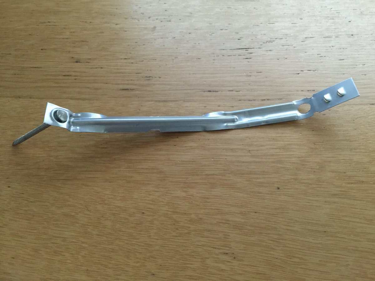

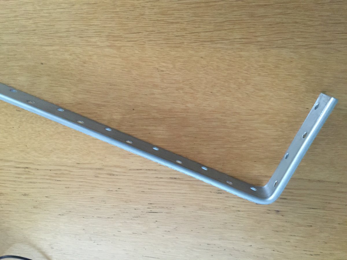

Thanks for the input. I had a search around and can't see a product specifically for this problem. However, their are a few around that can be 'pimped'.
We can use a lightweight strap
http://www.screwfix.com/p/sabrefix-roll-edge-restraint-strap-bend-500-x-100mm-5-pack/85398
And screw into brick work, then offer up to stud work at an angle, when in place, use a disc cutter to remove anything sticking out.
Or we could use a sabrefix frame tie. Again, screw into brick work and then offer upto stud work. This would not need to be cut. Ok, this one from screwfix is a tad too short, but you get the idea. This is also cheaper. Whilst it looks like it might deflect, I don't think it will.
http://www.screwfix.com/p/sabrefix-timber-frame-ties-250-pack/29339
The final option, if I am spanning a large area (which I will be doing at times), is a little bit of threaded bar resined into the wall at an angle (going downwards). In the same way you would attach a plate to the wall.
I've attached pics of the above two products.

Those straps are very OTT. Most of the material will be wasted, unless you beat up the waste into the shape you want. This is actually quite good. Using the bit with the bent right angle, you will have to drill and plug at an angle so the leg that runs towards your wood is 1/2" (?) higher on the wood side of the cavity, it will look awful but it will provide the anti drip feature. The waste you can then bend at the correct angle, a right angle but slanted across the width. If you are lucky you will be able to pick up the predrilled holes. Only reservation :- In theory the cut edges will need galvanised type paint on them to stop them rusting.

I've got ones with pre-drilled holes. We were looking at this exact solution. They are pretty cheap and darn sturdy. Installing running upwards towards inside will give anti-drip. We will be running electrical/data services in the walls. And warm/cold water services will be run in the ceilings and where necessary when bringing them down inside externally exposed walls (if we have to), I will put a vapour barrier between them and the outside to resolve condensation - oh, and insulate them. Equally, we might just run these in the floor within the celotex. But we will attempt to keep warm/cold services within the thermal envelope of the building.

For the initial DPM that is under the concrete slab, we have done this and brought it 1m up the wall. I think this might be a very good 'belt and braces' idea. If we did we would of course ensure this would come down behind (on the external wall side) of the 1m DPM that is coming up from the floor.
