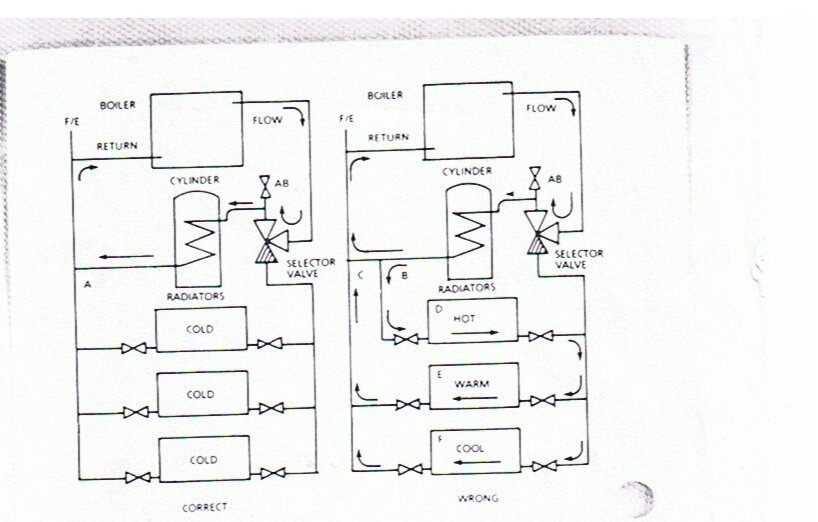

This may help clarify what goes wrong.

Should there be a minimum length of return pipe between the cylinder return T and the radiator return T to prevent reverse circulation?
I don`t know if there is a set recommended length, but if I remember rightly on my system the cylinder return is about 6ft downstream of the last radiator, and the 2 returns tee together about 300mm from the boiler
I only ask as both the radiator return and cylinder return pipes connect to the main return pipe within the ceiling void between ground and first floors. This must mean that both connections must be very close together. Is this OK?
