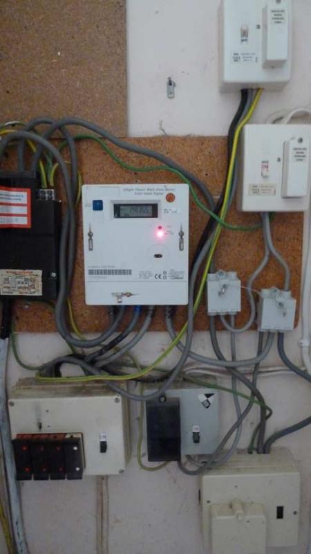

Am buying an untouched 70s property soon and have looked at the wiring behind a socket and it looks good but what should I look for when deciding whether to go for a rewire?
It has a recent meter but the fuses are the old style so it could do with a modern fuse box
Not an exhaustive list but look out for:-

You clearly have many extras. This may not be a bad thing but if you want to add RCD protection you have two routes.
New consumer unit/s
RCD's in a box which then in turn power the consumer units.
RCD's although a great safety feature also cause a lot of problems. Personally I would like to see all double pole RCD's but this is unlikely to happen.
So first job is to look at the existing installation. Since you have all fuses then likely best idea is new consumer unit/s.
Because of LABC charges likely best to get a scheme member electrician to do the work.
So assuming an electrician will do the work your problem is to decide how many RCD's.
You could use 10 RCBO's (RCB and MCB combined) or 2 RCD's or double row consumer unit with 4 RCD's.
So advantage and disadvantage of few and many RCD's.
With many RCD's less likely any one will fail without cause but if it does fail you may not notice. Also the RCBO is not as good as the best quality RCD in not tripping with the like of electric storms. Good quality like X-Pole will not trip as much as low quality so it's very much a balancing act and to say which is best is hard.
So read about RCD's and make up your mine on them, but leave rest to electrician.

I note your "buying the house" at present, commission an Electrical Installation Condition Report. Cost around £130 to £250.00 depending on house and area. You will enter the contract then with your eyes open and may well be able to use it as a negotiating tool.
If you decide to purchase without this, get some local electricians, preferably recommended.
Ask them to come and quote for a rewire. It will be free to do so unless they insist on a Electrical Installation Condition Report. Most will not and a good one will happily spend an hour with you discussing your requirements and then it will become clear.
When i get calls like yours, i happily go and chat, inspect and test a few selected positions to show and explain the reasons for my recommendations and costs. Should be no problem.
Very very unlikely a 70s house would need a rewire and I would need quite a lot of evidence to change my mind.
However - 70s houses don't have enough sockets in the right places so use the moving/redecorating time to add them. Also if you think you need them put in audio visual/alarm/network points etc etc etc.
But a rewire, very unlikely to be needed.
