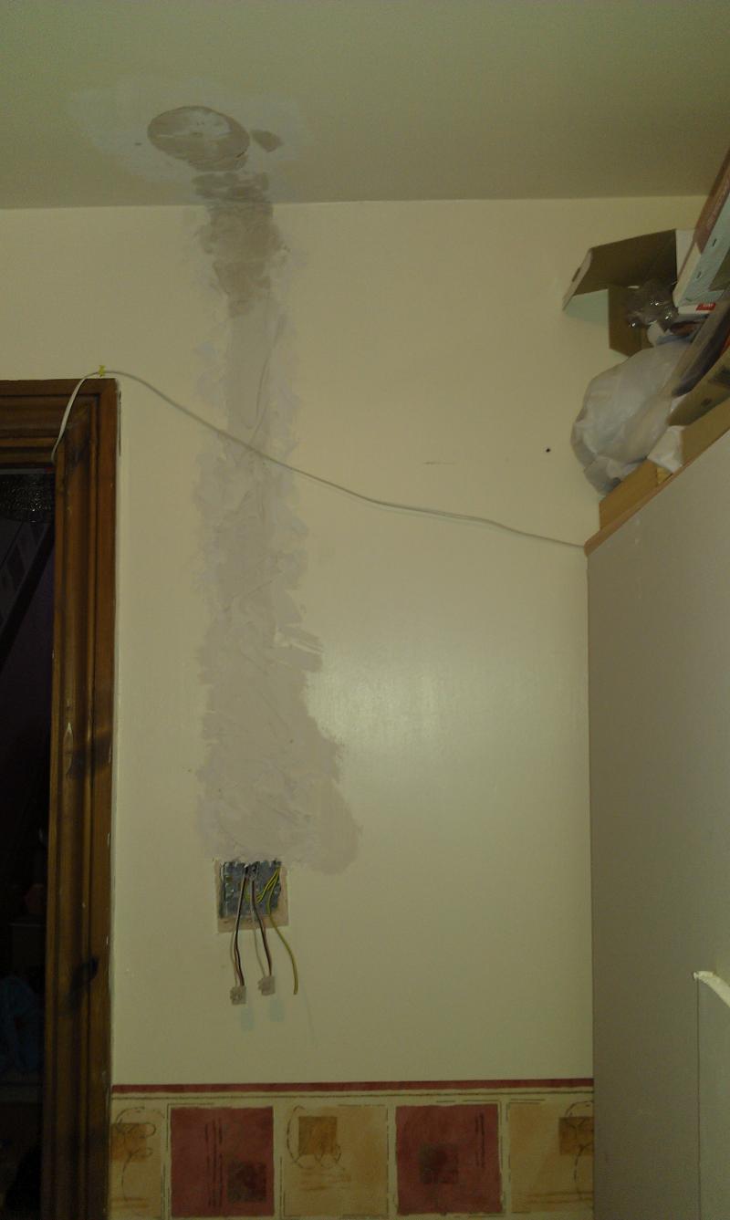

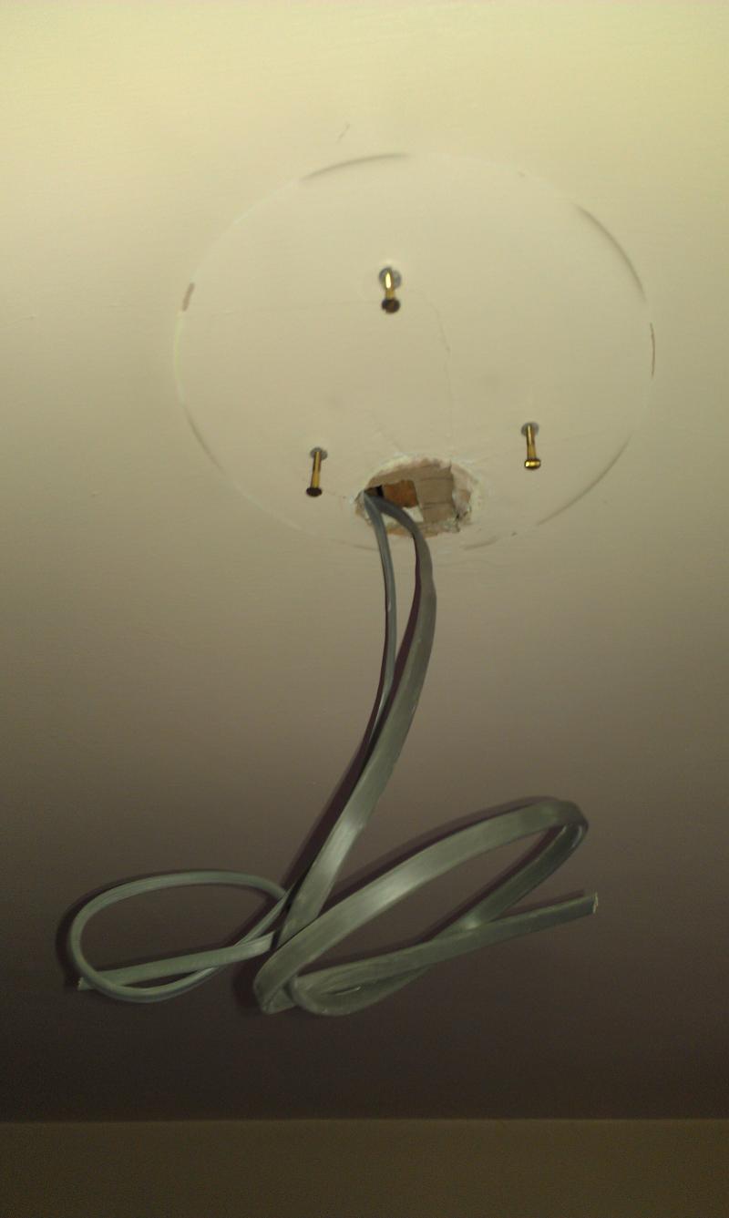

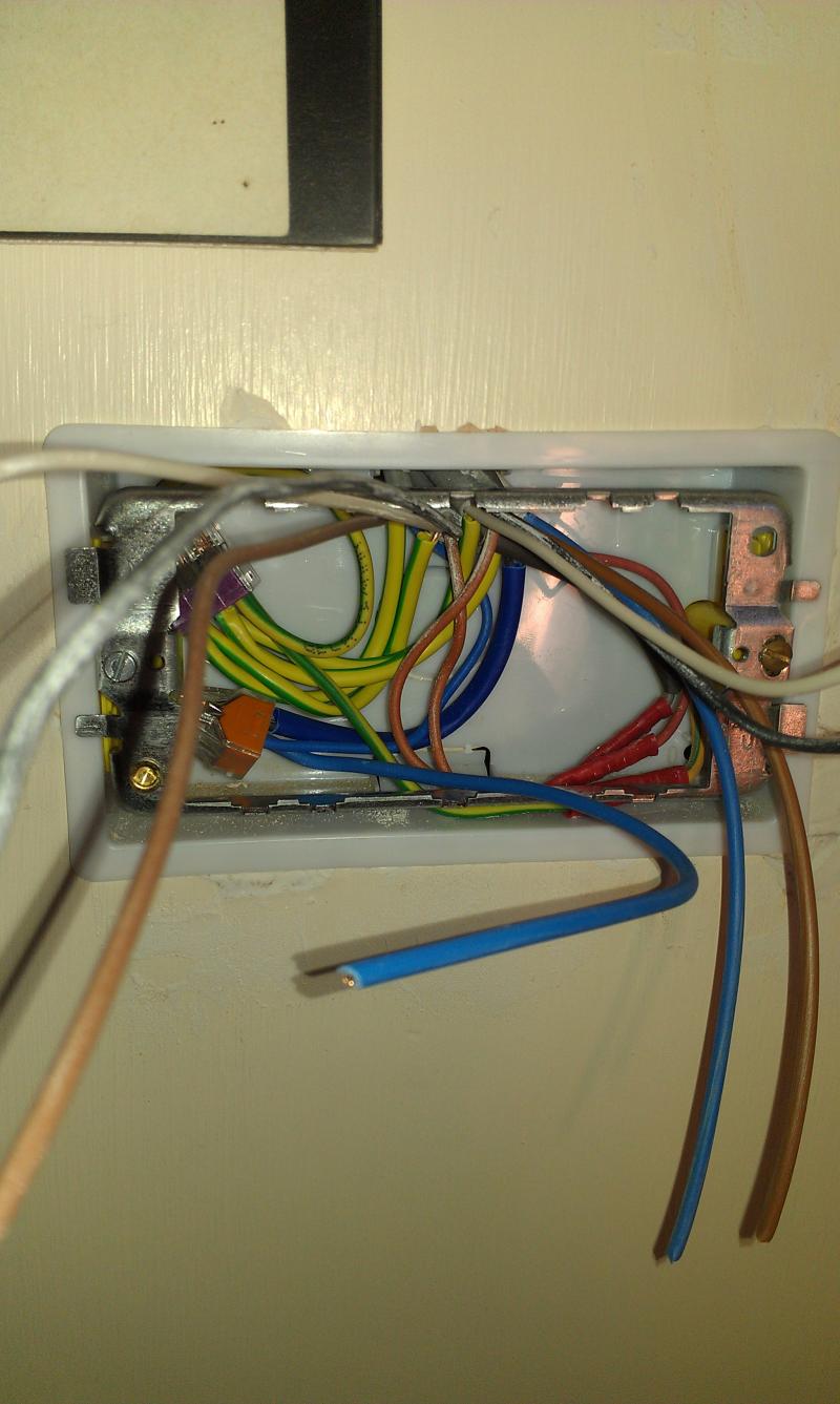

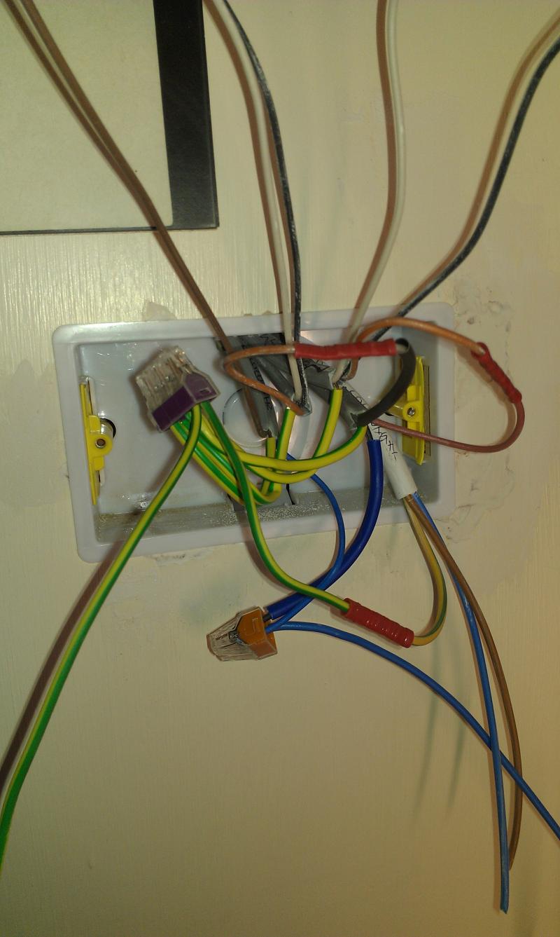

rewired hall lights as part of redoing the shower room, due to hall lights being fed from shower room lights. Also due to both hall lights only being on 1 way switching.

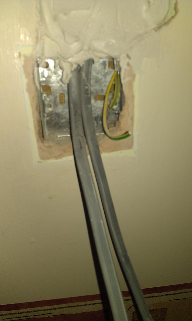

Wiring New Switch by front door

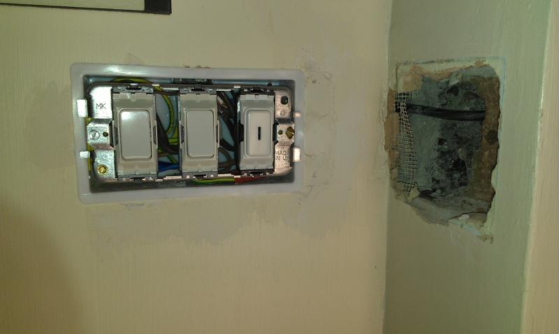

New Wiring to 2nd switch

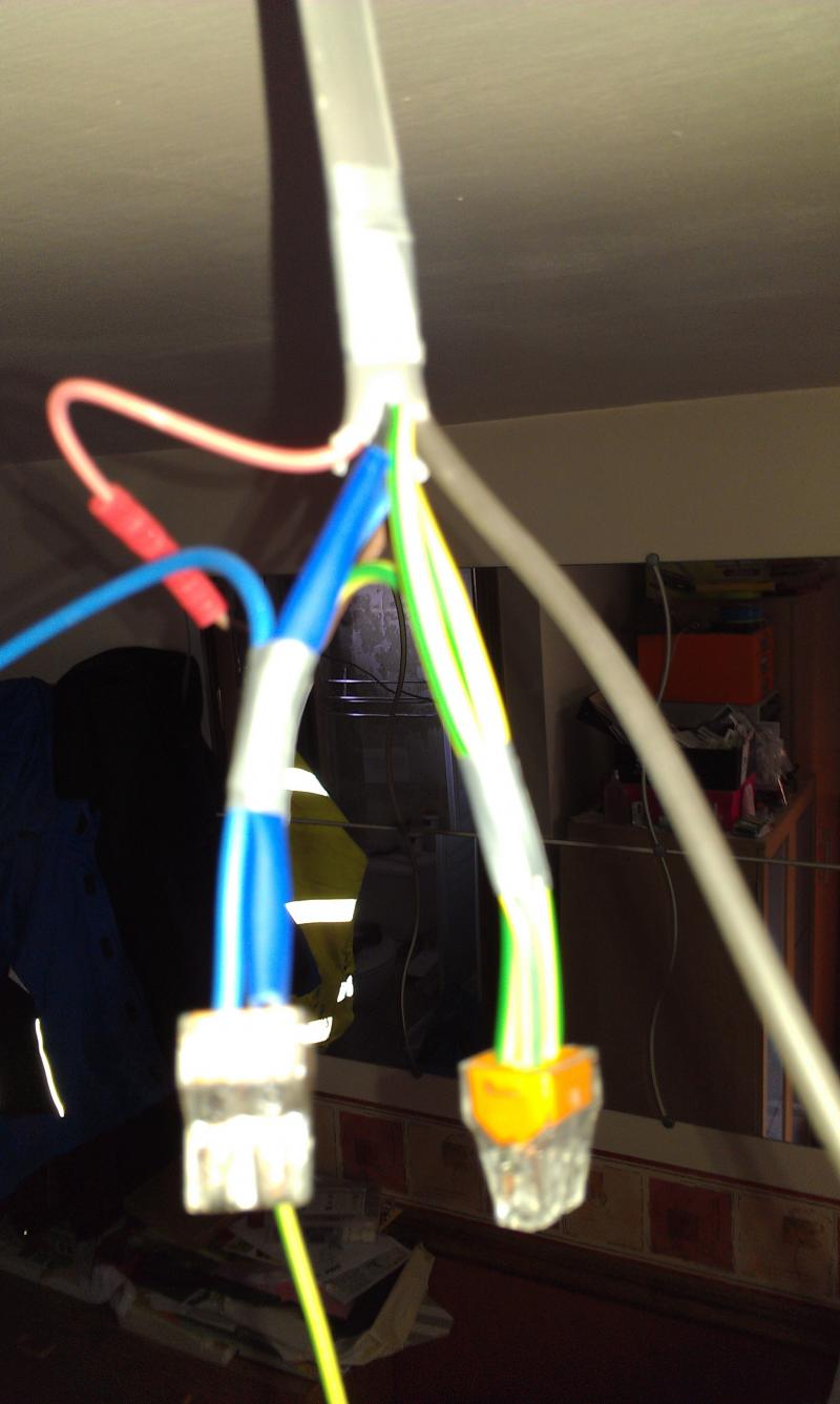

New wiring at 2nd light
Feed to switch by front door comes from shower room fan isolator
Cables at 1st switch are:
1x T+E = Feed in
1x 3 core+E = Strapper 1 to 2nd switch
1x 3 core+E = Strapper 2 to 2nd switch
1x 3 core+E = Feeds to lights
1x 1.5mm 3 core flex = Feed to outside light
Cables at 2nd switch
Why are the grey cores sleeved black? (or is it an optical illusion and they are brown?)
It's a single phase installation and should be sleeved brown!
Have you RCD protection on the circuit?
They look dark brown on my PC screen.
I take it Matthew works commercial/industrial - there looks to be a bit of that in there and in his other topic!
It is Brown Sleeving.
Yes there is RCD protection on the circuit, all four lighting circuits in the house are on RCBOs

The wagos I really dislike are the ones like the OP has used for his earths. They're just so big!
Also there's a perfectly good earth terminal on the grid yoke, so it's not actually required at all!
