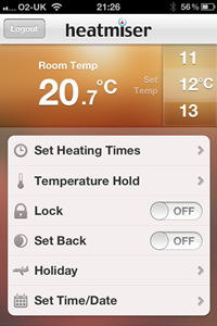

Heat mister units ar £137, google wifi stat.
That does assume you control the heating just on the stat, if its time zoned plus stat the stat remote won't do much in the timer is on an off period.
Heatmisers stat is programmable, and you can alter the timing and temp via your mobile or webpage.
Fairly easy to setup and install, but you must sink a 35mm single backbox into the wall to fit it.
I have one, and works well. I managed to get one when they were first released at a "sample" price :D
BG price is not bad at all, fitted. Wonder if that includes setting up your router taking into account the Wifi, port forwarding, and most likely a dyndns account?
Temperatures shown on the top right are a scroll wheel, scrollable with your finger.
