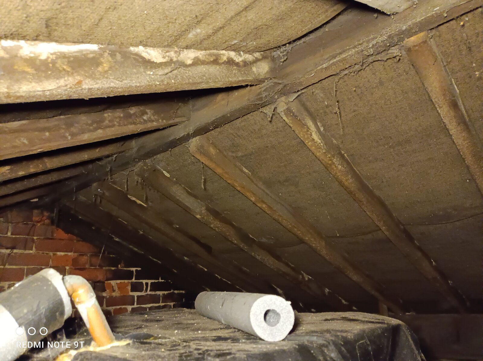

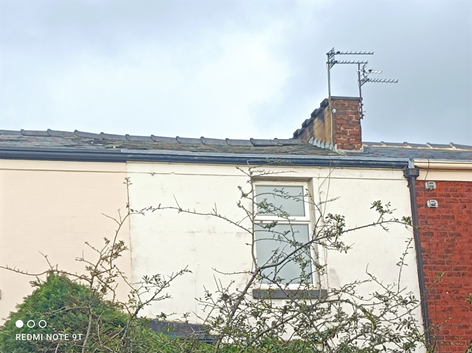

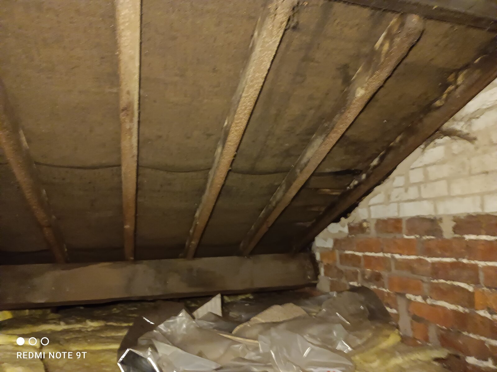

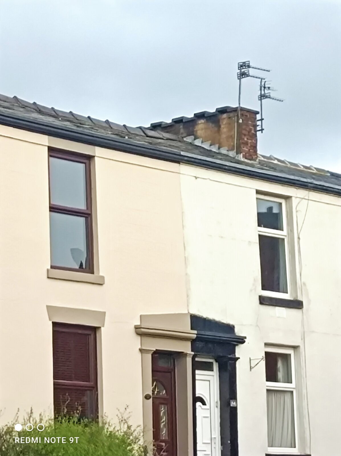

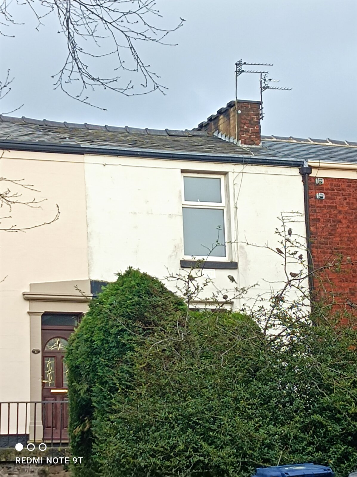

I am process of looking for a terraced house in the Preston area. I viewed a Victorian property in Higher Walton just south of Preston today (white house). I noticed that the neighbours ridge tiles seem level but on the house I viewed the tiles bow and there appears to be sagging especially towards the chimney side. I had a look inside the loft and could not see anything untoward. Should I be concerned or is it just part of a 100 year old Victorian house that creeks? If I live to be over 100 I am sure I would start to creek!

It looks like a ridge beam rather than a ridge board, so designed to take (some of) the load of the roof. Ridge boards would normally have struts to support a pair of purlins at the mid point of the rafters. You could add struts to support the ridge if there is a central wall to transfer the load. Worth pursuing with a survey if you like the house and the price can always be adjusted post offer post survey.
Looks like its been re roofed before, from the position of the rafters relative to the beam (right hand side last pic).
