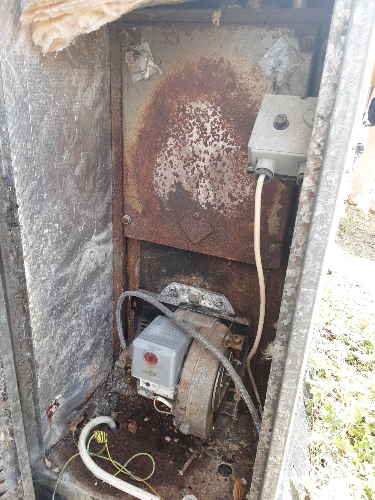

Oil tank is full, there is oil at the bleeding screw but it will not fire up. When reset button is pressed noises are made but no firing. The blast tube is dry after reset. Plate over fan is always open, should it be? Fan moves freely. The burner is a Riello 40. What could the problem be? Thanks in advance

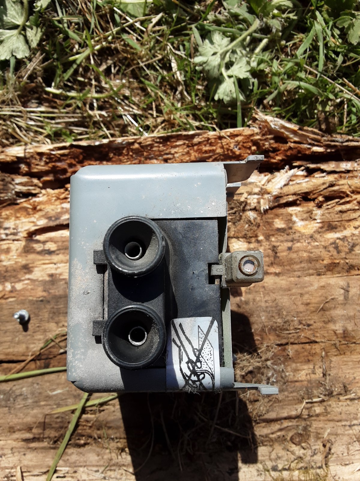

Blast tube dry means no oil from nozzle. If house has been empty, or run on solid fuel, nozzle line may be clogged up, check oil pressure from pump and work forward. Solenoid valve may be faulty. A faulty photocell can keep burner in prepurge. Remove photocell from control boxand see if burner fires, if so then replace photocell.

A picture of the burner would enable better reply.

Please see attached photos.

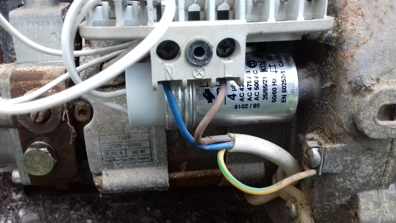

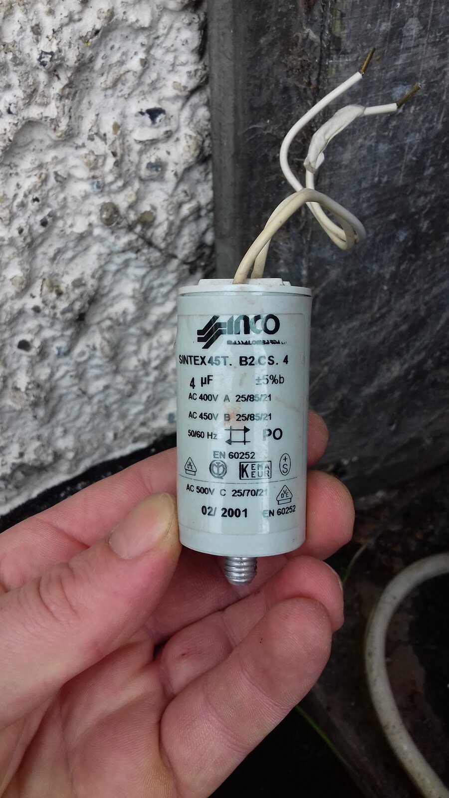

Check motor capacitor and if ok check oil pump is not too tight .
Or loosen oil pump and see if motor spins.
Preferably Both.
As Terry says. This burner has a fully closing air damper, but it may have been disconnected and the plate fixed. The hydraulic rams often leaked and later models dispensed with this. After standing for over a year, I would suggest that you get a technician to give it the (more than) once over.
A really well kept old boy but can be sorted as terry says check the capacitor
if no good change it then if it’s all spinning check oil flow should be more than a dribble may need blowing out when flow is established check oil pressure should be 5 bar washing pressure then jump up to working pressure
which is proberbly about 115psi I think oilhead will maybe know as I haven’t got my work book with me. Good luck. Bob
Try flicking the fan when the burner motor buzzes. If capacitor, then it will probably spin.

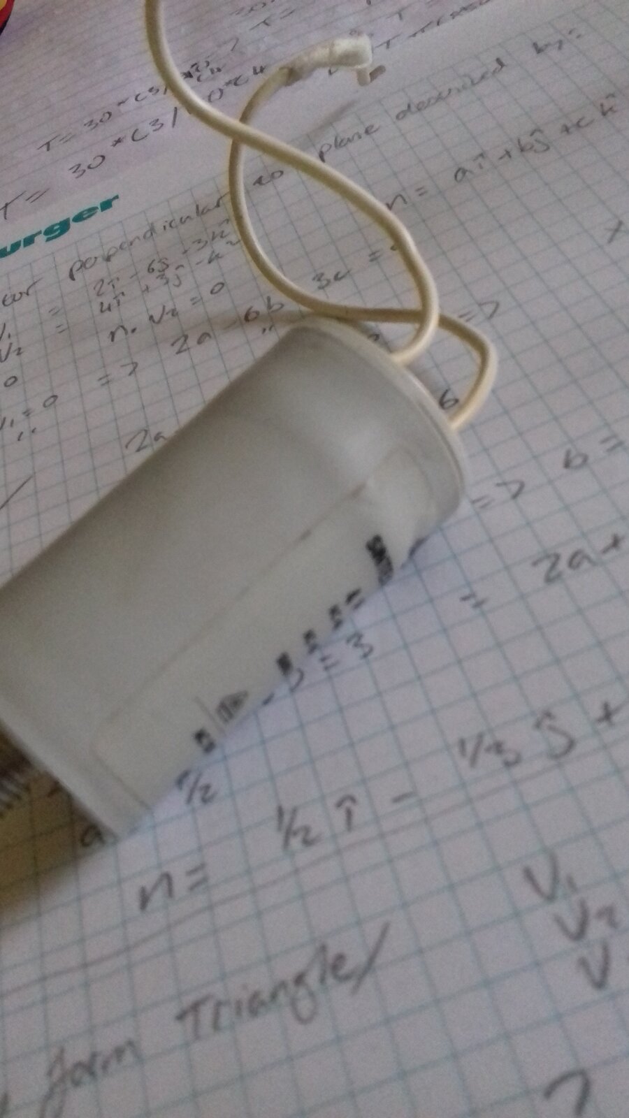

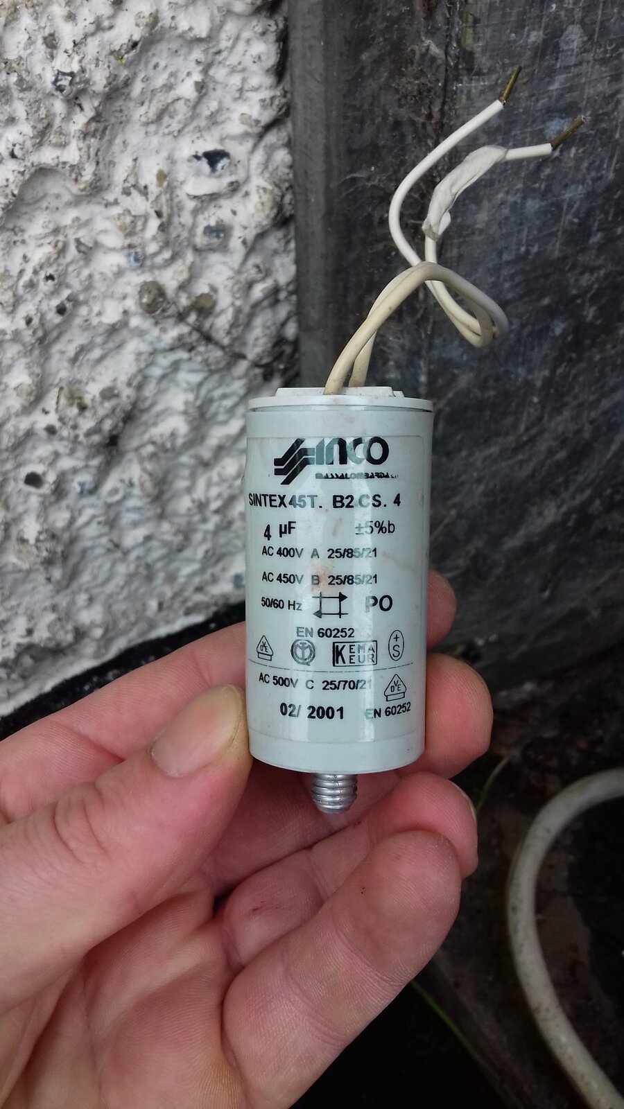

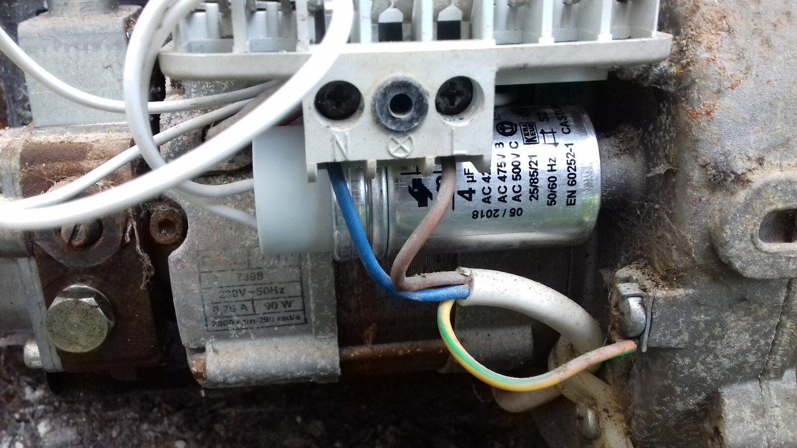

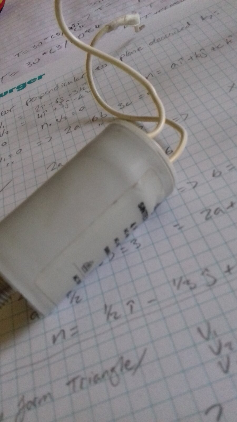

I removed capacitor and replaced it as it had a date of 02/2001 on it and a noticeable bulge towards the top.

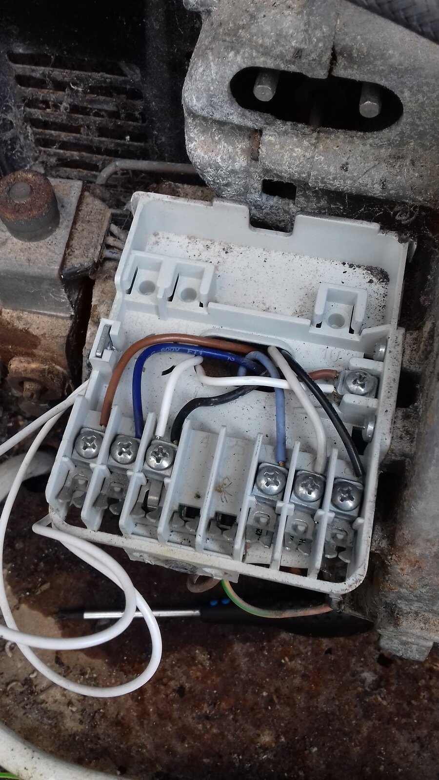

Now it seems I have no power at all at the burner, no red light or noise of any kind.
Is this a safety feature or did I dislodge something important?

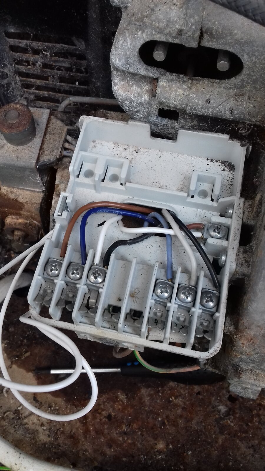

Check the wiring in the control box base, and any fuse. You may have shorted something.
Thanks for the reply oilhead.
I will check tomorrow as daylight now gone.
I'm pretty sure all the wires remained in place as I just removed the two for the capacitor.
Do you see anything out of place in the uploaded picture of control box base?
Wiring colours are fine.
do you not have a wiring guide in control box.
