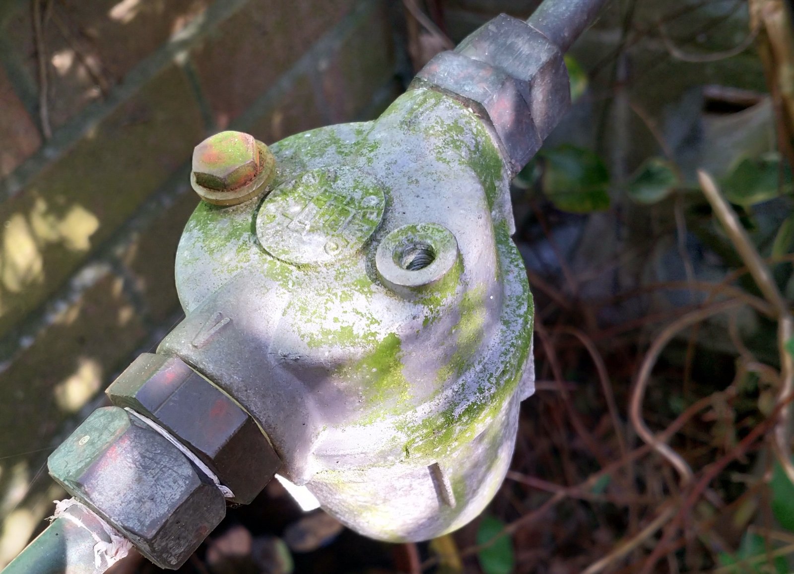

Trying to fire a boiler that's been unused for a year. Pump has the usual hex extension with allen head bleed screw. The bleed process seemed to go OK but took a lot of attempts as the pump only seems to run for 5 seconds before locking out. But I eventually got a decent stream of fuel & the boiler ran for a few minutes before it locked out again. Trying to bleed again there is very little air & no fuel, so I guess I either have a major air lock or a blockage.
There is a filter at the tank outlet (pic attached hopefully) but unsure how this opens? There appears to be a missing bolt on top which further reading suggests may be for bleeding the filter after maintenance. There is only a gate valve on the tank outlet to the filter, nothing the other side.
Any advice on how best to proceed please? Is it feasible to try to draw fuel through the pump with the bleed screw removed?

Bottom part simply unscrews.
Turn off gate valve, unscrew filter casing, slowly turn on gate valve with receptical underneath to see if there is a flow from the tank to start with.
You will need a replacement gasket and filter when reassembling. Might be easier, and just as cheap, to replace entire filter.

Can you please ID the filter &/or recommend a replacement? Is the missing screw significant?

Looks like a W4 WASP & the "missing" screw is absent on a new one!

So, as no one like a thread with no conclusion, here's the end to this one.
Removed the filter bowl (which was full of crud) turned on the gate valve & nothing. Turns out the tank is empty! It's an old metal job that from rough calcs is around 900l. There's a clear viewing tube rising after the gate valve which shows the tank level. This was showing approx half full. Then I discovered the push button that actually allows flow in/out of the tube. Doh!
