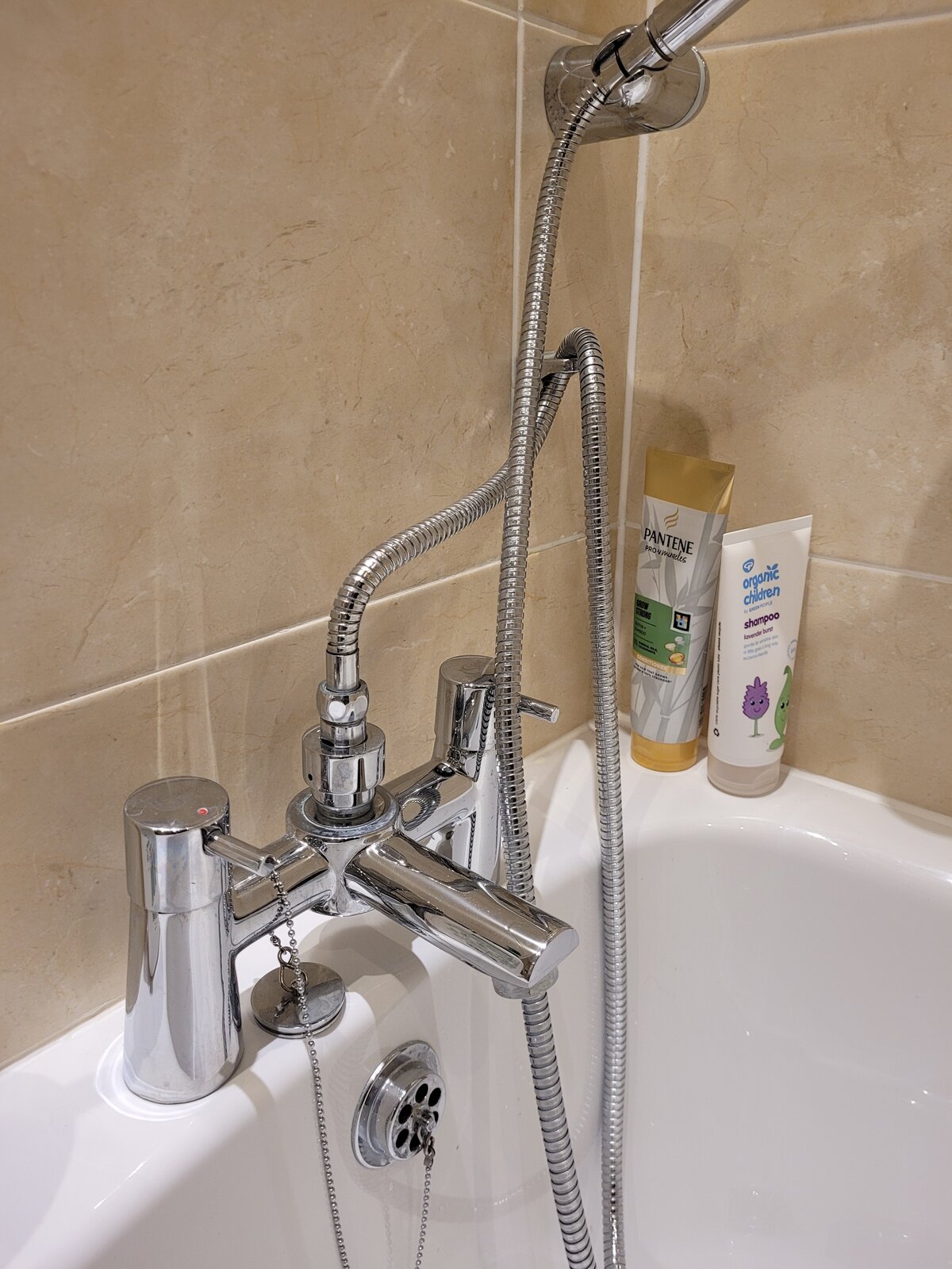

in the house I just moved in I have a combi boiler Ideal Logic ES35 (flow rate at 35C temp rise 14.5 l/min and specific rate of 16.9 l/min).
Water coming out of the upstairs bath shower mixer (attached) is *very* slow, to the point that I can't really have a shower or even wash the foam after a bath.
Any spec I should look out for if I wanted to change the bath shower mixer tap to have a better shower? I was looking at buying the following
but I am being told by the builder I am using for renovation elsewhere in the house that I should get something that has less knees that the water needs to go through and instead has a direct connection from the tap to the shower. Something similar to this, designed for low pressure systems
I am not sure at this stage if the limiting factor is the boiler and its flow rate or simply the type of tap. I wouldn't want to invest time and money to install a new bath shower mixer (with all the effort involved in installing and un-installing with the bath tub still present) to then still found the pressure on the shower is too low.
Note that the shower in the en-suite (other room from where the issue in question occurs) has good pressure (I wouldn't call it high but certainly not as bad as the shower in question).
