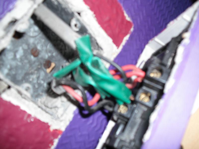

Ok here is the socket that the spur was taken from.
I did not spur from this socket, i added sockets in between the socket spurred from this and a socket spurred from that socket. This is the socket that the new connection will be in so i assumed this is the socket you wanted a photo of.
sparkyspike:
thanks!
I hoped i could do it i just wasn't sure of the regulations about this kind of thing. i will take one wire from the existing ring out of the socket to connect to the end of the spur chain. this will not make any figure of 8's (i think :p)

You're right to fully extend the ring, although fitting an fcu is perfectly acceptable.
To verify whether you have a ring, or a spur-off-a-spur, do the following:
Work out which socket you want to extend the ring from. Turn off the power, check the socket is dead and remove the front. Work out which cable is the 'spur' cable and pull it to one side. Seperate the remaining 6 conductors. Set your multimeter to 'continuity' or low ohms. Measure between the two live cables first. Then between the two neutral cables. The figure should be almost exactly the same as the conductors will be pretty much the same length. A reading of, say, 0.5Ω would be normal and would indicate a complete ring. Do the same between the two protective conductors. The result should be a bit higher - say 0.8Ω. If none of the conductors show low ohms, then you don't have a complete ring. If only one or two are, then you have a broken or loose connection somewhere which needs investigating.
This is how you verify a ring. It isn't a complete test as it does not measure the earth loop or insulation resistance, but it is a quick way to check that you are not extending a radial circuit or spur.
Your new ring must not service a floor area greater than 100m² in total.
Your new ring must be wired so that one of the cables on the ring circuit is connected directly to your 'spur' cable. Do this with crimps or terminal blocks. At the end of the line of spurred sockets, take a new cable out of the last socket and join directly into the socket which is on the ring. Finally, connect the last cable (originally in the ring socket) back into the socket. You'll end up with two cables joined together and two in the socket itself.
To fully test this circuit involves going inside the consumer unit and also involves using a professional installation tester, so this is best left to an electrician.

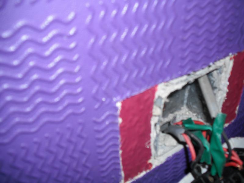

ban-all-sheds:
i have to admit this is my bedroom and i did indeed do the decorating.
The wallpaper under the socket is actually the old wallpaper that didn't even get stripped off never mind repainted.
I did get my comeuppance yesterday trying to pull it off the wall.
Stuck like glue.
