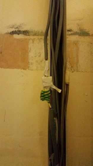

i took the board cover off the main board just to see if i could see anything loose.
the neutral bar had 2 terminations, so i took the main conduit off above the board....
and found that the 2 wires feeding that breaker - 1 of which had a double choc box / tape joint!!! (see pic) and this was done by an electrician!
so i will try replacing that joint and see if that helps!
thanks i would never have looked behind there as id assumed the work was done properly!

So ive traced out the neutrals on bar 6 (the socket Breaker) they led to the crap joint. i repaired that. still tripped
