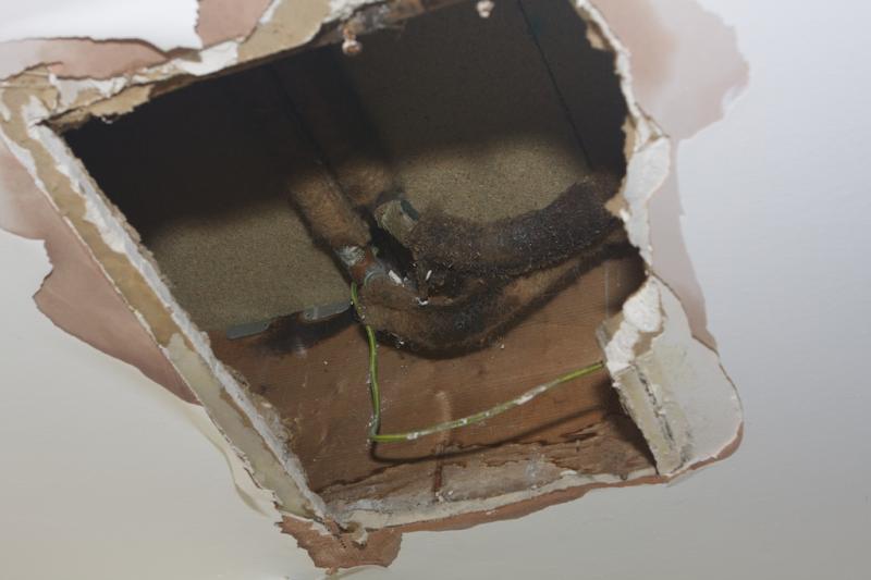

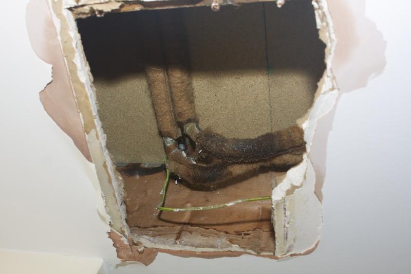

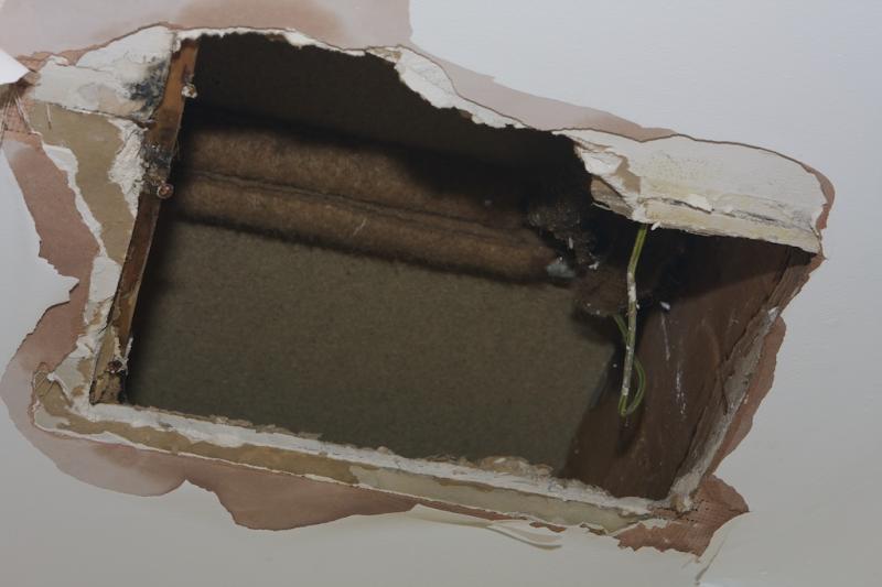

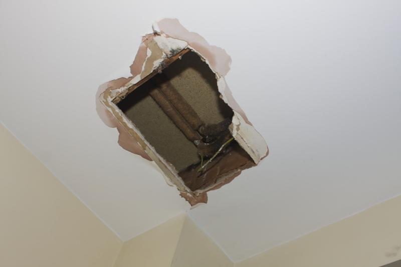

Just took a picture of the hole I've made to find the source of the leak in case it helps with tips on how to repair the hole.
The leak is from a pipe join which hasn't been clipped to the joists so likely was disturbed from above during the bathroom refit.
I'll get a plumber to sort the leak and then leave the hole open till spring to help the joists dry out.
Looking at the position of the joists I'm thinking it should be possible to screw in a piece of 9mm plasterboard and get a spread in to skim it and blend it with the surround before i finish it with eggshell
Any half decent Prop Maint Man will do the lot for less than a ton.
Sorry - misread post to read ceiling was artex finish.
You'll be fine patching and making good joint
