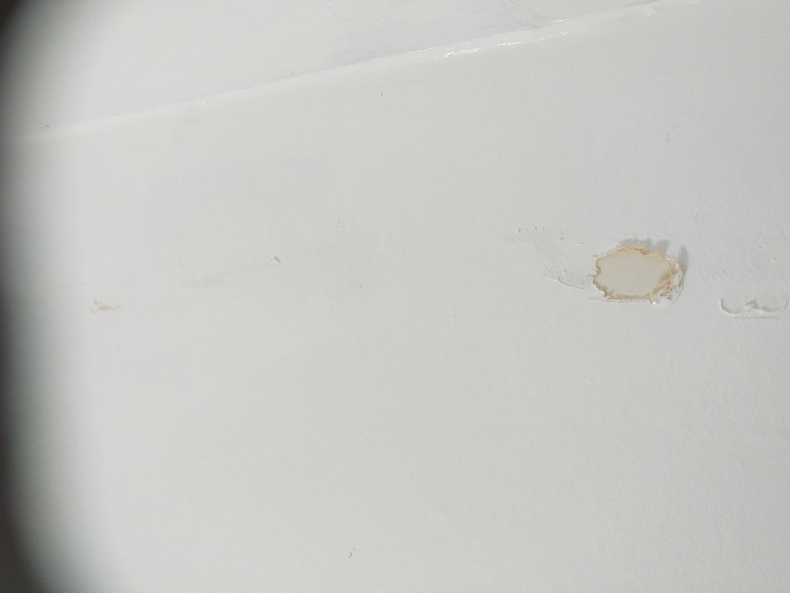

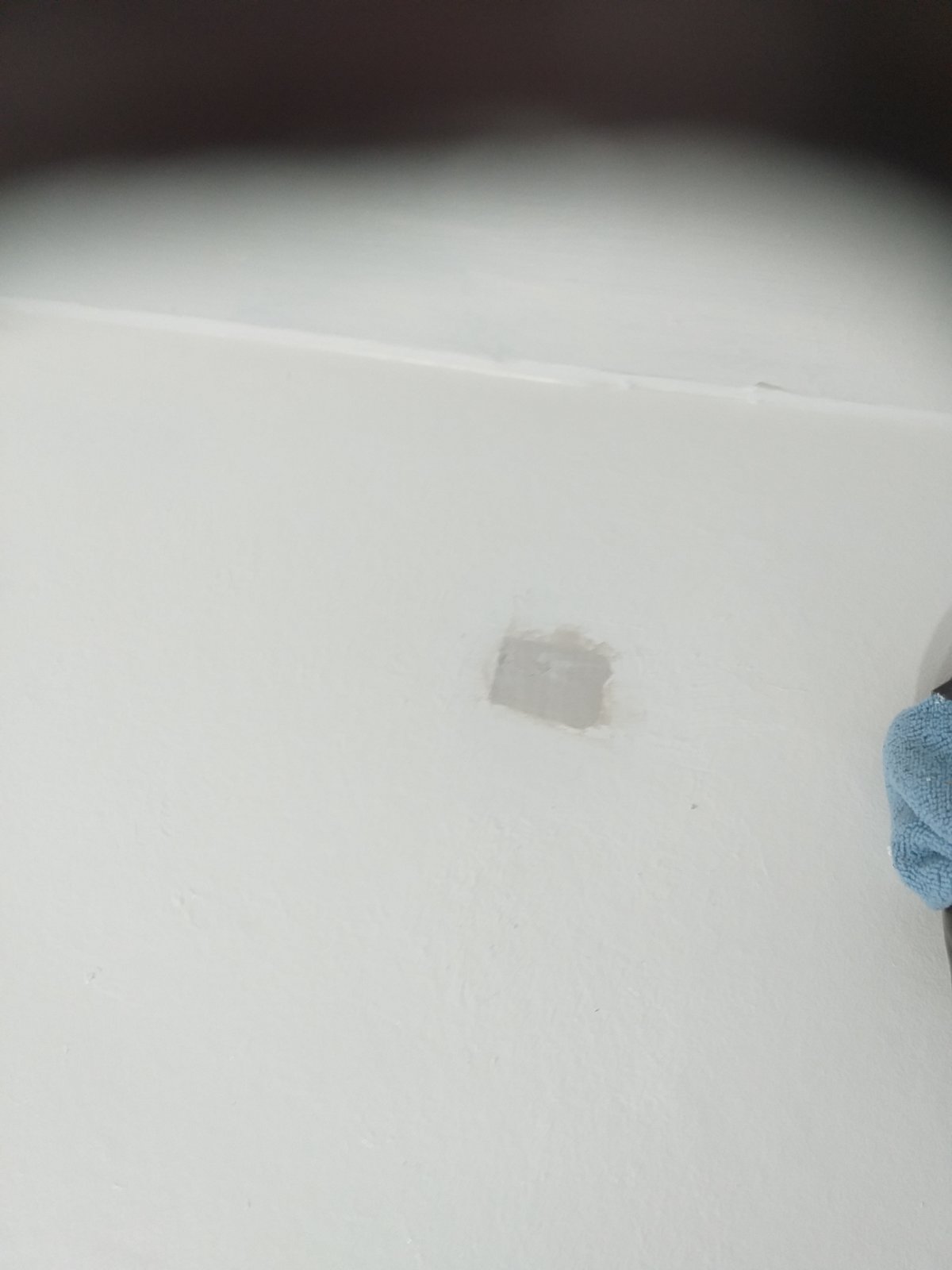

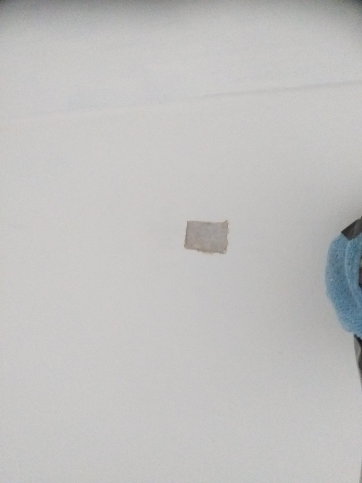

I cut the lining paper back to plaster then filled with polyfilla (middle pix). Shall i put pva over plaster before painting or just paint it? I bought some cheap wood pva for £1, what percentage to water would I mix the pva?
if you're going to put a patch of paper over that, go around the edge tearing every bit of it to produce a rough edge and not a sharp one - it may just blend in better.

I might just paint over it. After sanding the lining paper around edges of filler. I was going to put some lining paper over hole but after filling it the lining paper would be too thick I guess
The middle picture is how it looks now

Just paint over the filler.
If it were a large area I would recommending thinning the paint with water first to deal with any suction issues but it is so small that you can use full fat paint. You may need two or more coats depending on the filler and paint.

Put a square of lining paper over the hole, with a very sharp knife double cut it, patch done, jobs a good 'un basic stuff if I may say.
That would work if the filler had been sanded flat to the plaster but in this case it looks like it has been sanded flat to the surrounding paper.
