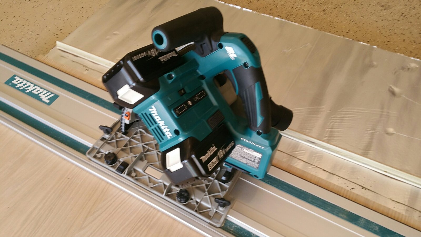

Borrowed a TS55. Amazing bit of kit. Had to flip over the wood to cut from both sides as it didn't go deep enought but good enough finish since cut side is going against the wall.
Now contemplating buying it over the DSS610 which I was saving for.

Yup I was originally just going to get a cordless makita circular saw and look at some sort of rail for it. I've got a makita drill/driver, impact driver, jigsaw, and orbital sander. I was going to buy an SDS drill and a saw too.
The plunge saw esp with the rail seemed very easy to use. It took me longer to set things up and pack away than to do the cuts using the plunge saw. But it didn't cut deep enough.

The TS55 (and SP6000 and DSP600, etc, etc) is a plunge/rails saw designed specifically for breaking down sheet or sheet-like materials (e.g trimming bottoms off doors, etc). Without the rail a TS55 is really a pretty useless piece of kit TBH (I've had one with the rip fence for years) - and the rail generally limits you to cutting materials 250mm or so wide or wider unless you can fix (nail, screws) your material down to a bench, not to mention it is underpowered for heavy ripping. Rather than the DSS610, a DHS680 (brushless) would be a far better choice as a pure rip saw - and taking a 5mm or 10mm rip off a 2 x 2 CLS is no problem for it. If I had the choice of only one saw for general joinery out of those I'd have the DHS680. As someone else said, completely different beasts
