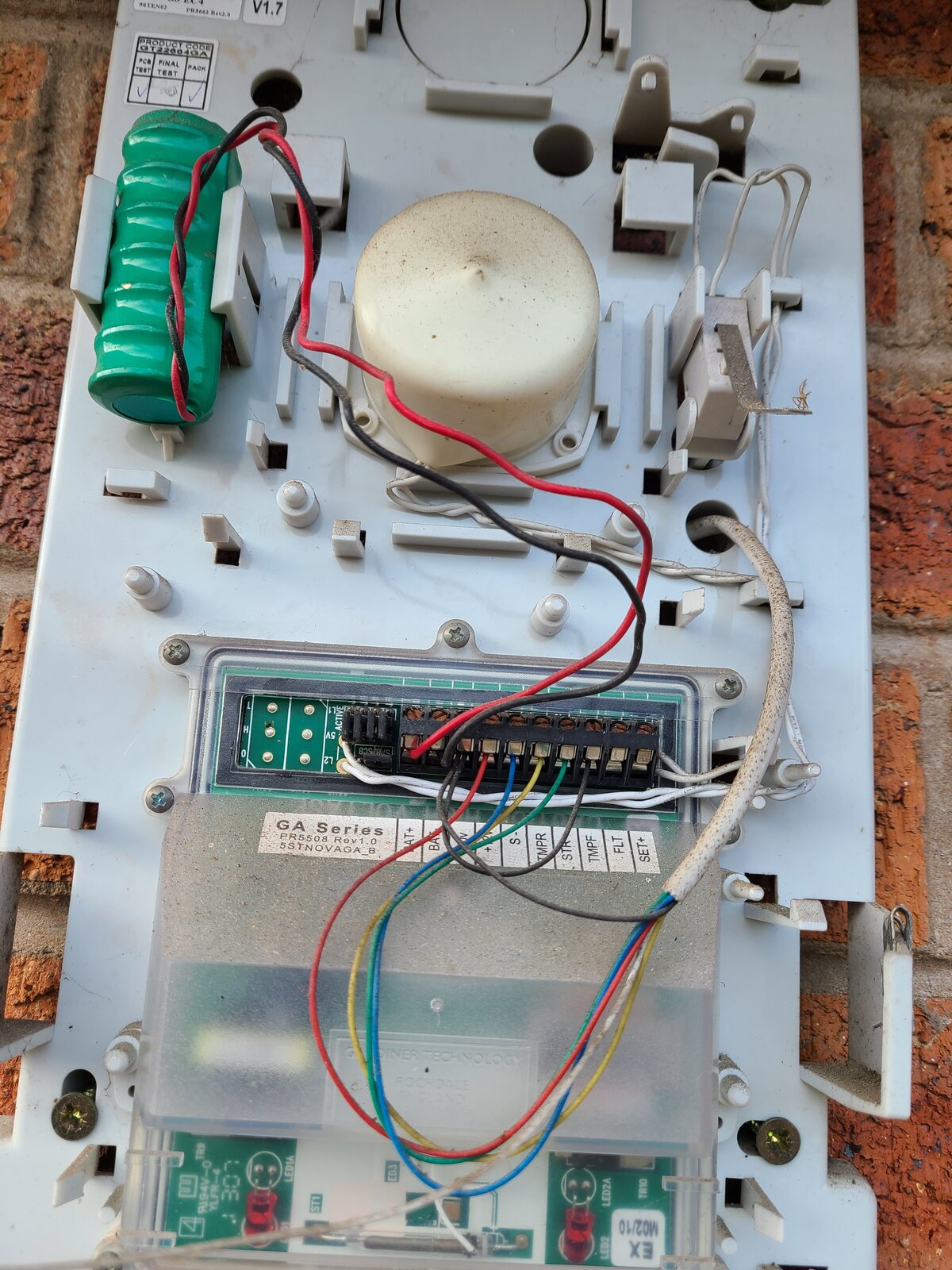

Anyone know how to put a Risco Nova 2 bell-box into hold-off mode? It's connected to a Texecom 64w panel.
Wanting to replace the internal battery and a bit of a cleanup. Also possibly change mode to SCB as maybe adding a 2nd Texecom bell-box.
Below is a pic from when the cover was last off but can't remember how I put it into hold off.
It will disable the bell tamper on the panel, but the bell will still sound when u take the lid off
I guess I'll just have to tape down the bell tamper switch when lid comes off.
2 red wires in the bell will do, put new battery in, reconnect red 12v, close lid
