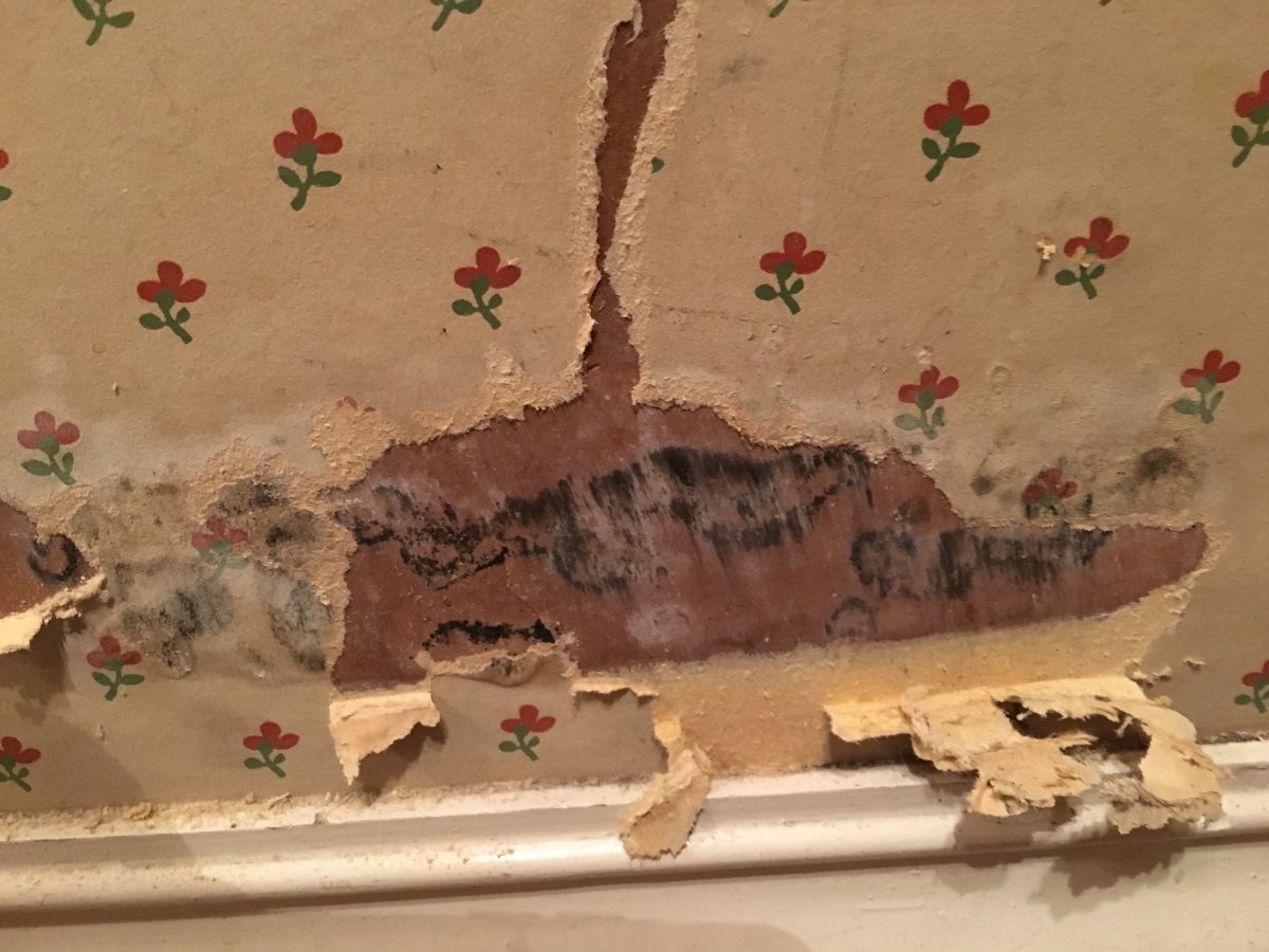

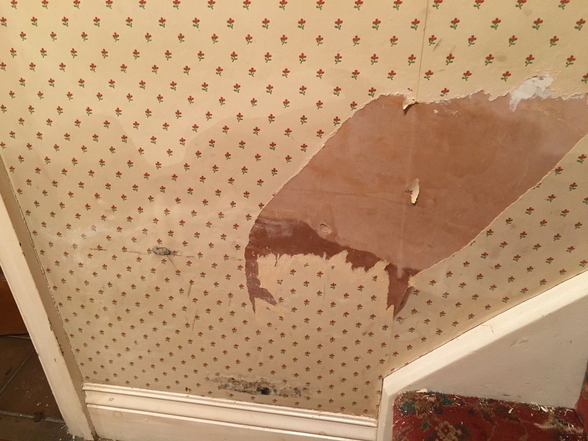

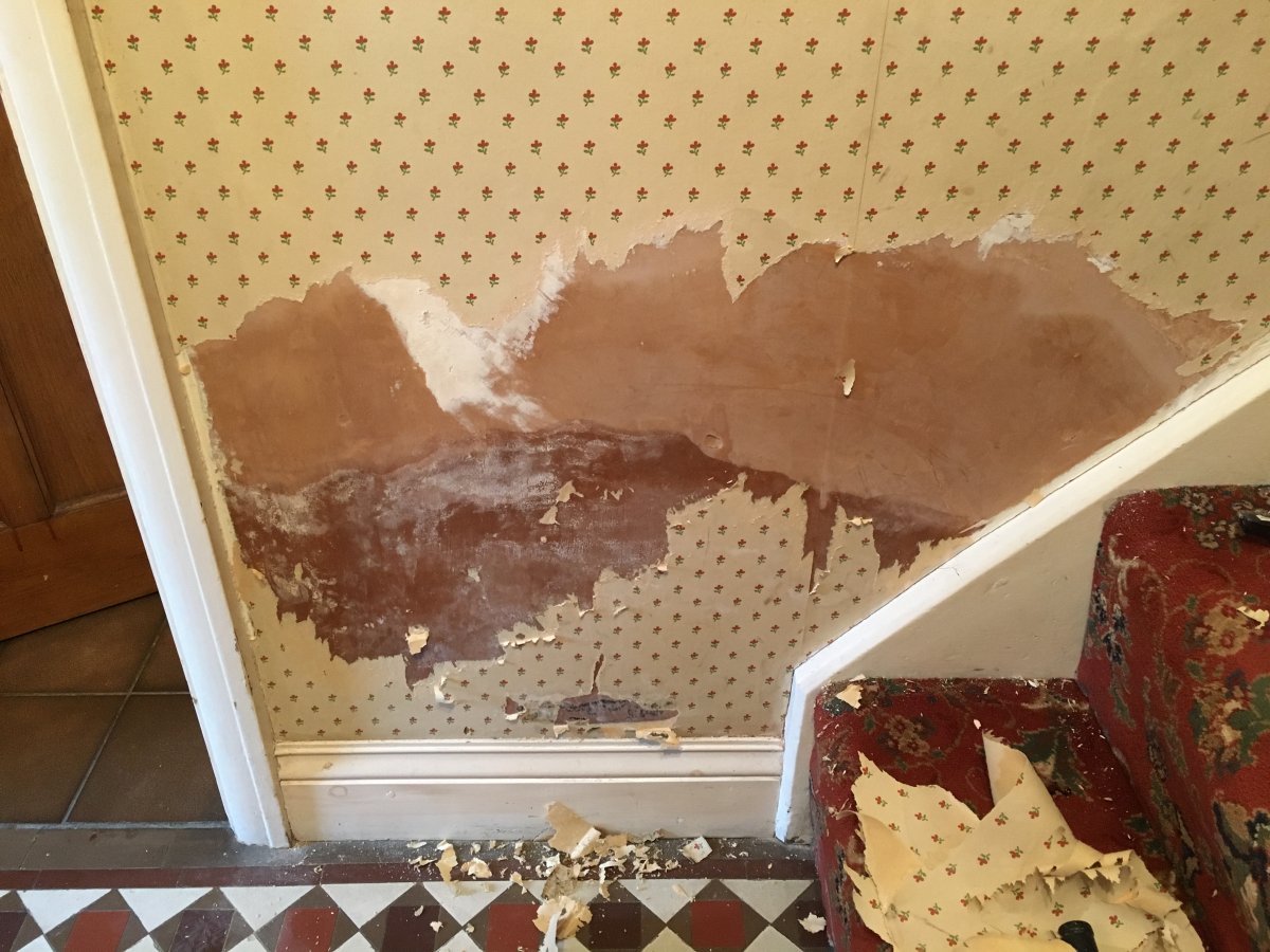

So the saga with the project house continues.
Some of the existing internal walls have a small amount of damp in them but this wall is the most notable.. it appears to have been replastered at some point too. (All images are the same wall).
Would the internal walls have had a natural slate damp course as the outer walls do?
I am guessing it'll be an damp proof injection job and replaster?

If the outer walls have a slate DPC so should the inner walls. But there's no guarantee until you go under the floor and look at both sides of the wall in the sub-area. Could that wall have ever been an outside wall before some kind of house extension?
What's the condition of the plaster on the other side of the wall? Do you have pics?
You will need to hack off the plaster back to bare brick to a height of about 1200mm - 1000mm. First remove all the wallpaper & the skirtings - examine the back of the skirtings.
Wherever in the house that you see damp signs then the plaster has to come off. If you have damp on internal walls then its often the case that there's damp on external walls.
Where walls are damp then joists are at risk.
Do you have ample air bricks and through ventilation?
The best remedial render mix is 3:1 sand & cement with a remedial skim.

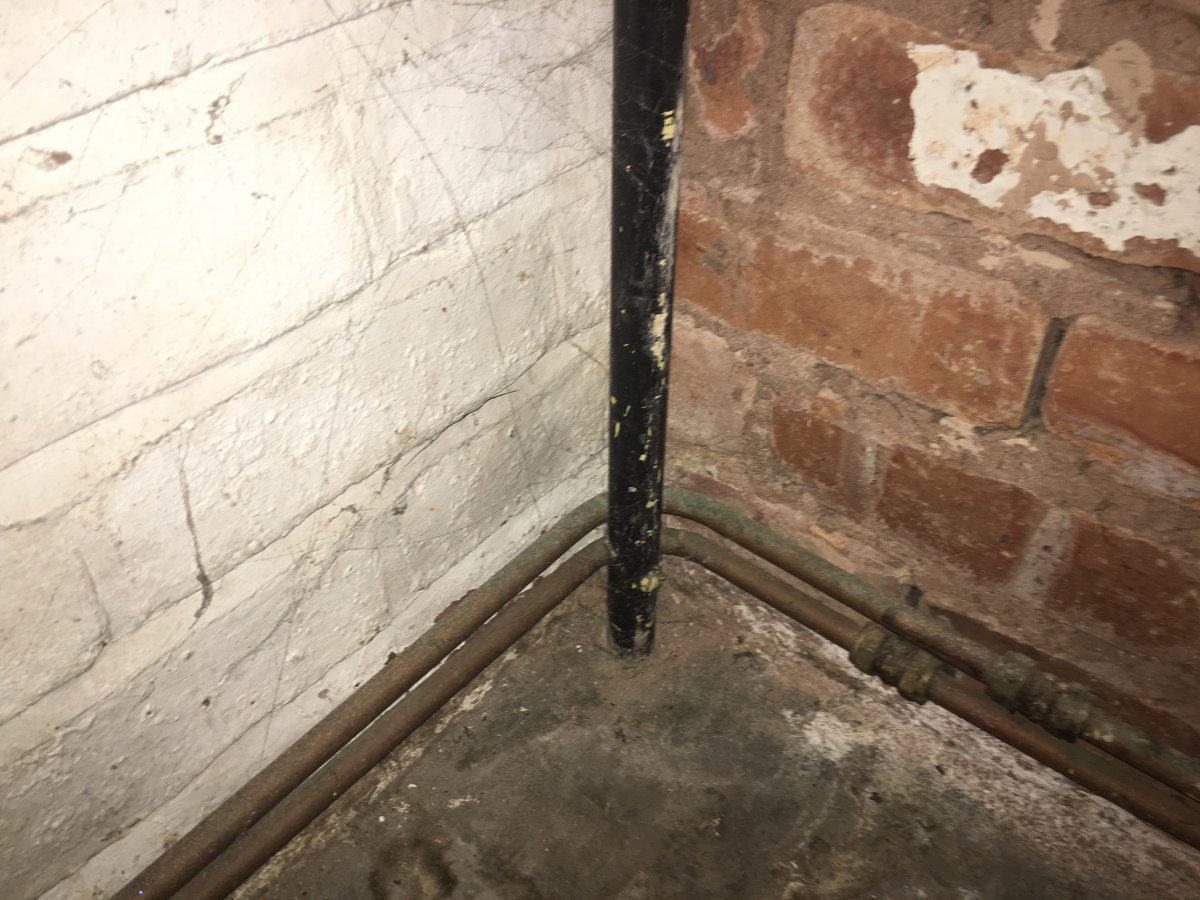

Is the white wall abutting up to the stair flight wall an outer wall? A pic of the outside elevation might help?
There's no sign of a membrane (DPM) at the edges of the floor?
I thought that the room on the other side was a furnished room with flooring?
Is the internal wall a 9" wall or an 11" wall?
What is the black pipe?

Yes the white wall is the other side of the stair flight. This used to be an outside wall until the 80s at which there was extension added so this is now an interior wall.
The extension does have a visible DPM.
The whole property is solid brick construction (bar the newer extension).

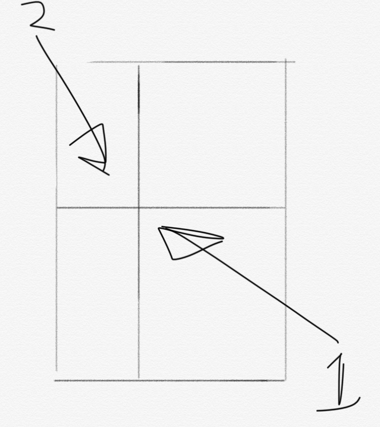

Number 1 is the hall quadrant with the stairwell in the top right.
Number 2 is now the utility where there is a solid floor construction, with a downstairs toilet below this in the bottom left quadrant, again appears to be solid throughout.
There is another room with a suspended floor and an area of damp and we spoke about this at the start (the one I need to get the floorboards up in)

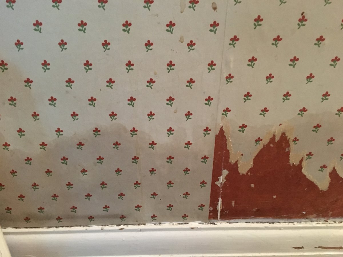

The patch pictured appears to be drying out and was only noticed when we were using a wallpaper steamer in the hallway, creating a lot of moisture in that area. I did however notice some black staining :-/

You have damp in the wall & its not due to the steamer.
Why it shows on one side only is possibly due to the painted wall surface blocking any "exit" for the damp, & the damp then finding it easier to exit through the warmer staircase side.
Going under the floor might give more indications of whats happening.
