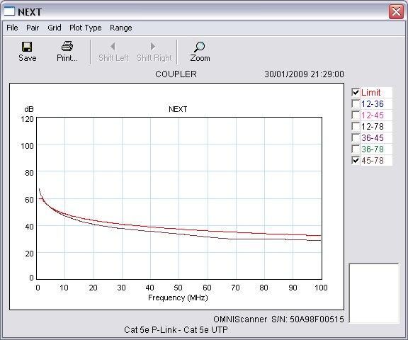

I checked all of the obvious things, network card drivers speed / duplex mismatch and came up with nothing, so I put the cable certifier on and low and behold it failed the crosstalk test (NEXT) On testing the link speed it was averaging at around 17Mbps :eek:

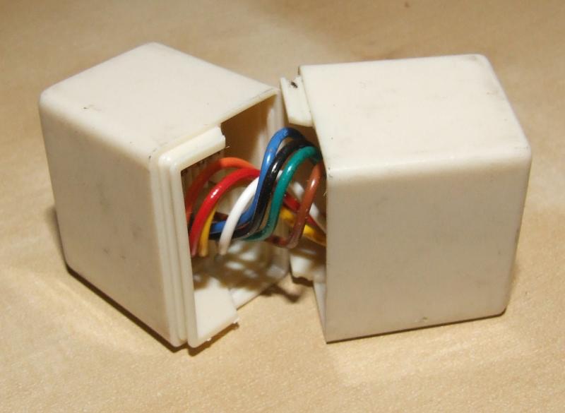

After a bit of investigation (digging around in a rockwool filled suspended ceiling :evil: ) I came across this;
Replaced the thing with a proper IDC junction box and link speeds are now at 987Kbps which pretty bang on considering overheads.
To satisfy curiosity i've tested the coupler in isolation, it still fails the test badly and on cracking the casing open I can see why.
Maximum permitted limit for untwisting pairs is 13mm, as you can see the image above clearly shows that the couplers do not uphold this standard.
This is a plot of the NEXT test, red line is the limit

If a coupler is not advertised as being compliant with any particular standard (or comes from a dodgy source like many ebay sellers) then it doesn't at all surprise me that it isn't suitable for gigabit ethernet (it would probablly be fine for 100BaseTX )
I have seen couplers from reputable suppliers that claim to be cat5e certified and would expect those to work fine with gigabit.

This coupler by the way failed all tests and was not suitable for carrying any data under TIA or ISO/IEC standards.
