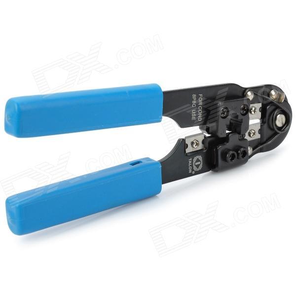

I volunteered to put an RJ type plug on an elderly neighbours telephone handset line.
When I got it, the plugs are smaller than I'm used to.
They are 4/4 and a tad over 7mm wide.
I thought they might be RJ10,,, until I saw RJ9 in the mix.
After an hour or so of searching, I can't find the physical differences between 10 & 9.
1/ Is there anywhere where I can compare sizes ?
2/ Can someone tell me the difference please ?
3/ Once I know the right size, I'll need to get a 'head' for the size for my crimpers. I have no idea where I bought them - will I be able to get just the head/s ?
any other help or advice welcome.
Thank you for reading.

I already have 4P4C connectors (& crimpers), but they are too big for this application, hence my - wrong - terminology of RJ11.
I still can't find the difference between sizes (oooops 'RJ') 9 & 10.
It looks like I'll just get a replacement lead in the end, but I'd still appreciate the details if anyone can supply them please.

When I was working, I used RJ11's (excuse the wrong vernacular [although it may have been correct in my work - CCTV etc] but for this purpose, I hope you bear with me), I was pretty sure that I had used 4-pin ones,,,, then decided to go for 6-pin ones for versatility - but always 'RJ'11 size.
I still have some,,,, but now see that they are all 6-pin.
Sooooo,
If I wanted to buy 'RJ'10, I ask for 4-pin (4P4C) ?
Are all 4-pins the same physical size ?
Are 'RJ'9's the same size ?
'RJ'10/9 crimpers seem more difficult to get hold of. I thought mine had an interchangeable 'head', but can't locate the smaller heads.
As above - I've decided to buy them a new lead,,,, & its not likely that I'll need to use these connectors in the future,,, but I like to know details.
