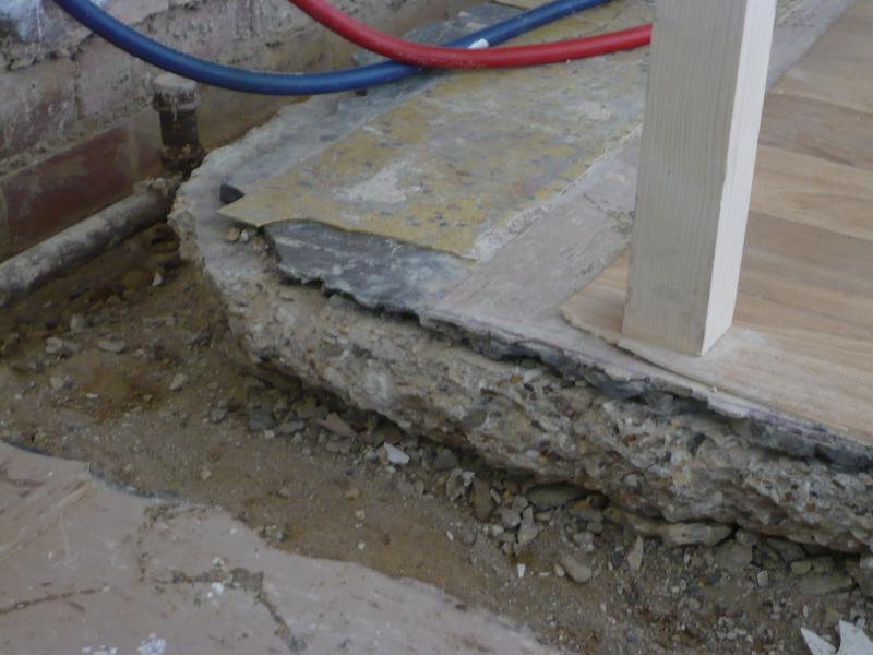

I've dug a channel in the concrete floor across the kitchen floor to facilitate repositioning of the water\waste\gas services-
The photo shows the channel (you can also see the old gas pipe):
There is about 100mm of concrete overlying the earth and then 10mm of black stuff and then the old floor tiles. Is this rock asphalt?
How should I fill the channel? I assume I should not just use concrete if the original building has a surface dpm (if this is what the black stuff is).
Thanks in advance.

2. For the record, when encountering what appear to be redundant gas pipes, always mechanically determine that they are not active and then physically isolate the dead leg(s). "Corgi" applies of course

To make good your floor: concrete up to FFL of screed topping (below tile) polish off and when well dry, use a "brush on" membrane - the conc. and cut channel look v. dry anyhow. All pipework in conc. must be wrapped in plastic.
How do you know that this gas pipe is redundant? How do you intend to drain a waste below floor level?
