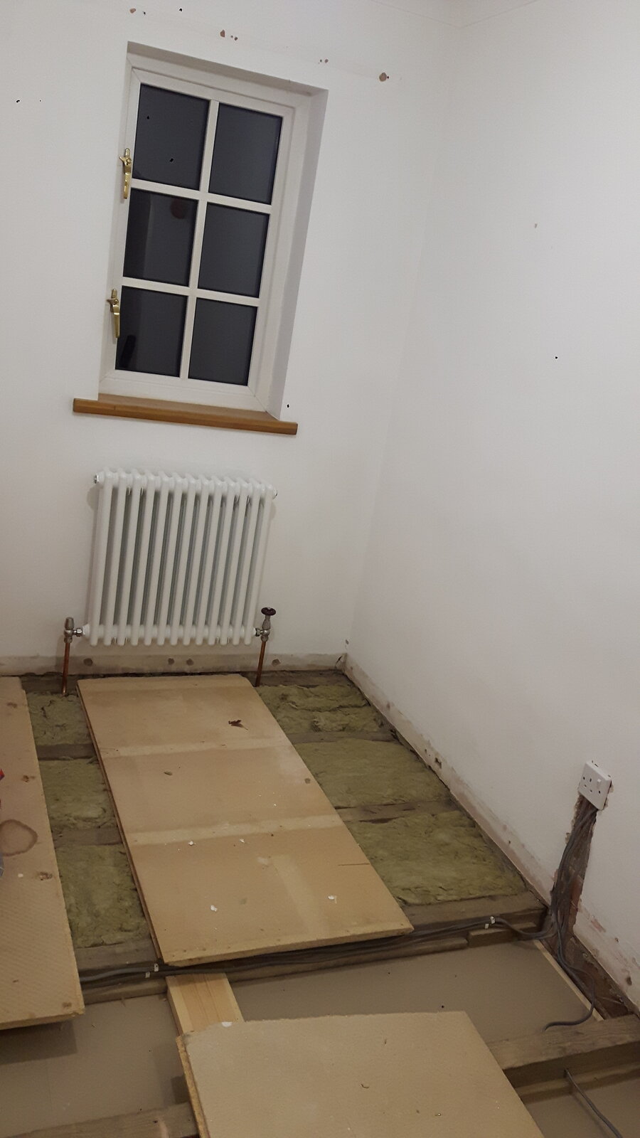

Hello. We are sound insulating underneath between ground floor ceiling and 1st floor subfloor. The distance between joists is at 360mm and the height between the plasterboard downstair and the subfloor is at 75mm. Can we use 100 x 400 rockwool slab? We have started. Please see example below

Hi John. Thank you gor the quick reply. we have just re boarded the ceiling between the joist on the ground floor. We are now replacing the subfloor because it was in very poor condition. We want to insulate for sound because we can here everything happening downstair from upstair and vice versa. There is not much space between the plaster board on the ceiling and the subfloor on the 1st floor. Only approx. 75mm. and the distance between joists is at around 370mm. I have started with 100x400 rockwool slab and it fits quite tightly. Do you think that's okay or is that going to press to much on the ceiling board downstair?
Thplaster board thickness is at 9.5mm
The subfloor will be 22mm wisa sprucefloor plywood tongue and grooved.
we will not have carpet. We were considering engineering wood floor on top of the subfloor with a layer of cork in between.
We haven't sealed any holes.
Mickael
We found the rock wool bats work well, but do have an air gap between the top of the bats and the underside of the floorboards.
Seal the holes. Noise comes through gaps. You can use firefoam or caulk. Even if you are not obliged to use the fire grade I think it is a wise precaution.
An uncarpeted floor will be needlessly noisy. Speech will travel through it. Footsteps, and especially chairs or furniture moving, will be very annoying.
A double layer of plasterboard, plus skim, will be better than your thin layer.

I find it muffles airborne noise (speech, TV, radio, music)
But would not expect to make so much difference to impact noise (hammering, drilling, walking on uncarpeted floor, skittles) apart from the airborne element of it
