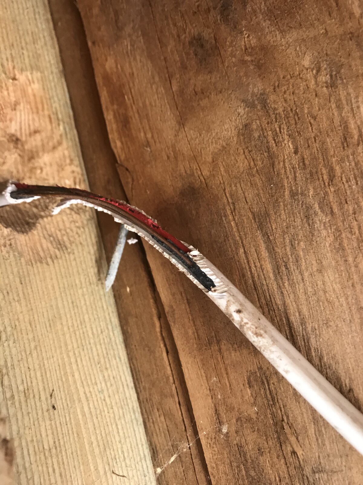

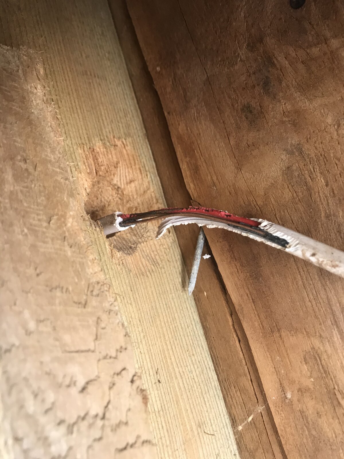

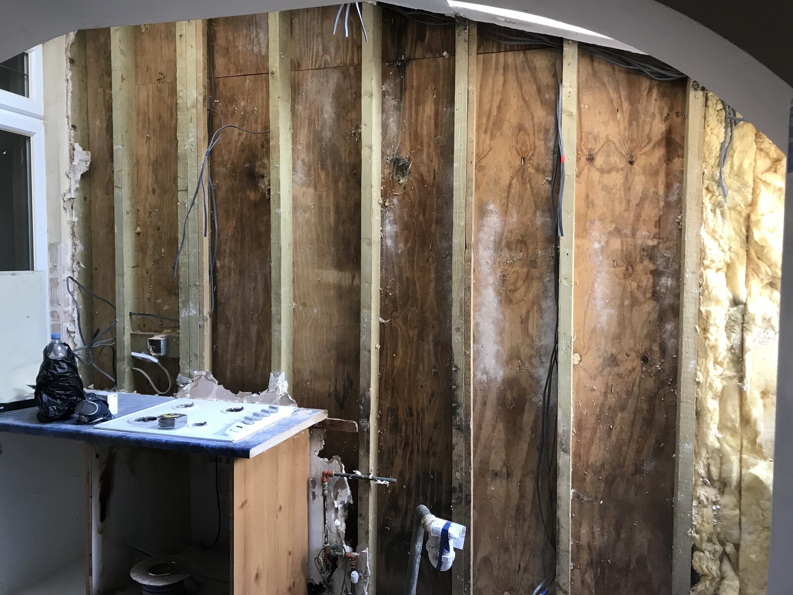

I started what was going to be an ambitious project from the outset only to find another project lurking behind the plasterboards.
I removed the plasterboards so I can fix some battens for the kitchen units to screw on to and then noticed the cables in this condition:
F24C82FC-4588-435A-AF3D-71D731E4D0E4.jpeg BCD1734F-22AF-4A75-AFA0-A1A787BE48FC.jpeg
We had a problem with rats a few years ago. Do you think this is their doing? A number of other cables were also in a similar state.
Out of caution, I replaced all the visible cables:
Assuming this has been caused by the rodents:
1. What was the danger of this going unnoticed?
2. Should I be concerned that other cables (not accessible) have suffered a similar fate?
Thanks for your help.

Looks like rodent damage to me.
The danger of this going unnoticed is that you have live exposed wires that someone doing maintenance could touch.
The wires could potentially touch (although rodents chew so carefully this doesn't seem to happen) which would cause a short circuit, meaning fuses blowing or breakers tripping.
Could this sort of thing cause a fire?
Also, would the rodent have been electrocuted by nibbling the Live wire?
How concerned should I be about the state of other cables? These were only uncovered as I removed plasterboard from this area. Hence the question on fire hazard.
Also, what do you recommend for the cable joins behind plasterboards. There are some old ring main cables that I need to join to the new cables I have laid. There is also the lighting cable that needs to be joined.
I assume it’s a maintenance free connection but can I please ask for a recommendation. I do have plenty of wago connectors if that’s sufficient.

Wago connectors combined with the appropriate enclosure can be classed as maintenance-free. TLC may be best place to check what combination is appropriate.
For the RFC cables, one good way of making the joint is put an extra socket in at the joint.
Yes rat-gnawed cables can be an issue. Without doing as you've done (expose the cables) then insulation resistance and low ohm resistance testing of the cables will indicate if there's any dangerous damage.
The test gear needed isn't cheap.
And pointless if you do not have the competence to operate it and to interpret the results.
Given the state of the cabling, you can assume that there is a lot of this sort of damage in the property.
At the very least, I recommend that you have an electrician carry out a continuity and insulation resistance test on the whole installation. Perhaps a full EICR. If the rodents problem has not been sorted then get a specialist company to deal with them. The little burgers won’t go away on their own.
