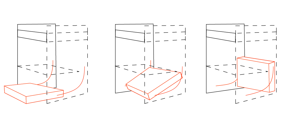

I have made a high sleeper bed, with a desk beneath. To add to the utility of this unit I want to install a fold-out bed, that effectively stands behind the desk when not in use, and extends beneath the desk when required. That is to say that the foldaway bed has the foot postion on the left, the head position on the right and the width stands upright against a wall.
I can conceptualise the way to make this work, with a curved roller guide at each end of the bed frame, so that when pushed from the "open" side the guide raises the bed on the "closed" side until is is vertical (ie parallel to the wall), but I can’t figure out how to engineer the thing. I have seen custom rollers and guides online, but these look like they are designed for food production conveyor belts (or similar) in horizontal rather than vertical configurations.
Any suggestions?

Maybe try looking at UHMW (HDPE) linear guides, which certainly have the duty cycle you need, or possibly go the other way and consider turned polished steel "mushroom" pegs running in a track machined from 40 to 50mm thick UHMW plastic (HDPE 1000 grade). I think the biggest problem you'll face is producing the curved track and making sure that the frame which holds the two ends together is rigid enough, which is why I suggested captive mushroom headed pegs running in a track. TBH I think I'd want to weld-up a steel frame to carry the lower bed base if only to reduce the strain put onto the main (presumably timber) frame

Galvanised 25mm electrical conduit, formed into a 90 deg at the rear corner - it would need bending in a machine, any industrial electrician would have access to such a bender. Source eight brass rollers with V's in the circumference, four needed at each side. Weld, or have welded on the outer edge of the 25mm tubes some 25mm x 5mm brackets to allow the conduit to be fixed to the bed base and the wall. Rollers fix on more brackets, mounted on the movable part of the bed on the inner sides of the tubes. You end up with the roller brackets on the inside, the other side has the support brackets which are able to pass between the rollers.
It will need some effort to heave the back edge up around the 90 degree bends so maybe some sort of springs at the back edge to assist with the lifting.
25mm conduit would make for a less sharp bend than the next size down 20mm.

Ok, I think that is not a bad idea, although requires a completely different roller guide (but more straightforward), ie a straight, vertical guide. So, I think with that method, I would also need to find a way to encourage the inside edge to lift - which I think I have an idea on too.

No one mentioned noise concerns - delete brass rollers, use nylon rollers. Nylon rollers can be homemade, from a round nylon cylinder - cut a section off, drill centre hole, fit and tighten long nut and bolt, then spin it in a drill chuck to cut/form a V in the edge.

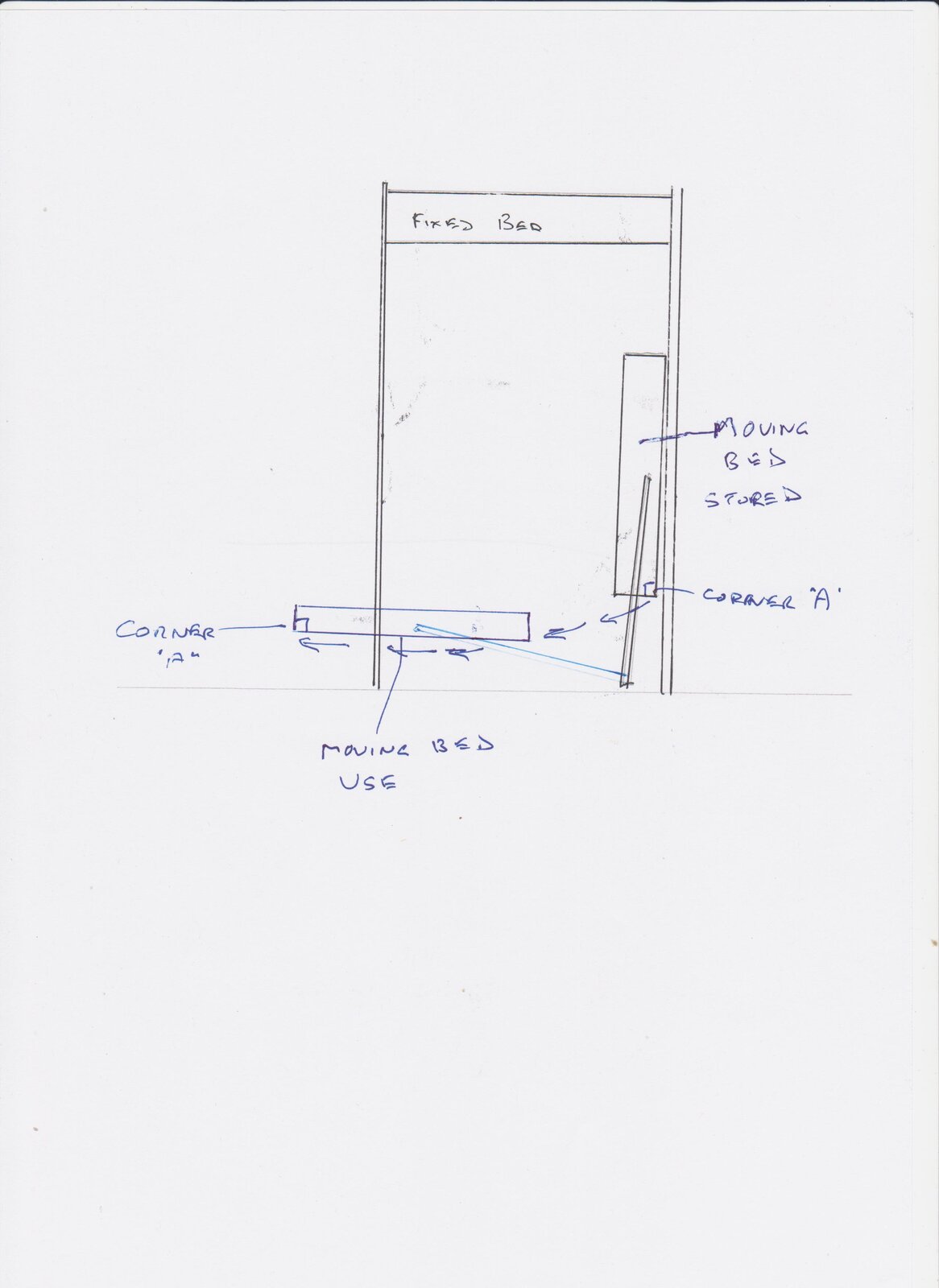

I wouldn't bother with a track/guide. Just use small wheels at the bed base corners, Like this :-
