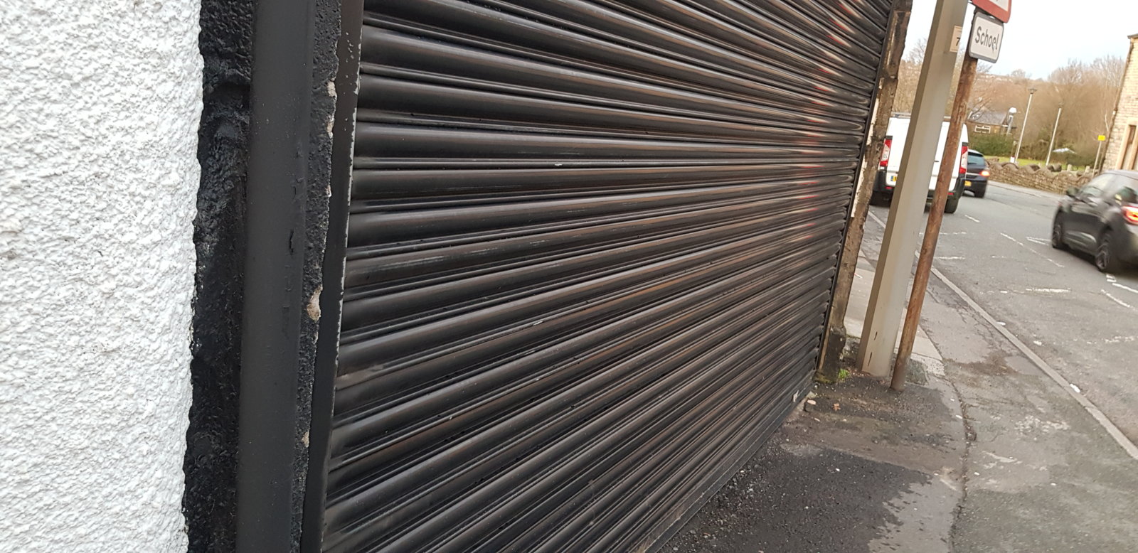

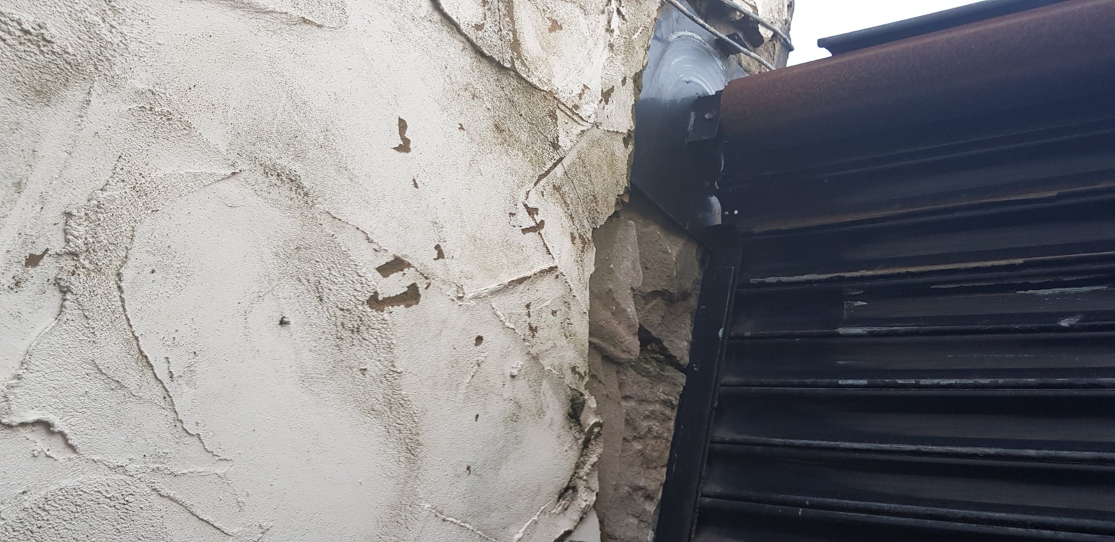

I have a external electric roller shutter. it was working fin until last week my son accidentally gently reversed in to the shutter whilst it was opening. no visible damage ie bent slats etc
Now it does not fully open stops 2 ft from fully opened. iv tried forced pushing it whilst opening still stops 2ft from fully open.
What i have noticed when fully closed the slats looking at the roller box the slats are at a angle not level to the roller box if that makes sense. one end is higher that the other i dont know if that is the problem causing not to opening fully.
I have took the roller box off drilled the rivets. the bar of the shutter are going into side runners with a bolt. I was thinking of undoing the bolt from one side and manually rolling the shutter until the slats are parallel level with the shutter bar rather than being angled
any advice please will be much appreciated

If the bottom slat is still getting flush to the ground it suggests that one of the slats has come unlinked. Stick a tape measure up each side of the door, see if there's a point where they go from level to not level. Are the slats loose on the low side (ie can you rattle then to and fro in the track)/tight on the high side? Got any pics?
Your best investigation method is usually to remove one of the tracks - that way you can see what's going on more easily. May be a problem if you can't get to the top fixing...

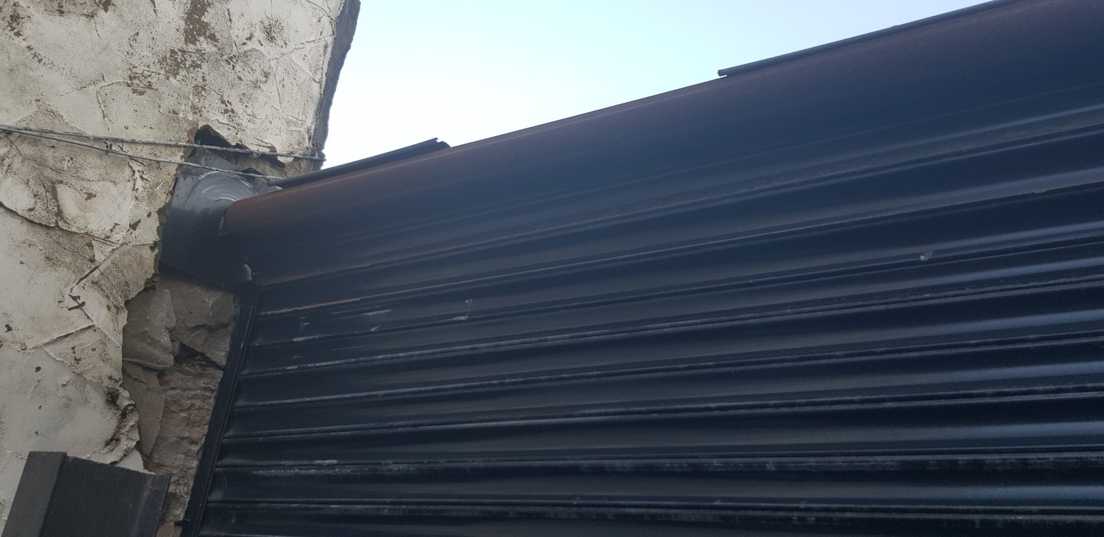

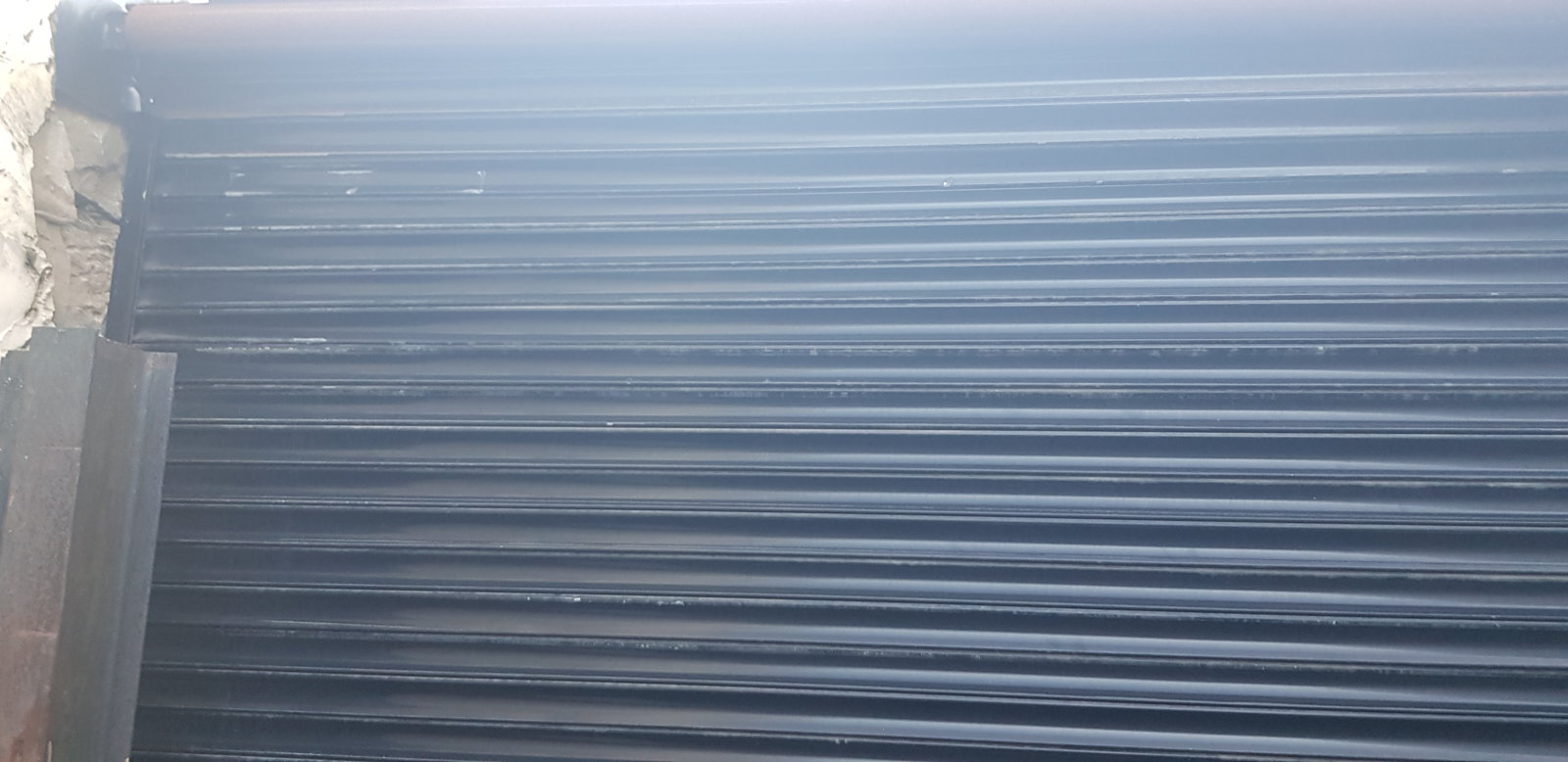

Iv send some photos

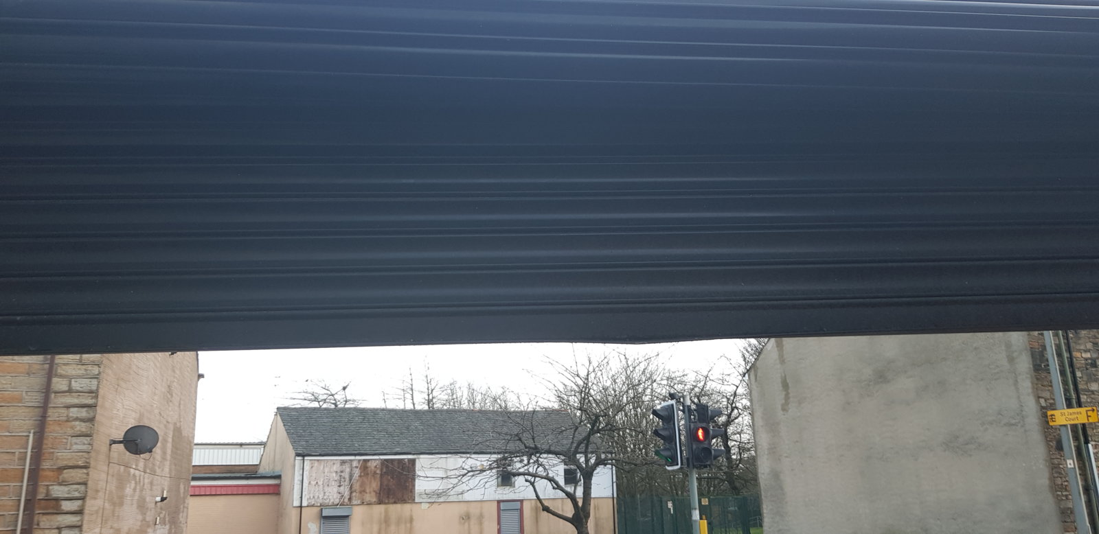

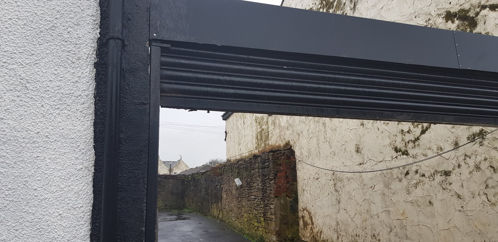

When its open and stops if you look at the shutter box and the slats from outside the slats are at a slant compared to the shutter box line. Sonthe shutter box edging is straight and slates at a angle gping in and stops about 2 foot to the end
Hope that makes sense

Hmmmm. Not the best quality photos- try doing some of that side when the sun is on it & then the other side later in the day. Was he reversing in from outside? Looking at your 2nd pic, when the door is 2/3rd closed the slats on the drum look level, while on your 1st pic the drum is all over the place.
You're fortunate its is outside- can you check that the slats are fitted securely to the drum & they're in a straight line at the top (think they will be) when the door is closed. And then get a straight edge and offer it vertically across the whole door then horizontally across each slat- it'll only take a few mm out of straight to get that pileup you're getting, the door is probably stopping short because the righthand side is jamming.

If i cn undo the nut from unlevel side and manually roll the shutter up in till level with the shutter box??
Which bolt- the one on the end of the roller? Don't do that.
The slats on the roller are going unlevel because one or more is bent or twisted, wouldn't have to be by much.

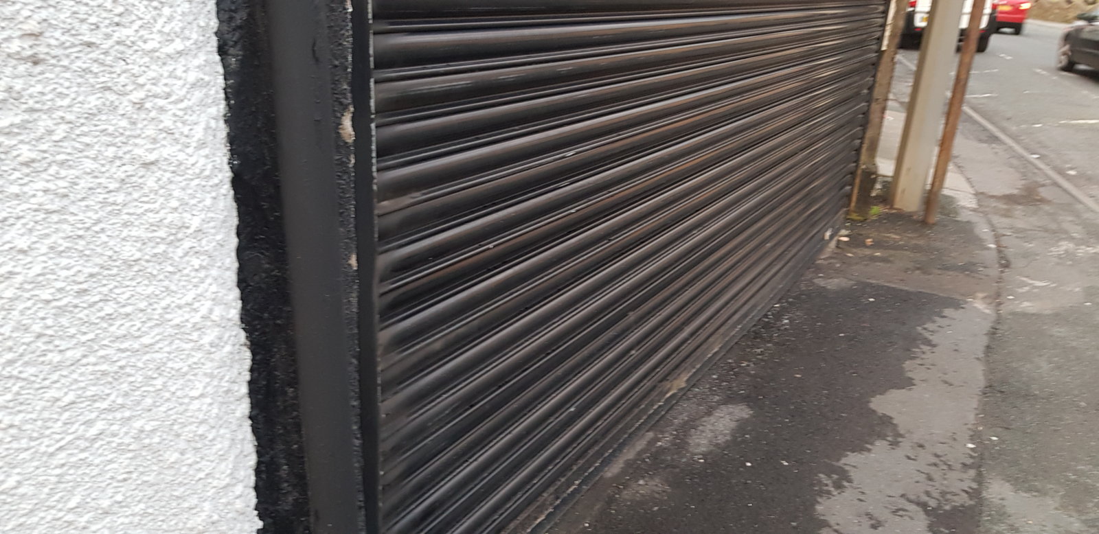

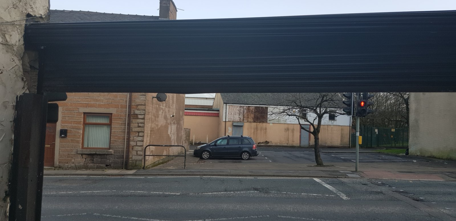

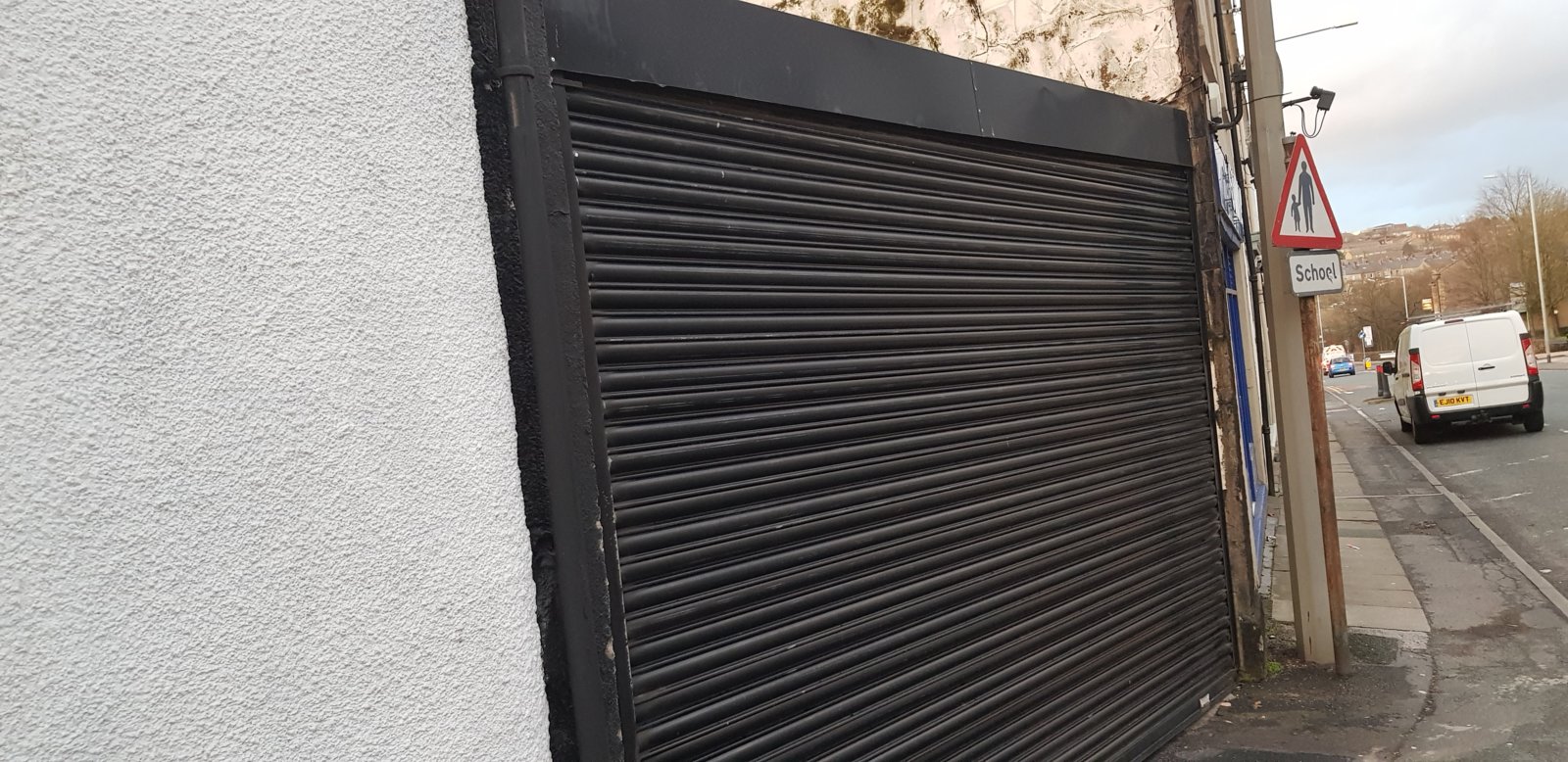

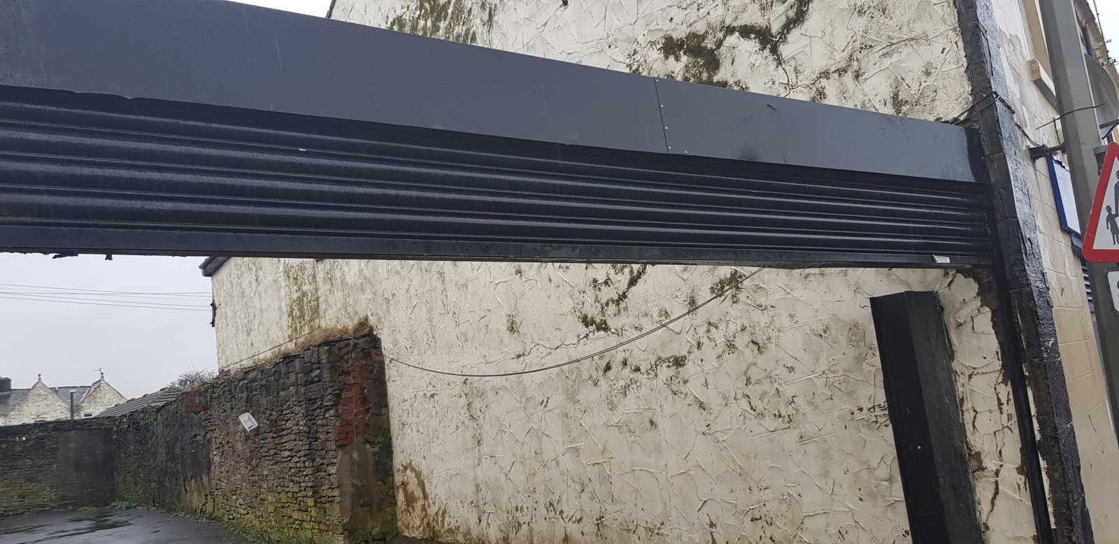

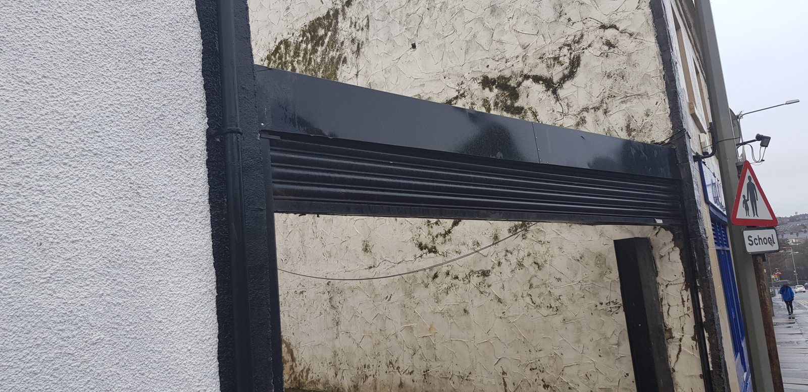

Please have a lool at the photos from the outside

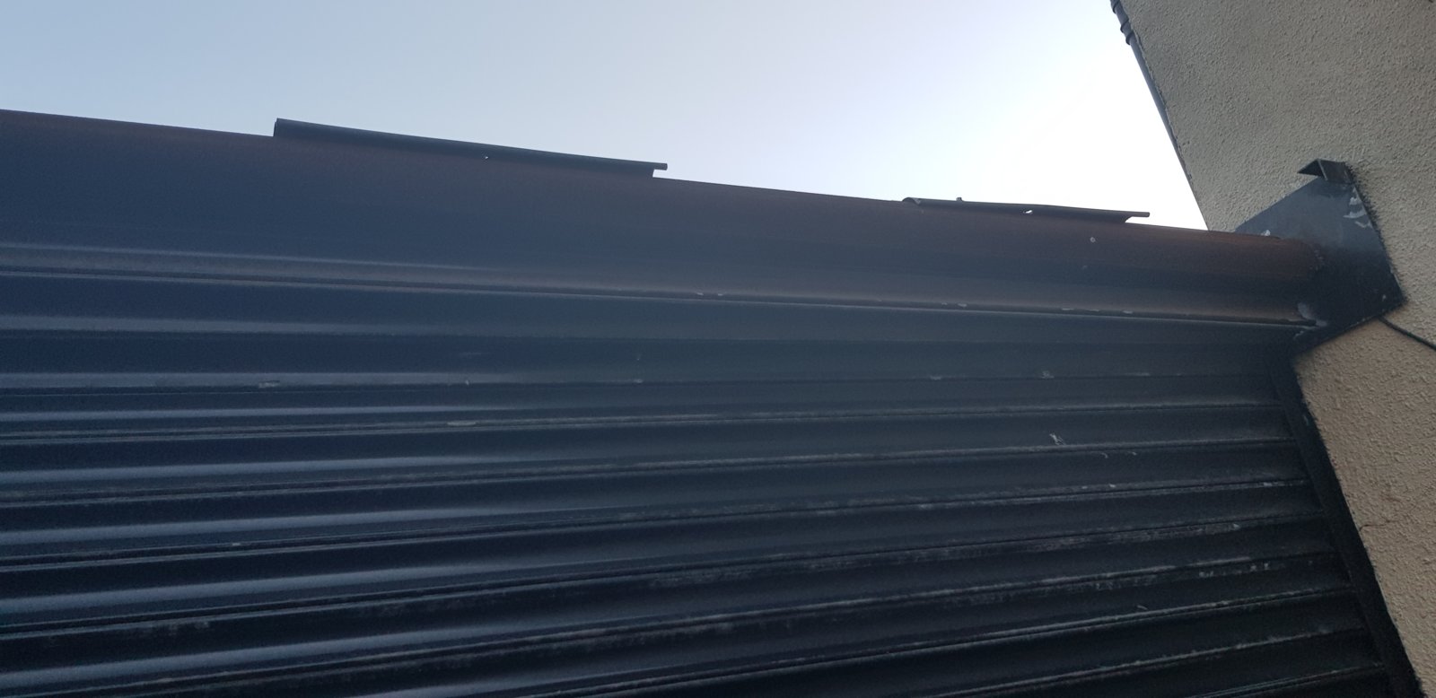

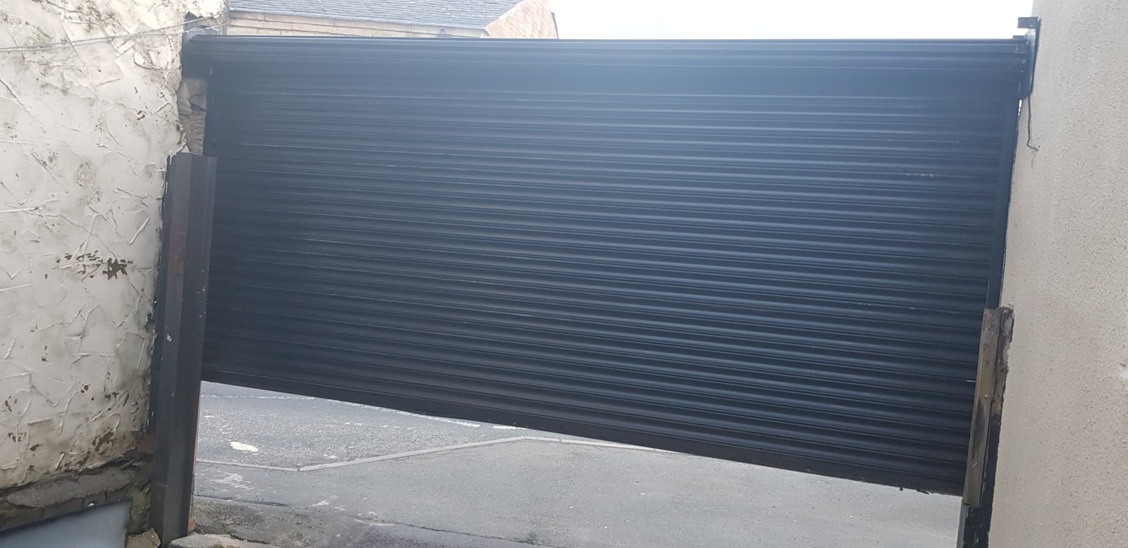

Ok. Now some pics from the front when its closed.... I'd expect to see 1 or more bent slats at about 600 above ground level. Have you done the straight edge yet?
Soory for late reply
Please see pics of shutter closed
