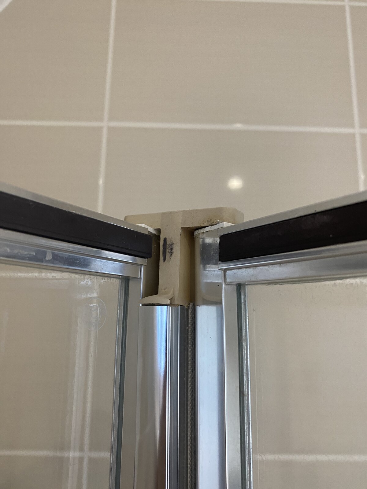

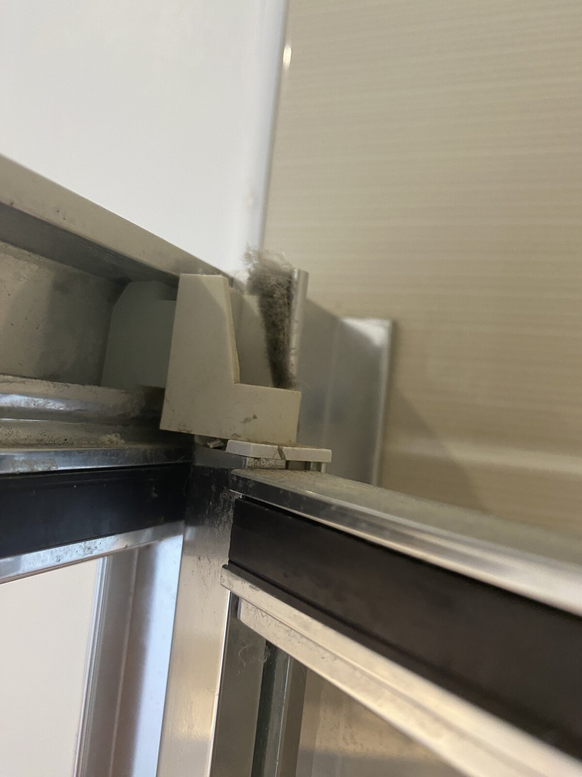

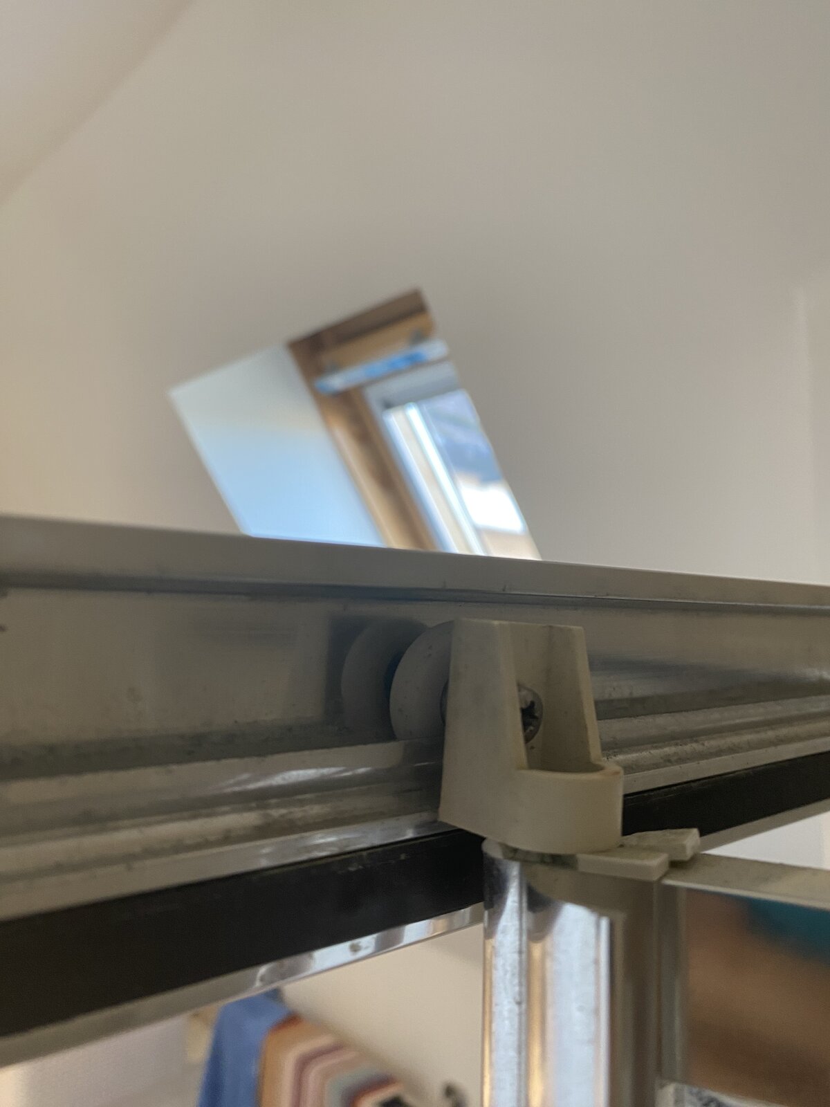

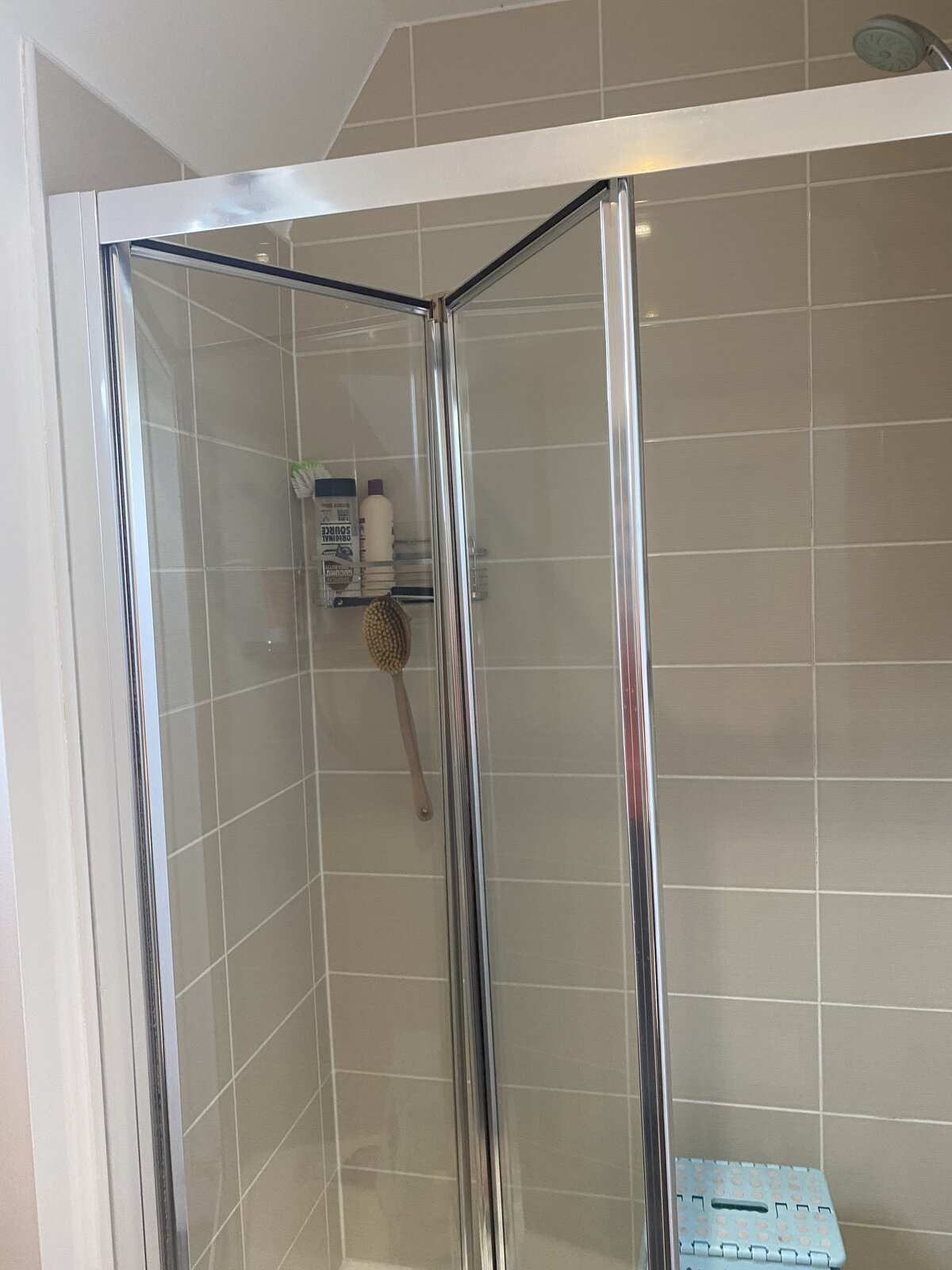

I have a Roman bi-fold shower door. Not sure of the model but it's certainly 12 years old. I'm trying to remove it so that I can add new spare parts such as the rollers etc. I've removed the 3 screws from the wall profile. Where do I go from here? Pics attached.

With the screws removed - Does the bracket, plus door, slide sideways, allowing the top hinge pin, to drop out of the bracket?
I suspect that you need to remove the top bar, but I am only guessing.
Why not email them? They should be able to recognise the model and provide both the part numbers and installation guide.
