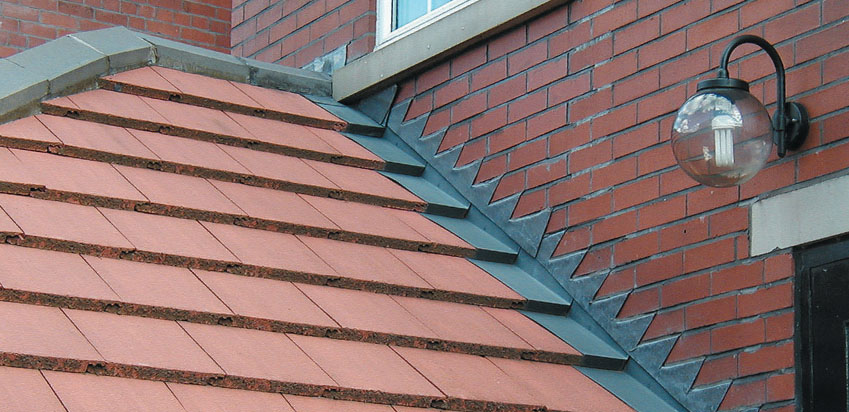

I am using Marley modern concrete tiles and my extension roof abuts the existing house wall so i'll need to install a flashing.
Can a hidden soaker be used with a stepped flashing or does the flashing need to go on top of the tiles? I would prefer to use a hidden soaker although if that's not the proper method for these tiles then, over it is.
With a hidden soaker under the tiles, how does the water not just run onto the felt.... can't get my head around that!
I think i've figured it out. The hidden soakers are really for plain tiles/slates with plenty of overlap from what i can gather.
The Marley Moderns need the flashing over. I think i'll use these, just hope they don't look rubbish! I'm using smooth grey Marley Moderns not the red pictured.
Danelaw Modern Right Hand Dry Soaker
We've used those soakers and they do work and look ok.

Not that it makes much difference but I believe the picture shows Mini Stonewold and uni angle ridge by Redland.. Very poorly executed
first time i've seen these soakers but a couple of things:
the soakers are individual plastic soakers but the stepped flashing looks like rippings of lead.
maybe i'm wrong but to me they should be under the tile not exposed?
the soakers in the photo seem to me to be left hand soakers not right hand soakers - although they've been used as RH soakers.
shouldn't the lip be at the top going over the batten as in traditional lead soakers - otherwise how are the exposed soakers in the pic fixed - whats to stop them sliding down?

in fact the photo seems odd - OP is this your house?
That flashing will not last.
these soakers have been fitted correctly, it is not a new idea,
Redland supplied the same idea for stonewolds 30 years ago.
Not plastic but nuralte in those days
The timber i mentioned fits between the top of the tile and the bottom of the batten above. just to keep the home made soaker with turned up edge from slumping
It does seem odd to have them above although if they were under, I can't see how they'd work.
No, the picture was just to show the type of soaker I was looking to use.
Do you mean the flashing in the picture or do you mean the plastic soakers generally?

without a lip how do these soakers stay put when there's a strong wind or excessive water - or, as in the above pic, when the cover flashing is inadequate?
of course, nuralite like lead can simply be shaped to fit but hard plastic cant be manipulated.
