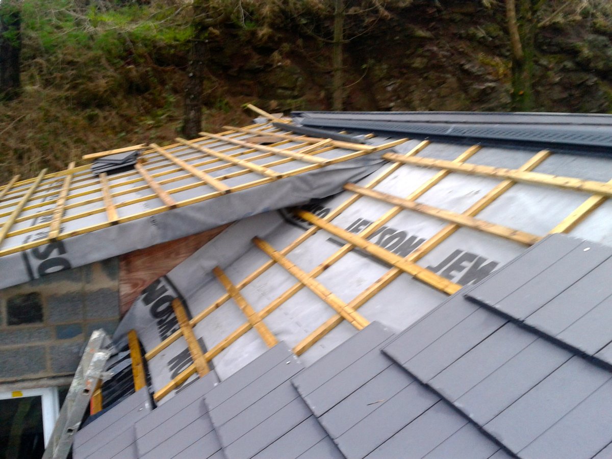

Just been looking into roof construction and sometimes I see that the construction involves battens and counter battens, while at other times, I see battens only?
I am planning to use natural slate, about 8mm thick. Under what circumstances should I have counter battens + battens and under what scenarios should I have battens only?
As an example, the attached image shows only 1 layer of battens...

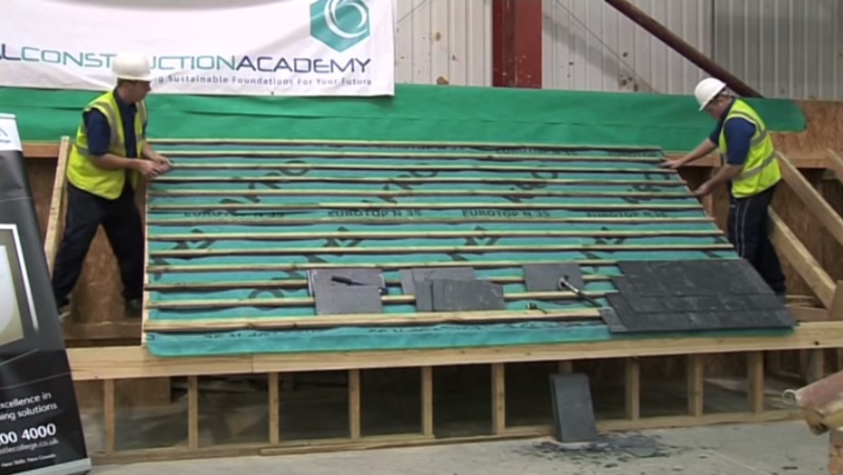

But then on this installation they use battens + counter battens...

When you are insulating the top of the rafters, and water needs to drain and air needs to flow under the tile laths
Ok, so I only need 2 x layers of battens if I am insulating over the rafters, otherwise just the 1 x layer is fine?
Insulation or something similar such as a ridgid board. Anything that stops water draining beneath the laths
If you are tiling staight on to rafters, then just the horizontal battens in the normal way.
