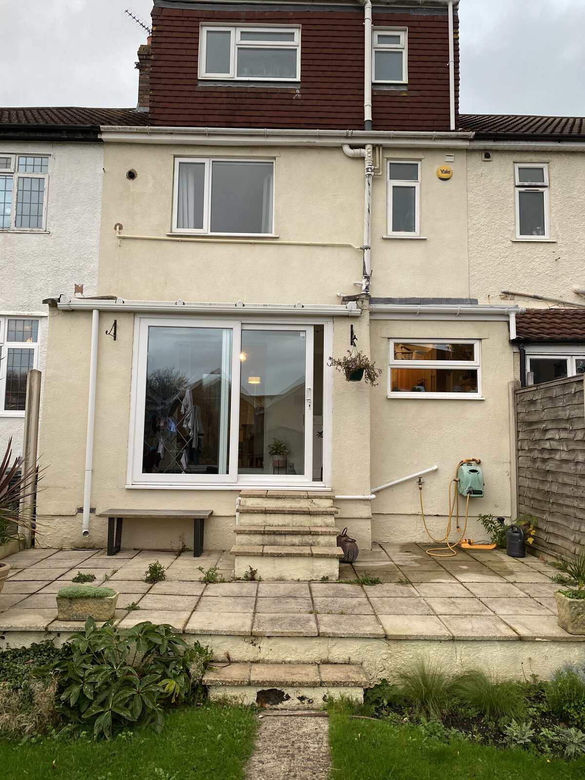

Just to help clarify, can you upload a photo as the maximum eaves height of 3m may also be a sticking point?
@DevilDamo see attached photo. The sliding door opens into the garden room which is 2.2m from the back of the original house. I measured the natural ground level at the back of the original house from the neighbours side and it’s approx 0.6m from the house floor

The overall height of 4m would be measured from the patio level. If your extension is to be within 2m of a boundary, the eaves height should not exceed 3m (from the patio level). Measuring eaves heights are explained on Page 12 of the Technical Guidance.
It does appear your only option is to seek formal Planning as it’d be almost impossible to meet the PD criteria for what you’re considering.
