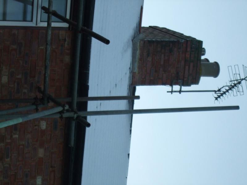

Typical that it has snowed overnight so the photos are probably not a lot of help as it has created the illusion of flattening the roof out.
However, I think the you can still see the join
and how some of the tiles seem 'raised' or a bit proud (i mean in addition to the kick up).

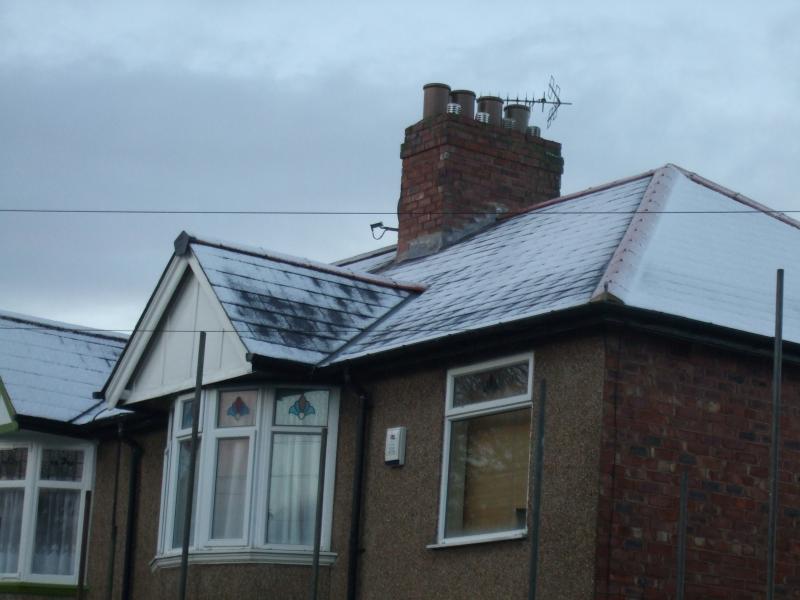

There is of the back join as well
again the snow has covered everything but I notice there are gaps still visible and I wonder if that because the tiles are raised/proud

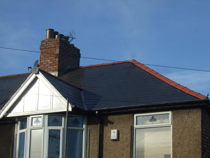

The third is a photo of the front
but the snow has pretty much flattened evything out optically (plus not enough zoom).
I'll try to get some close up shots today when the snow melts.

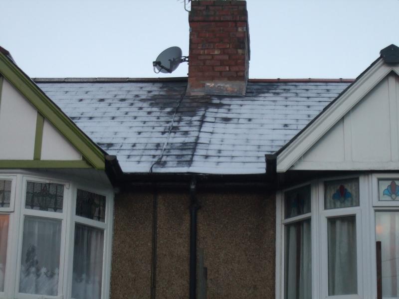

A couple of better photos now the snow's going. 1st shows the join - and the second shows one side of the roof.
The roofer has been round - he is admant he has done a good job and could not do anything else as the neighbours roof is/was not right and had no bonding.
He says the tiles that are proud will 'settle'.
I am relatively convinced but still far from sure and my neighbour is not a happy man.
I cannot for the life of me think why he would of even used a bonding gutter, so on that basis I am flummoxed.
I suppose on the basis the slates are angled inwards may invite the water to run beyond the secret gutter. Very hard to say. It may well be he's used the wrong type of GRP valley. I don't think the neighbours roof has anything to do with it. Get him to sign a document guaranteeing the valley not to cause problems. If he knows of a legit reason the he'll be happy to sign. Roofs aren't always straight forward. The slates will settle over time & the ones slightly raised won't cause a problem.
Looking at the diagrams provided by the manufacturer of the GRP gutter, they dont look quite right.
The tiles/slates each side appear to be floating in air above the battens. This gives the impression that when finished, the roof will be flat. In practice, it won't be because the tiles/slates will ride up a little over the lip of the gutter.
I think your roofer's done it right, and that the product is intended to be applied like this - but it doesn't suggest this in the mfrs. drawings.
From the pics, it looks OK so what's the worry?
