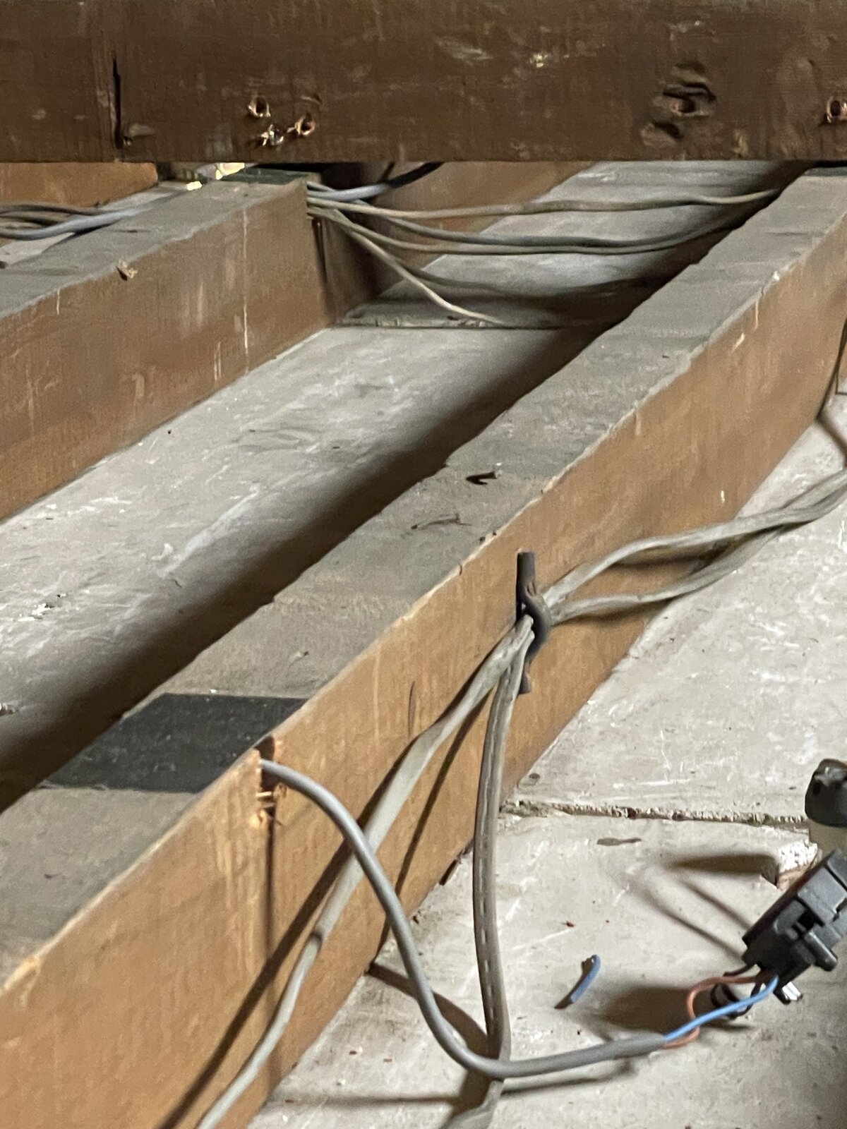

Roof joists notched in centre
31 Aug 2015
343
16
I removed all the old insulation from my loft and found some notching which concerns me - Would you be worried about this and how can I tell what sort of wood has been used for the joists -
Its certainly old wood and looks like hardwood but I cant tell what type
It is 100mm high and teh joists are 6 metre lengths at 400mm widths
Any thoughts ?
Looks like the sparkie notched the joist directly underneath the binder thinking it was a strong point. In fact binders act as a stiffener to resist twisting, and add little strength. The nearer the middle of the joist the notch the greater the weakening. That said if its been like that for years, probably no harm but if you're going to add chipboard flooring and substantial storage you could sister the joists to strengthen them but would have to re route the cables.

Thanks - Are the binder supposed to be connected to the joists - In my loft the binder appear to not even be sitting on the joists which is worrying - Should the joists and the binder be attached and if so should they be nailed or strapped in with metal joist hangers or ties ?
1) The notch for the cables is 18mm of a 100mm joist so greater then the 12.5 allowance
2) The notch is in the centre of a joist which is prohibited
3) The binder is not screwed in to the joists - Should they be?
Looking at the pic again it looks like the nails were removed and the binder lifted to create the notch, so should really be nailed back in.
Blup
Yes, it had the skew nails pulled but dont attempt to skew nail or screw back into the old holes; you will maybe hit the cables plus metal guard plates have been use over the notches - instead, use Simpson angle brackets or similar, screw thro the slot for the binder fixing.
