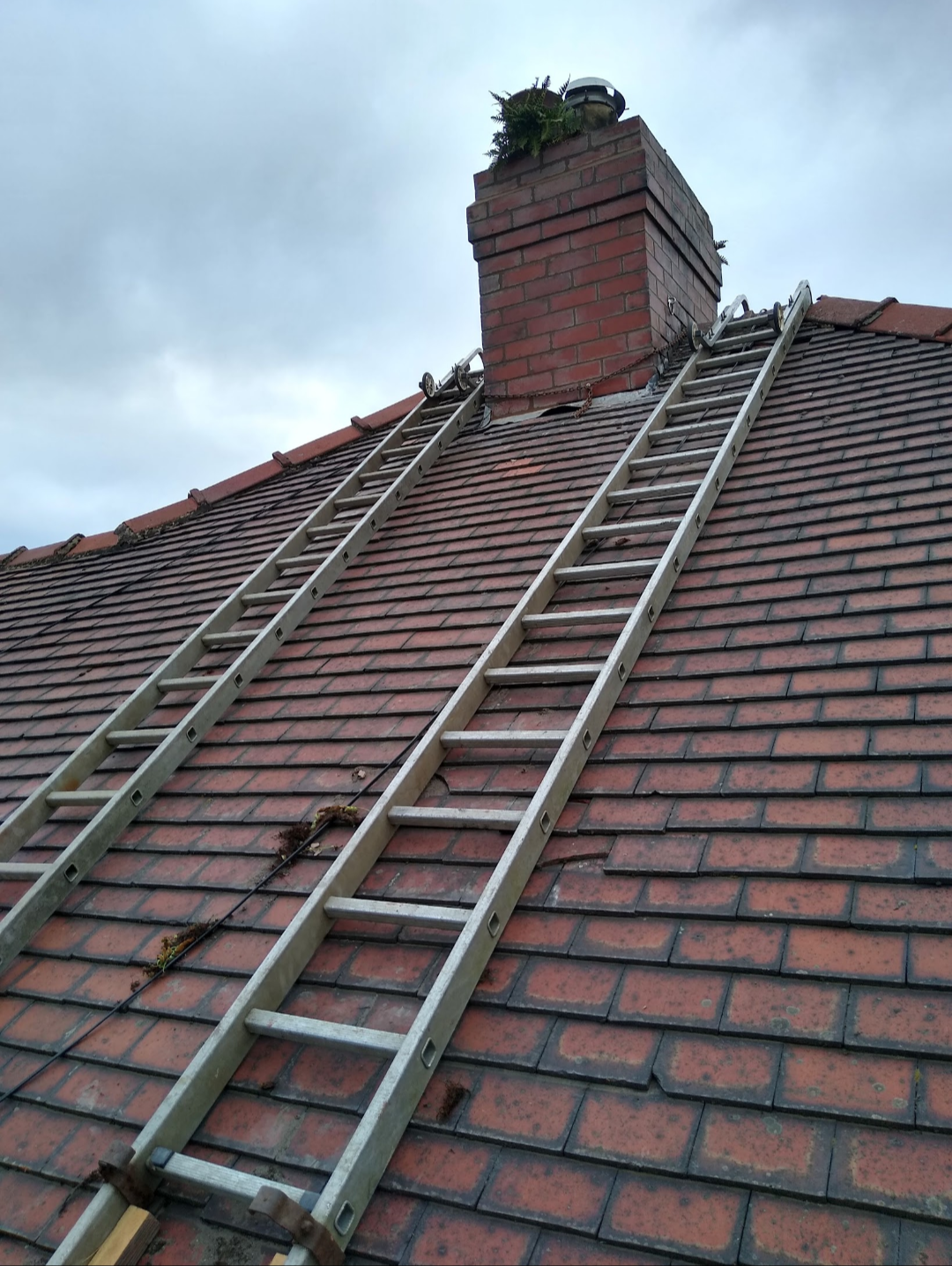

Mine is long and unwieldy but will deal with most sized roofs. Always tie vertical and horizontal ladders together. It's better to go past the gutter than it is to be well short. Short is very dangerous.
I have a pair of extendable catladders and I don't have a problem using them.
dont see many roofers using extendable ones.
Or jumping on the roof off a tower and strolling about.

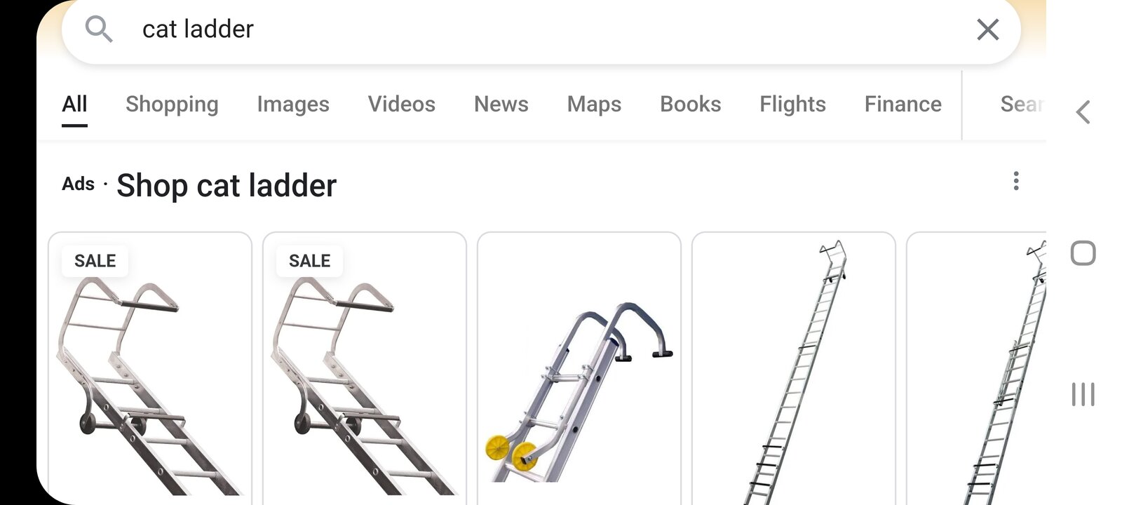

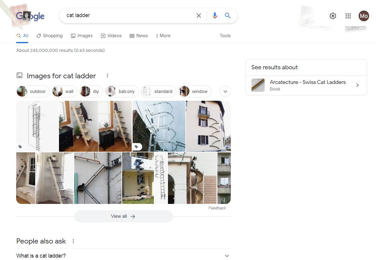

Many thanks for all the replies. When I search cat ladders it comes up with all kinds of weird and wonderful things, but nothing like what I'm after!
Are you on Google?.
I am indeed on Google!

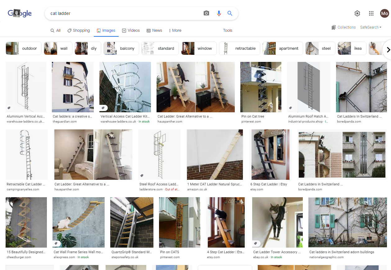

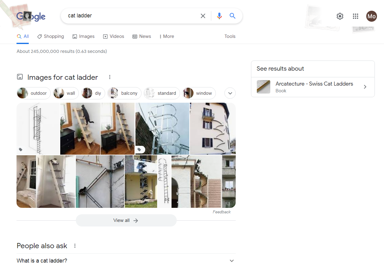

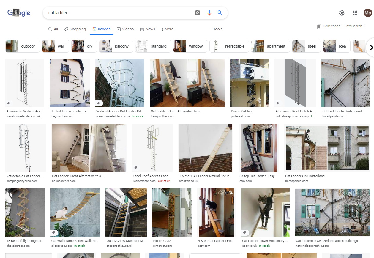

Weird - when I type cat ladder into google I get:
That is a bit odd!. Do you own a cat? (maybe Google adapted due to previous searches?).

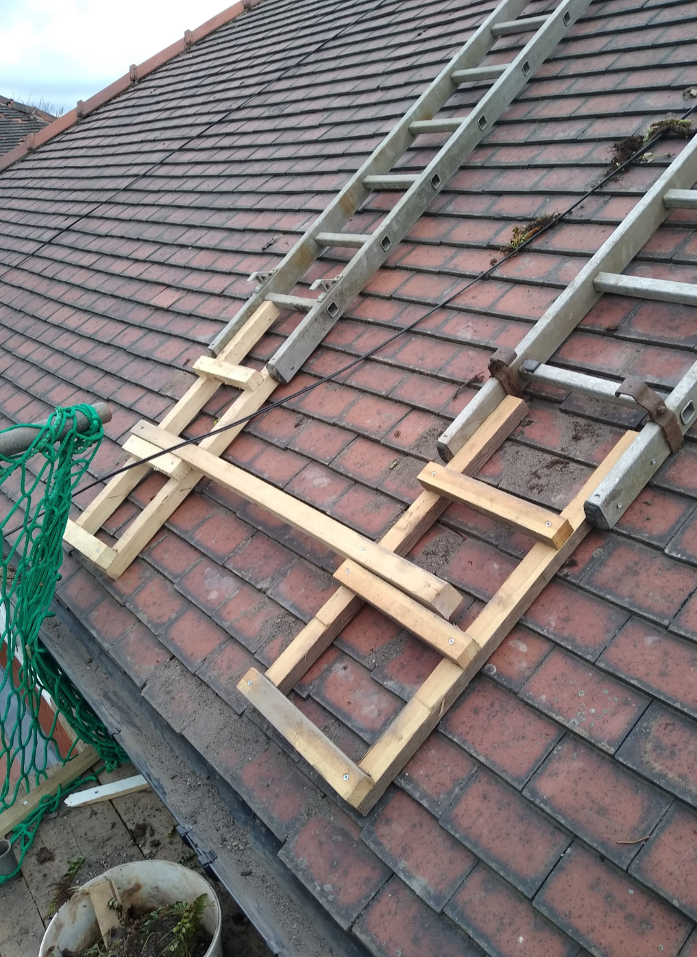

Mine were too short so I extended them:
