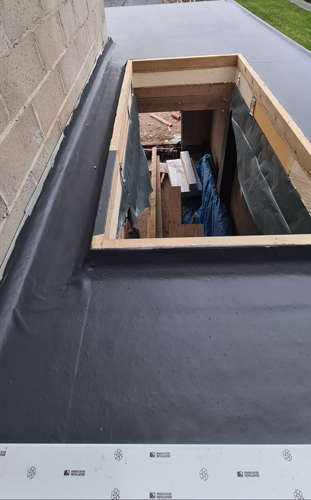

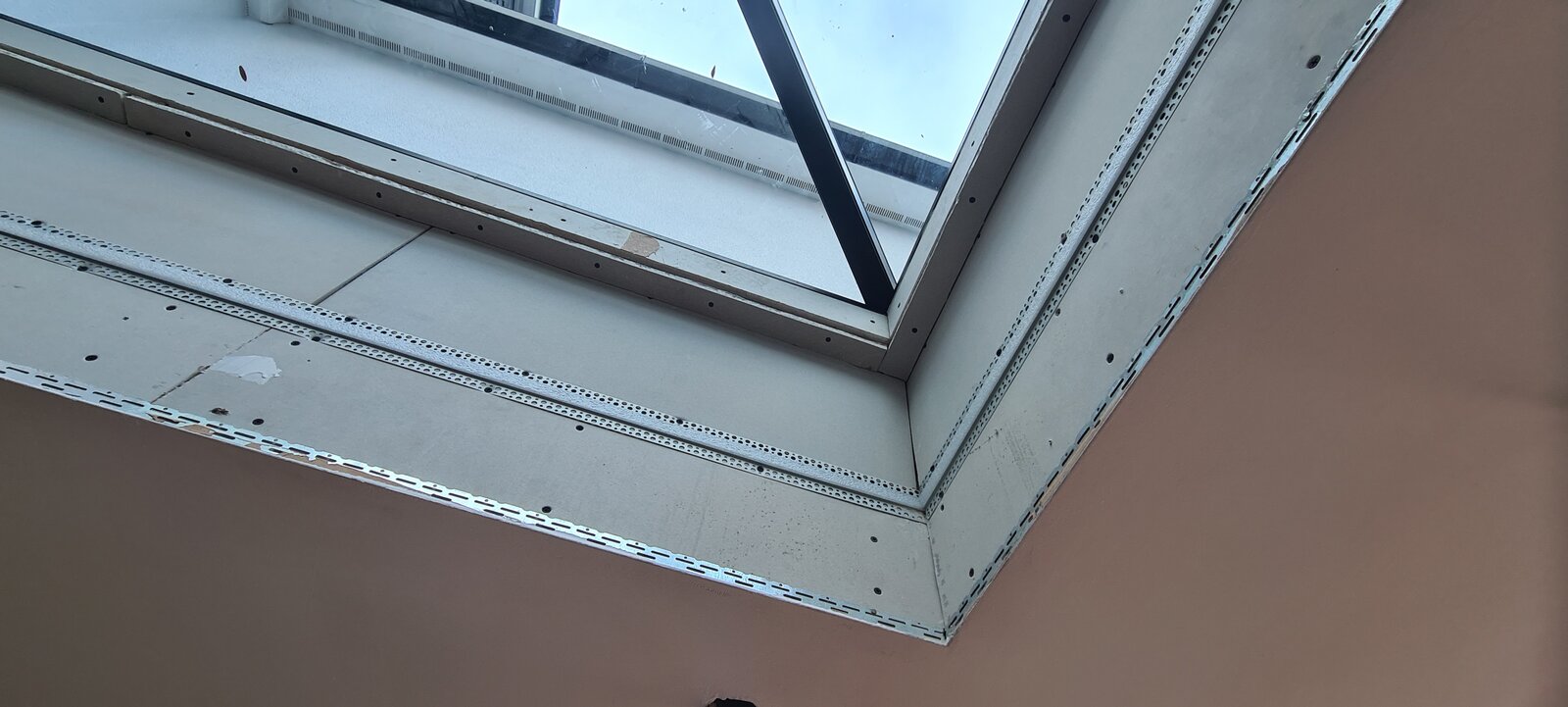

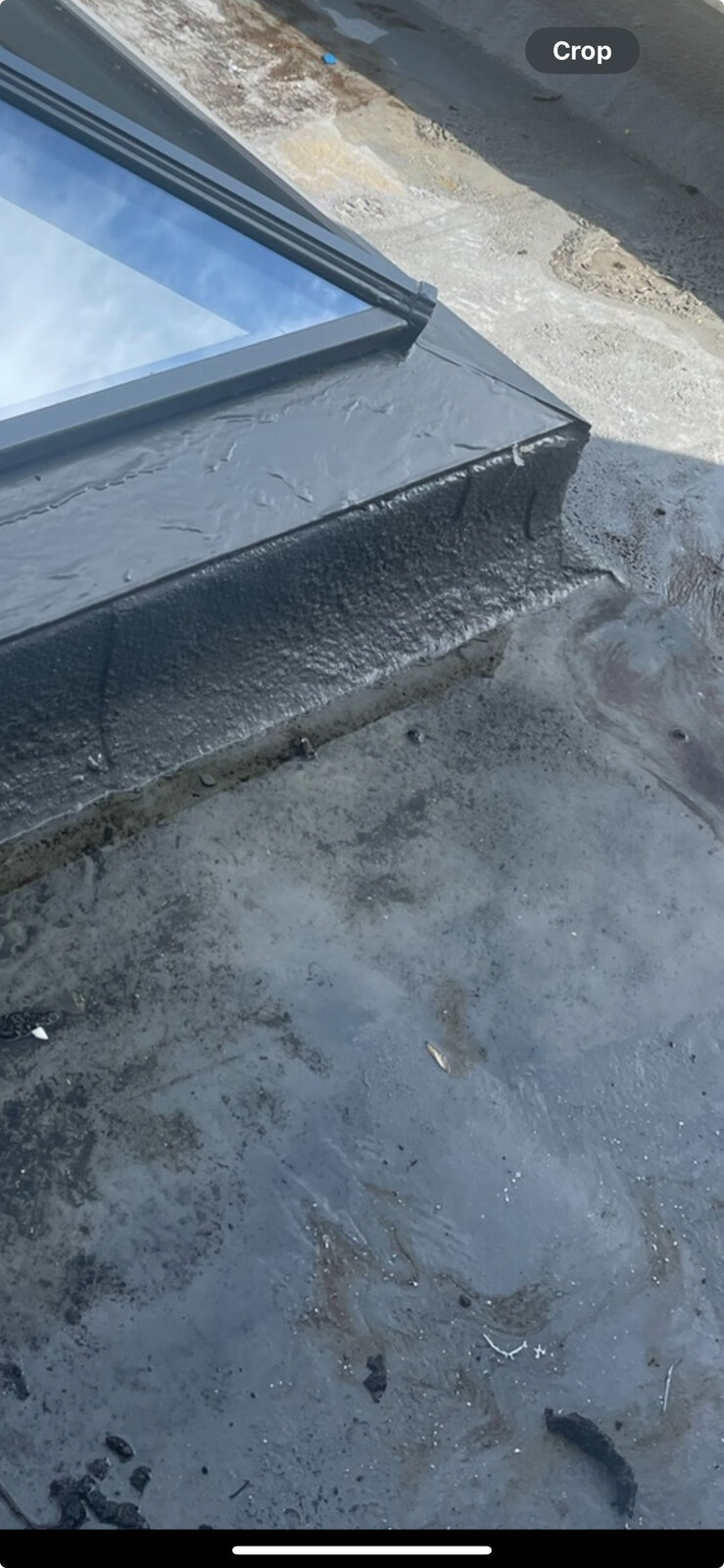

The opening for the roof lantern is slightly larger than the roof lantern. Therefore, an additional timber was added to the timber upstand to make it fit. Also lead flashing and silicone were used to make better water tight. Could this cause problems and would the roof need to be removed and redone ?

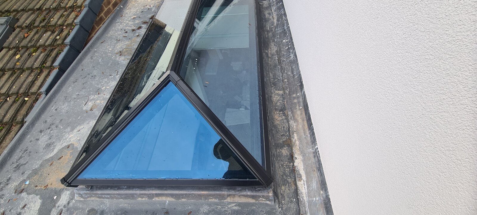

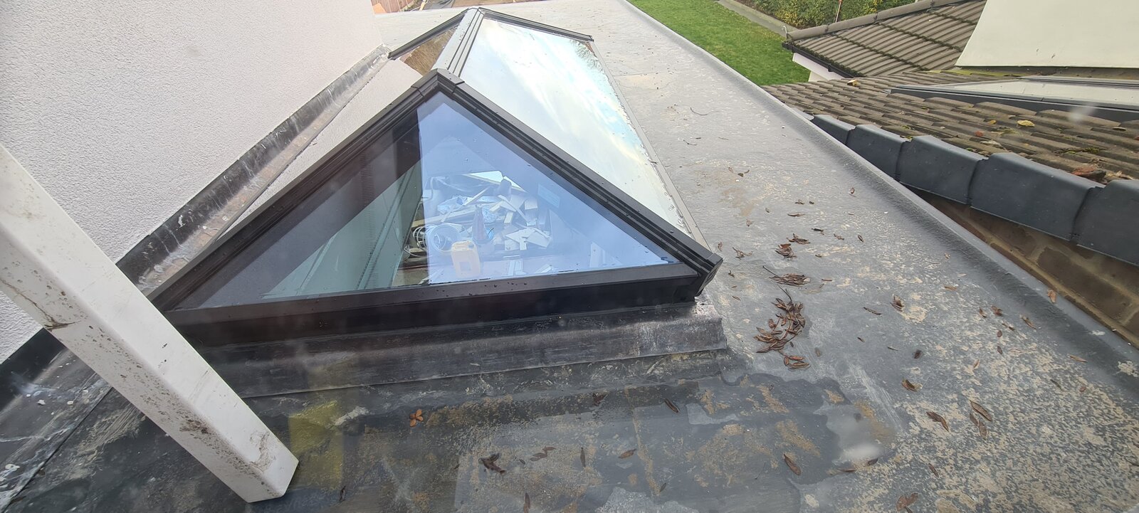

I also had exactly the same issue but my upstaged was even more overhanging the lantern than yours. My builder ordered the wrong size lantern this was 18 months ago and now has gone into liquidation and I hate to say it but I have nothing but issues ever since with leaks. We have had numerous roofers round trying to fix it but none successful as water keeps getting in. Spoke to korniche which is the make of the lantern and they advised the lantern should overhang the upstand by a minimum of 12mm to drain away. I am now contemplating whether to purchase a new correct size lantern or if I'm able to cut back the upstand. Either way its going to cost thousands to repair. I must say though your roofers work looks a lot better than mine. Please let me know how you get on.

Doesn’t look like a huge problem to sort out.
If it was me, I would screw a new timber upstand inside the existing one, to form the correct size, but it needs to be say 75mm higher, that will form a rebate, which will create a weather check.
