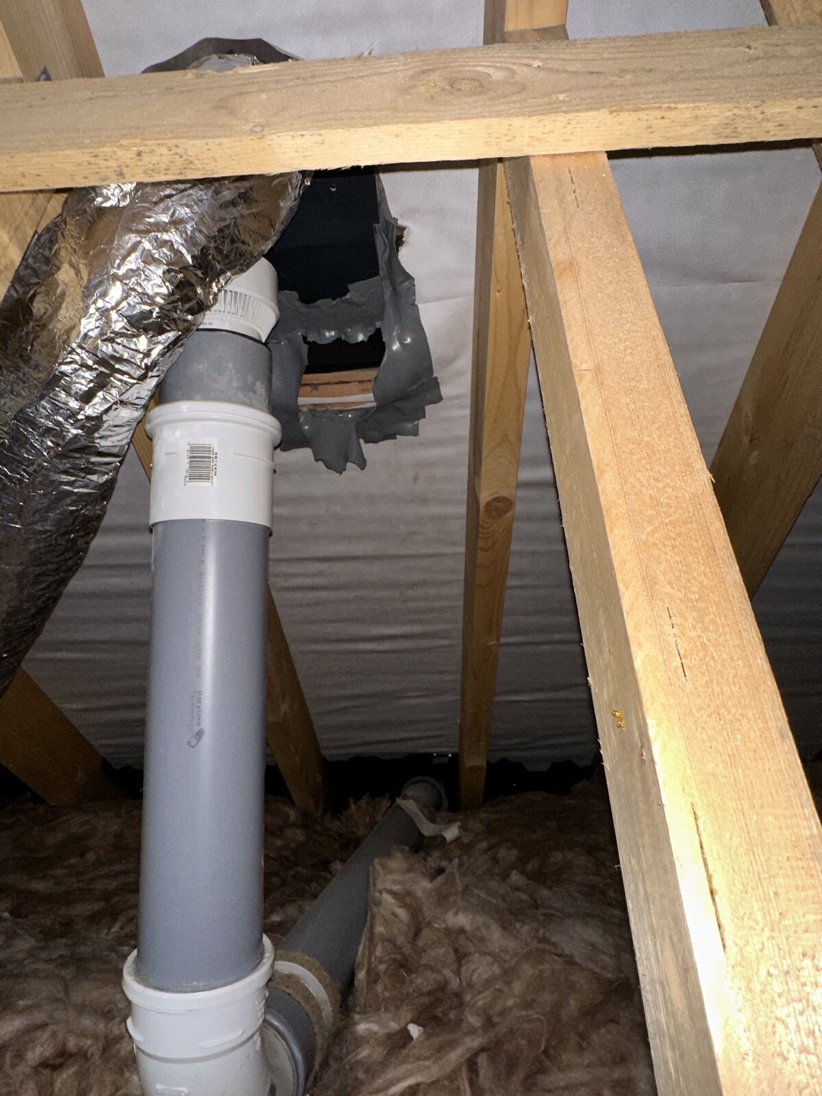

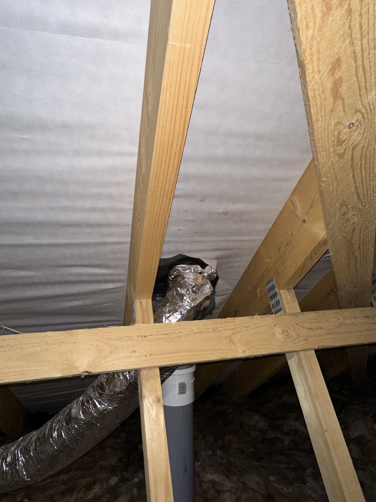

Hi,
I am looking for advice - I returned home from holiday to find an area of water damage in our upstairs ceiling. It's immediately below a vent, and there also appears to be a hole in the roof membrane nearby. I'll attach some pictures.
We are in a new build and still under 2-year warranty, so we have contacted the builder and are waiting to hear from them. In the meantime, what should I make of this hole? I know nothing about roofing, but frankly it looks like the vent wasn't installed very well and they attempted to repair it with gaffer tape. How bad is it and how should it be properly repaired?
The area is hard to get to because it isn't boarded so I am not 100% sure that the water has entered this way, but it certainly looks suspicious.
Cheers
Matt

Could be coming in the vent and running down the inside of the ducting.
Interesting arrangement , do you have a picture showing the area of exit on the outside
That membrane is done wrongly, it should be draped between the rafters. Unless they have counter battened which I doubt. That would be a retile and rebatten job.
It may not be causing your issue but it's a general indicator of the work.

So it looks like the soil pipe used to vent out that vent tile. Then someone needed to fit an extractor fan, so they disconnected the soil pipe and put an aav on, then connected the extractor fan in its place.
At some point someone has butchered the membrane using an axe by the looks.
My guess would be the ducting is leaking a bit and convection is causing a constant flow of air, then condensation is forming on the tiles above, and it's dripping down.
There could well be humid air escaping from the soil pipe depending if the aav is connected properly.

no easy fix for the damaged underlay here.
It'll need scaffold , a large area of slate removed , battens cut etc.
