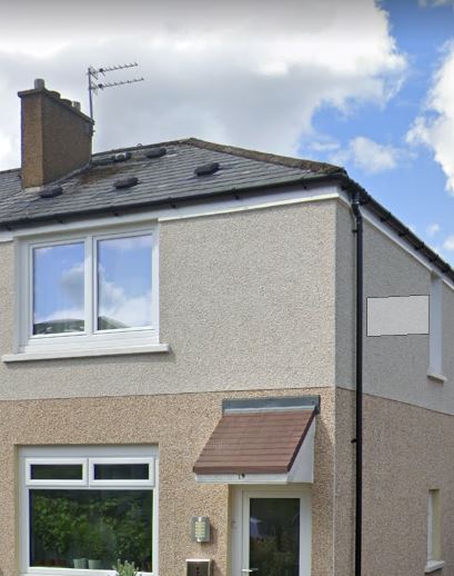

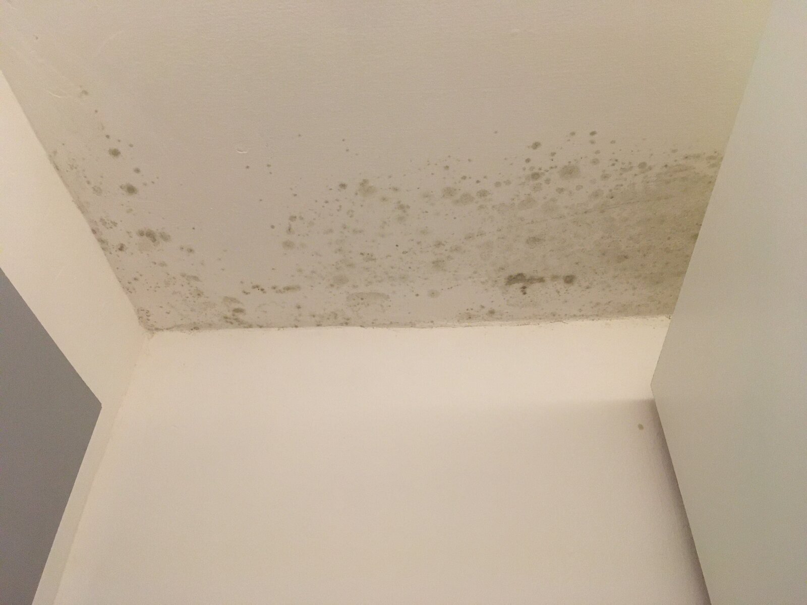

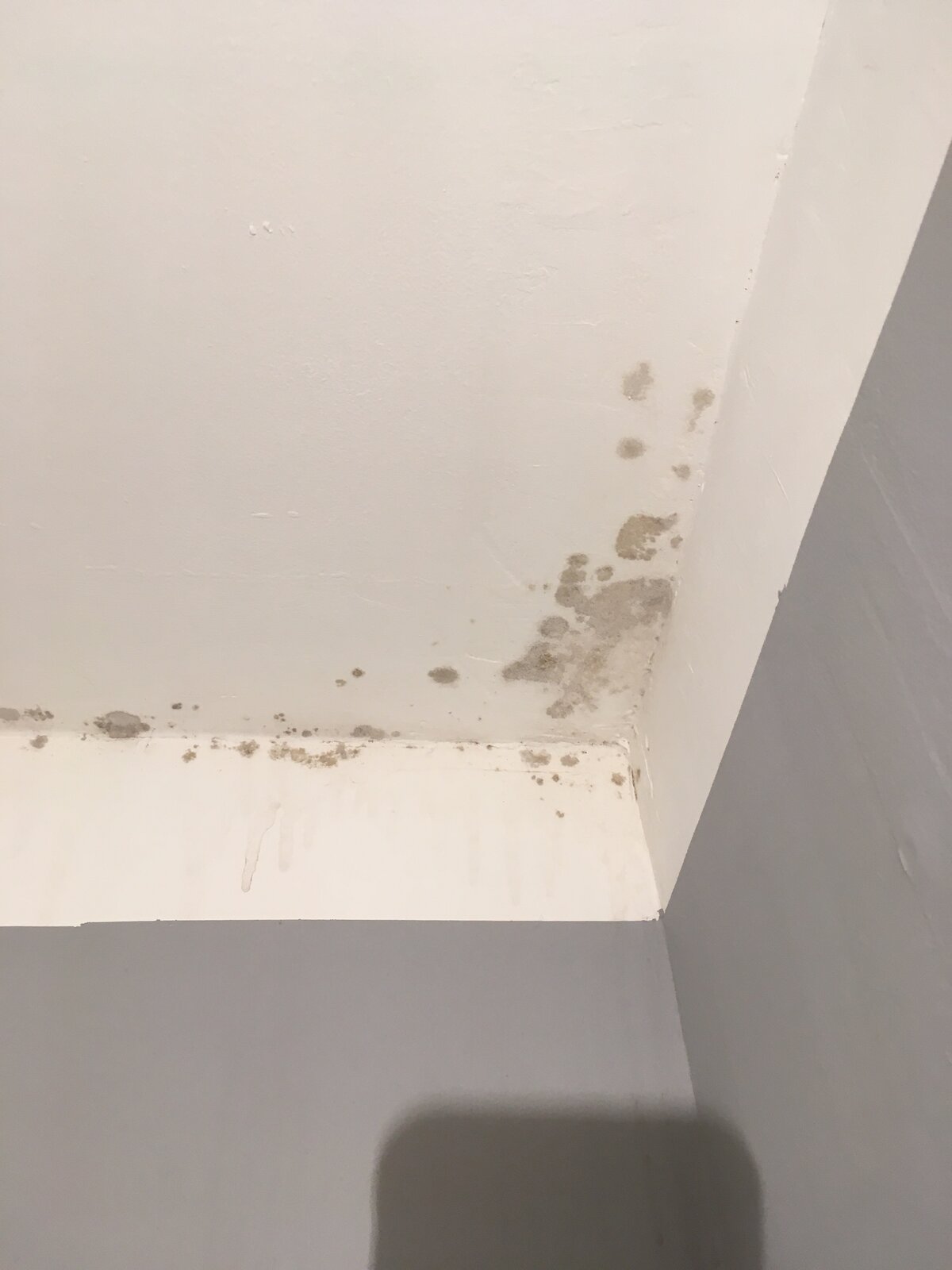

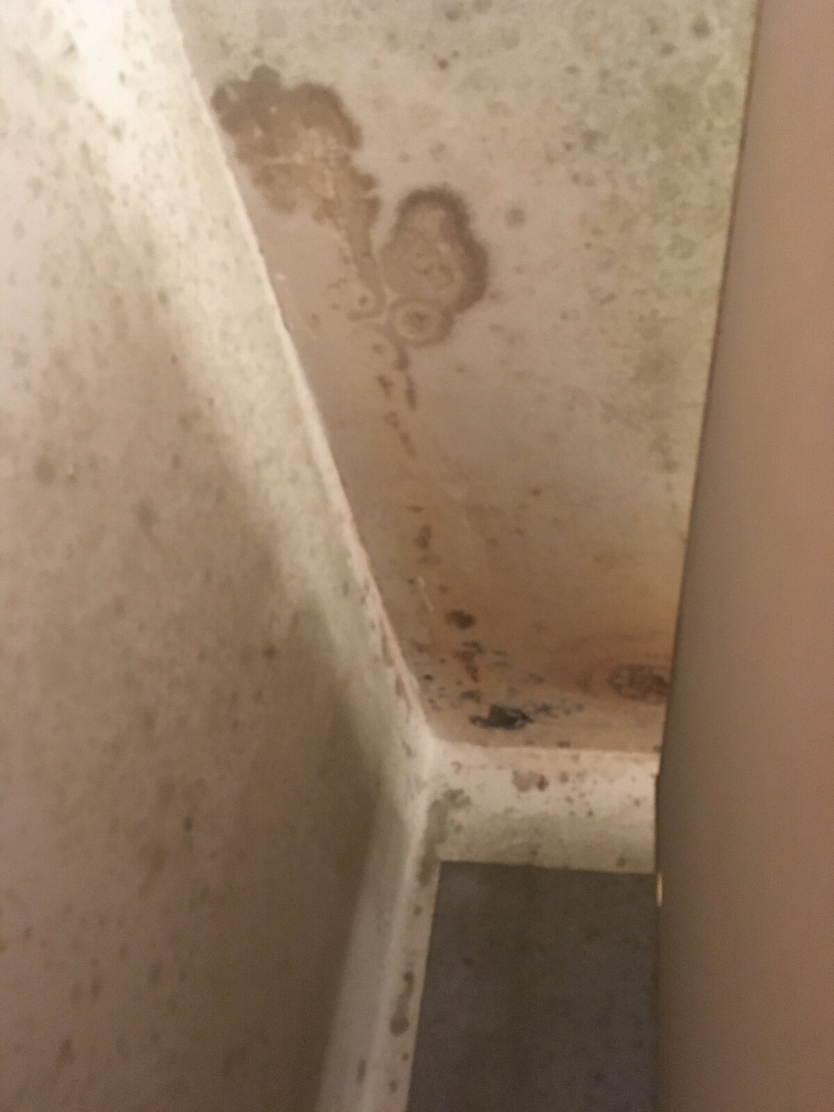

Hi all,
We started repainting the bedroom and in the small closet we have above the stairs, linked to our bedroom we discovered a lot of mold. We have there large cupboards, we aren't able to see above and in the back of them so this was going for a long time to get in this state, as it was painted 3 years ago. We called a local roofing firm with good reviews (not many though) and they said that they need to lift half the roof to identify the problem. And they quote us over 3k for doing that. Something didn't felt right so I'm looking for other roofing companies but I would appreciate if someone can give me some ideas regarding of what could be wrong with our roof. I'm attaching images of the cupboard interior and of the roof, the cupboard is located under the front right corner of the roof, above the entrance. Many thanks!

it certainly looks like a leak
but to me it looks more like plumbing than roof.

Why are there such a huge number of roof ventilators?
Thank for responding JohnD, I'll get my husband to check the loft tomorrow, as it's not a walkable one so we need to put boards for him to be able to access that corner. I don't know why are they so many the whole neighborhood has them, we just moved here 3 years ago.

See if it cleans off with warm water and bleach.
You need to get airflow in the cupboard.
Lack of insulation above the cupboard will cause a cold spot and condensation.

Keep the wardrobes out for the time being and spray the mould with something like disinfectant.
Thanks Catlad, I'll do so. We sprayed all the interior with Ronseal's 3-in 1 mould in the same day we saw this.
If there's no insulation above that cupboard the ceiling there will be a cold spot, if warm moist air is in that cupboard with no airflow you will get mould.
