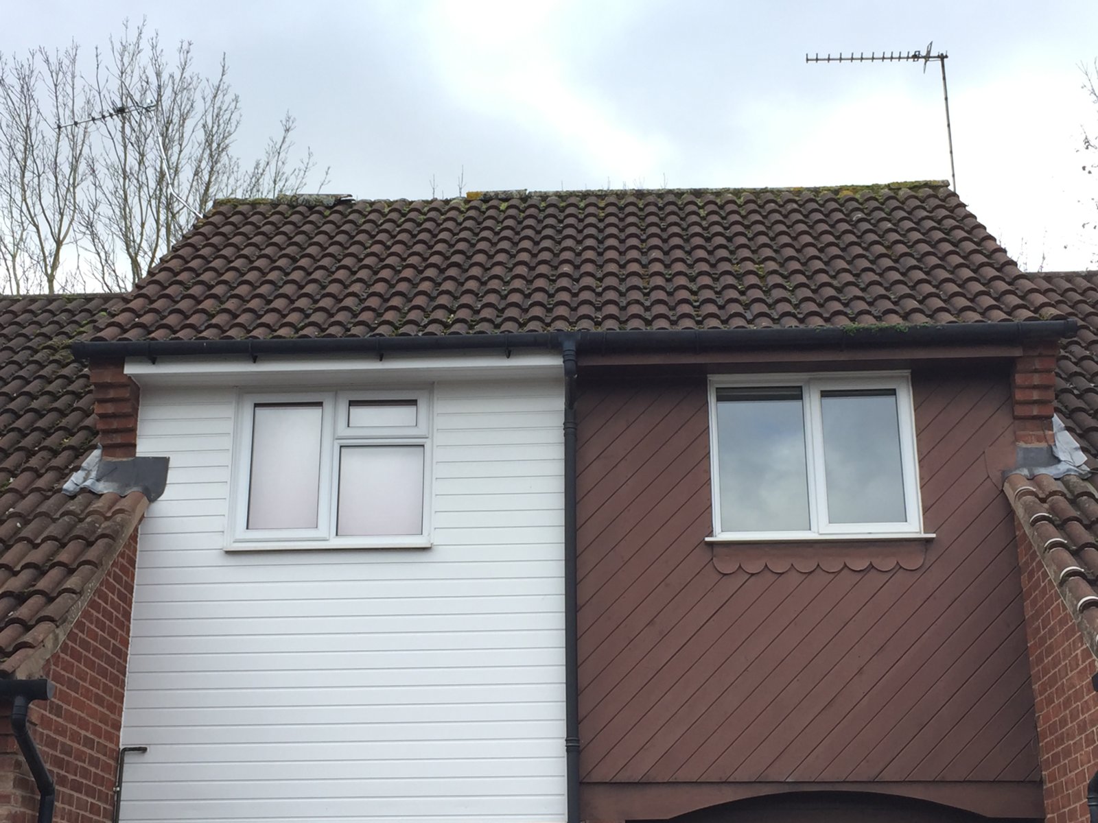

I’m currently selling my house and have already moved out. Yesterday I got a vague email from estate agents saying neighbour had been in contact about ridge tiles. I assumed some tiles had blown off my roof in the wind so went over today to have a look.
I’ve attached a photo. My property is right of the photo, my neighbour’s is left. The tiles have blown off my neighbour’s side of the roof. Unfortunately they weren’t at home and I don’t have a phone number for them, so couldn’t discuss.
Is this their responsibility or both of ours? I’m happy to discuss things with them but I’d like to know where I stand so I don’t get rail roaded into paying for repairs.

you dont seem to have any ridge tiles left on your side of theridge
- except for a remnant maybe on the fa right ofthe ridge?
why not go round the back of the house an have a look for tiledebris?

If you enlarge the posted image, in effect Zoom in and look at the second ridge tile on the right, it does not appear to be there?? or is smeared with mortar?
The extreme right hand ridge tile appears loose?
OK not the end of the world, the purchaser should have a house buyers survey? OK these Surveyors vary wildly in their ability to see real defects??
As for your Estate Agent, get on to them and politely advise them that they are working for you and your fee to them?? at the same time ask them to precisely tell you how they were informed of the roof issue?
If the damage has occurred during last nights storm? that can be an insurance claim, but the excess could be more than a local roofer undertaking a repair?
As for cost of repairs? two roofers 4 hrs @ £ 25 / each + materials certainly no more than £ 100??

The ridge tiles on the r/h side property are all present barring the one at the verge which needs re bedded.
An hour's work.
