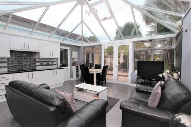

We’ve just moved into this house which has a kitchen diner inside a conservatory. The pics below are from the Rightmove advert.

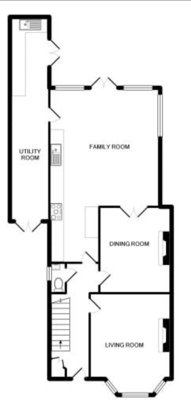

2 sides of the conservatory are the existing house and a utility room, a third wall was built for the conservatory. Only the rear 4th side is glazed substantially with a dwarf wall.
The conservatory has a 5 x 6m glass roof, so obviously the room is blazing hot / ice cold at various times in the year.
Is it hopelessly naive to think that the 3 sides of the room that are already built mean that a proper insulated flat roof could easily be constructed without the need for demolition and rebuilding ? Potentially this could mean less disruption and cost. I would also like to replace the garden facing glazing with sliding doors.

Does that have building regulations approval? It should have, and you'll certainly need it for any roof alteration, and suitability of walls, floor and other things will then come under building regulations.
I guess the question I’m asking is whether the existing structures (house wall, utility wall, possibly conny wall?) can be used to attach a replacement roof that *does* meet building regs, as an alternative to taking the whole thing down, ground works etc.
The new roof would be built off (largely) the house and utility.
Unlikely the walls are adequate in strength or thermal performance.

the glazed roof would not have complied with the thermal requirements of part L of building regs -its possible a SAPS test was done and compliance was achieved by making improvements elsewhere
It looks quite straight forward to me to take off the conservatory roof and replace with a flat roof, perhaps with a smaller lantern - which is what it should have had anyway.
And no I dont think its naive to think that could be done without much alteration to the rest of the structure.
in regards to the patio doors -you might find that is a bit more involved as you there seems to be little at that end for lateral stability and you might need some steelwork and structural engineers calcs.
you need a reasonable budget for a new roof etc -say £30k

The conny didn’t have BR certs when we bought it (apart from the kitchen installation electrics) which I know it should have had, given the external-grade doors to the original kitchen have been removed. We were ok with this as we always intended to replace it with a more sensible solution.
We’re happy with the existing layout, and the old dining room is a snug/media/play room, so not too worried about light in there.
Useful to hear from notch that a flat roof may be possible. Presumably clear out all the upvc and glass and the new roof could be built off the house, the utility, and the 3rd wall, which will need checking by SE and suitable rebuilding or steel supports where necessary ?
