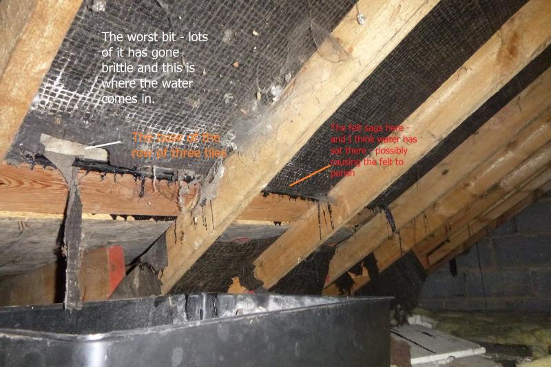

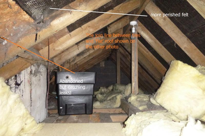

The leak is caused by the roofing felt having failed on one side - for the majority of it's length. It's become dry and brittle - it's 1970s original so not a big surprise. He's recommended the following tasks:
- strip the three rows of tiles between the flat roof and ridge, the ridge tiles, and one the other side
- replace felt with breathable membrane, over the top and down the other side and rebatten
-replace tiles and reseat ridge tiles - adding some vents (at my request)
£800. It's about 14m length.

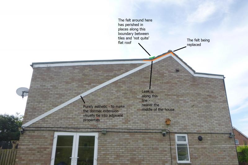

I have added some annotated photos. I can't get up to the roof so this is the best I have got. I have tried to show where the leak is, why I believe the felt has perished and what they are proposing to do.
by the way - the house is the best part of 12m wide - so it's 12m x 3m of felt, three 12m rows of tiles and 12m of ridge tiles to remove and reseat. probably quite small by US standards! but quite wide over here - for us normal plebs anyway ;)
The slightly sloping flat roof is extension, as is the side of the house shown in the first photo. It was a 7m wide bungalow - that was extended with a second floor (the flat roof) and lengthened to 11m.
I think that when the old roof felt was cut and joined to the new flat-ish roof, they didn't make it a taught join - which allowed water to pond on the roof felt, which allowed the roof felt to perish.

Is the fake barge board in PVC? It should be. It could interrupt water falling down the gable, and cause minor brick staining.
The boarding on the flat roof appears to stop short of the pitched roof - there might be a gap (or so it seems from the pics).The pitched roof felt should have covered the flat roof felt - hard to see how it does cover the lower felt.
There should be either flashing or a minor felt upstand at this join - it depends on the pitch and falls. Pics from outside req'd?
The hot bitumen should not have penetrated the boards - period, and definitely not penetrate above the horizontal lay board. It appears to have been a scruffy job, and scruffy work sometimes means careless work.
Before removing ridge tiles etc. it might be best to simply have the join of the two roofs exposed as non-destructively as possible - and then have pics taken of the findings?
But without pics of that external join arrangements its difficult to advise you.
On the face of it, £800 is a fair price - but will it permanently solve the difficulties? Dont be in a rush, get another quote and pics if possible.
yeah - it's PVC. ugly little thing... would be nice if it happened to fall off... ;)
