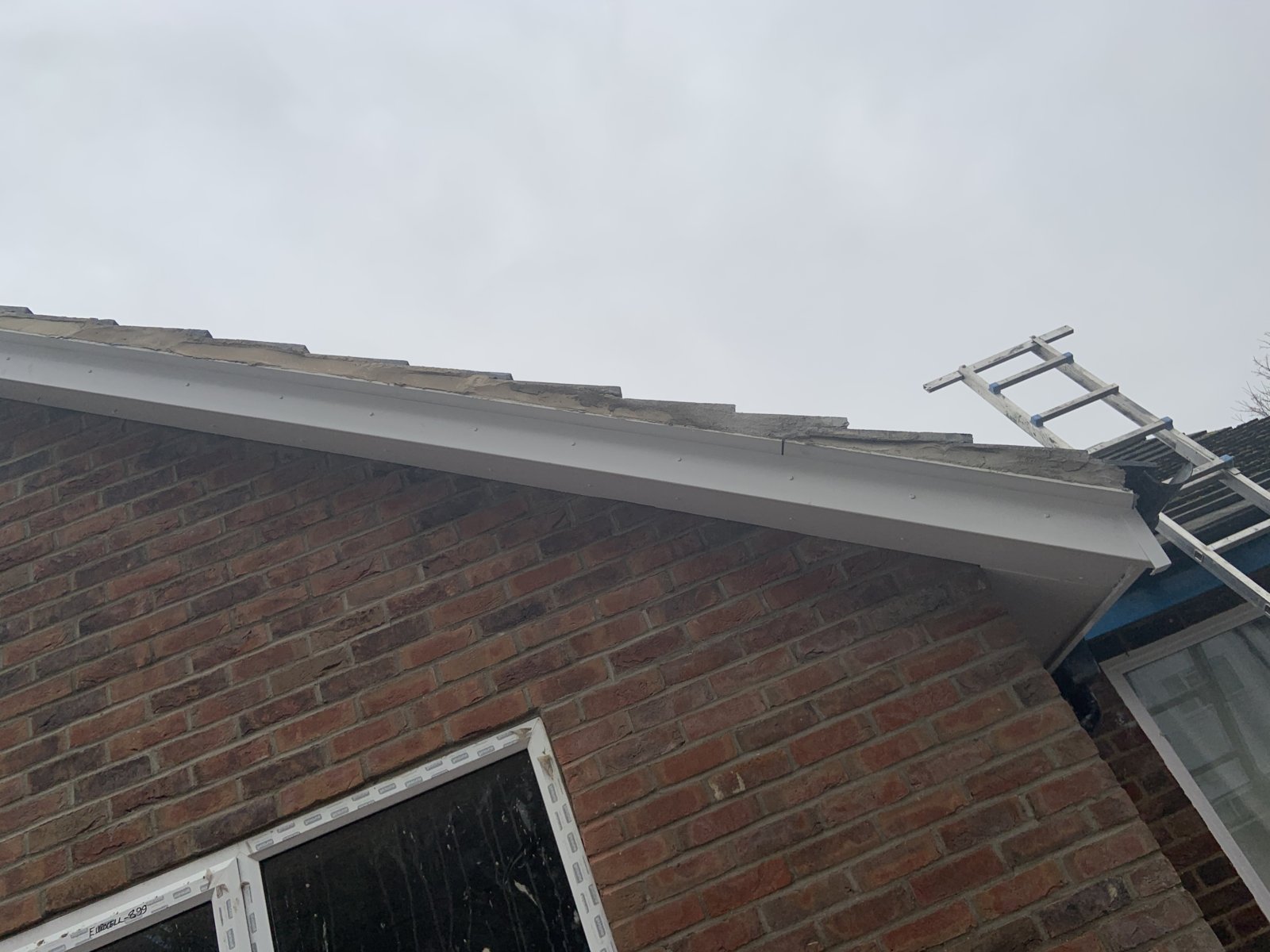

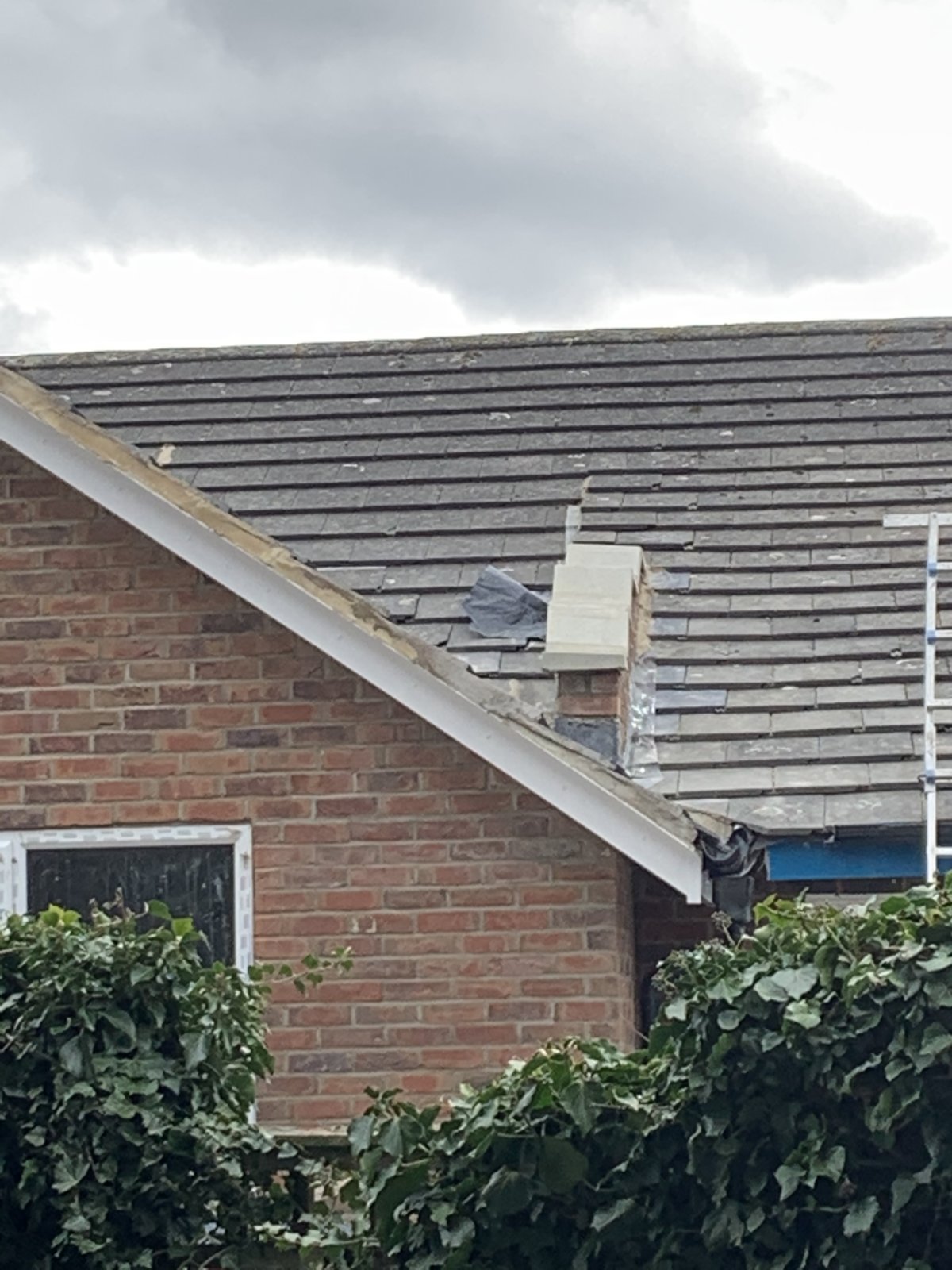

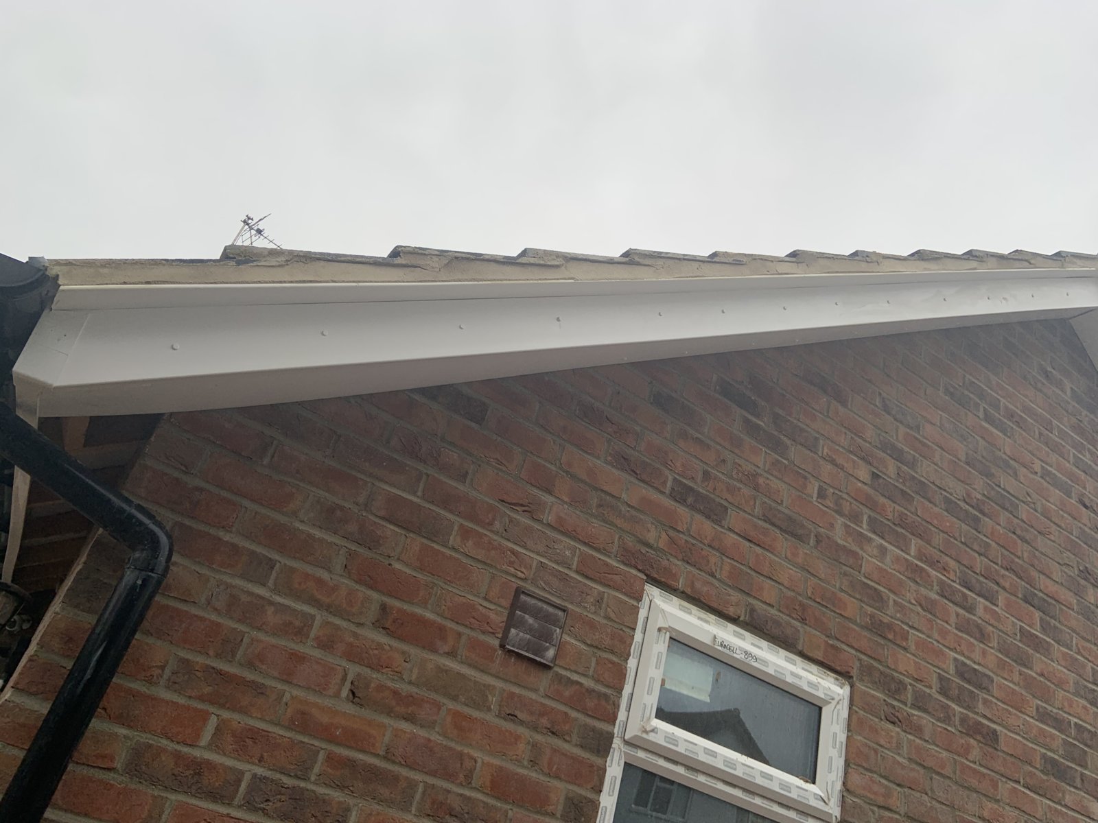

Our builder finished our new pitched roof with concrete tiles for the extension.
Can I ask some questions about it?
1. The underboard of the roof over hang is plastic board (the same as the UPVC fascia board) with cement filled between this plastic board and tiles. Does cement bond to plastic? How urgent do we need to rectify it?

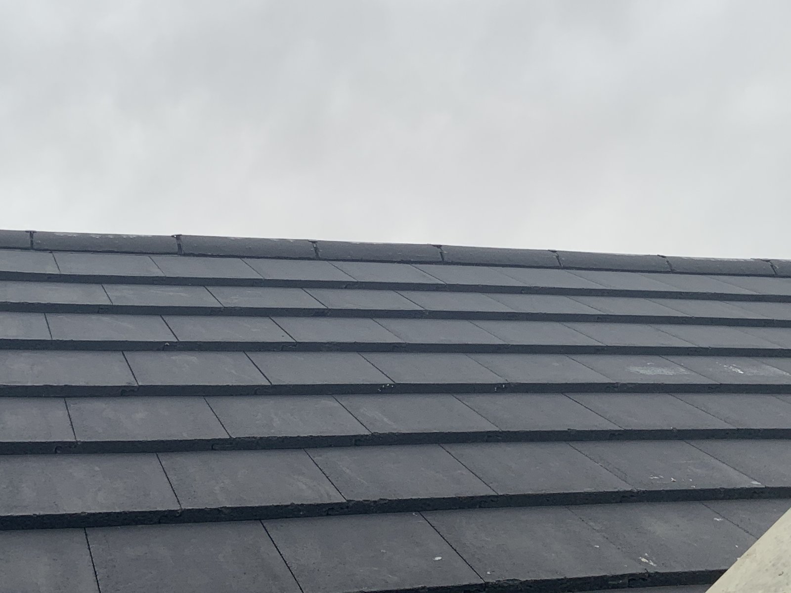

2. The last row of roof tiles were cut short (nearly half is cut), which I believe is not right. Will this cause leaking or just not looking good? Does the batten gauge have to be rectified? I have been told the batten gauge should be divided sort of evenly.
Thanks for your advice!

Here are pictures.

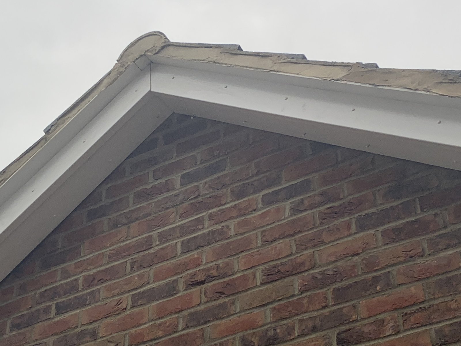

plastic under cloak to the verges is wrong, cement fibre or slate should be used to a wet verge.
mortar work is very poor and i wold not accept it.
the batten gauge should indeed be equal up the rafter length .
to correct this it would all need to come off.
The first course that has been cut need not been cut at all more head lap could have made this a little better
The valley detail is wrong, lead is too short they have bodged that with a piece of gash lead
general standard very very poor

The wet verge can possibly be changed over to dry.

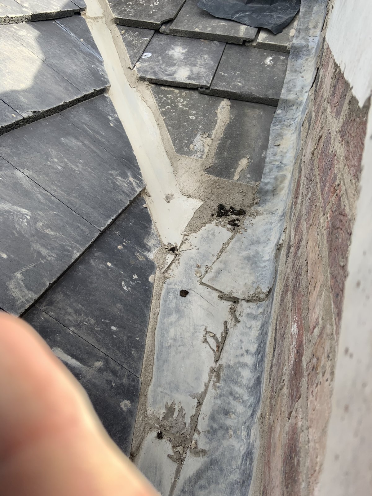

I took more photos of the wet verge.

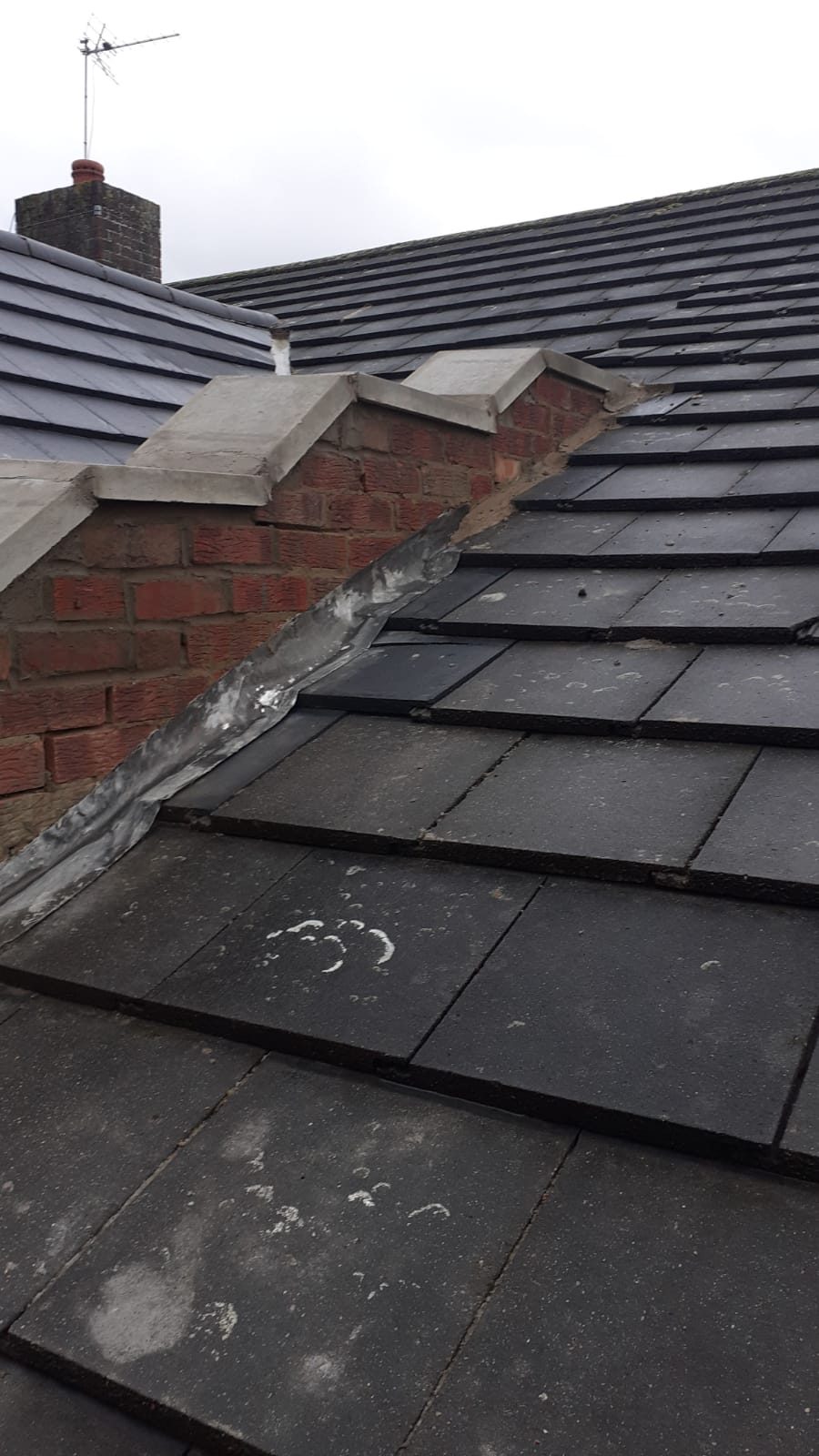

The lead flashing along one side of the parapet wall is totally rubbish. I will get it sorted first as an urgent repair. But the parapet wall itself is very ugly as well...

Looks like they have used dpc for the soakers.
The brick work is worse than the leadwork.

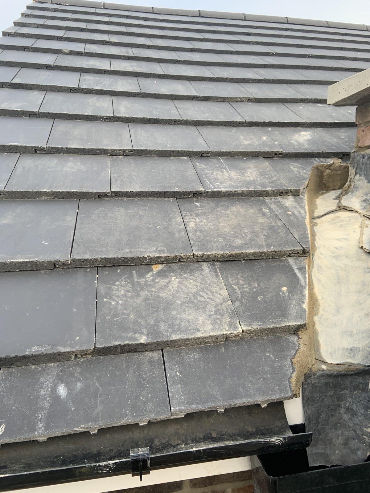

Which part is called soakers? Is it the valley on the other side of the parapet wall? I have more photos to show it.

Sorry, just understood it. The soaker must be what call as lead flashing.
We are trying to lower the parapet wall if possible. This was built by the builder after months of leaking on the left side of the valley (as seen in the photo of my last reply).
the only bit of a soaker we can see (on the RH side) looks like lead - thats if it is a soaker.
soakers are typically hidden under the tiles.
it looks like flashband has been used as flashing on the RH side?
the roof coverings are a mess - cocked up tiles and out of bond.
the parapet's irrelevant - drop it, & roof over.
the valley is a nonsense. replace it with a modern trough.
you dont show the verges from above but they will probably need re-doing?
whats been hidden we obviously cant see so dont know?
use a roofer to sort the above at a min. - or bite the bullet and re-roof with a pro roofer.
