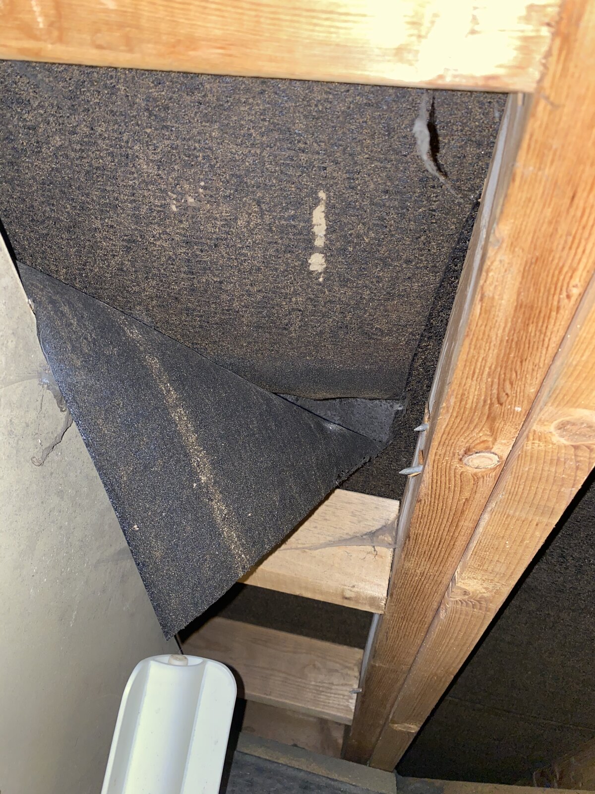

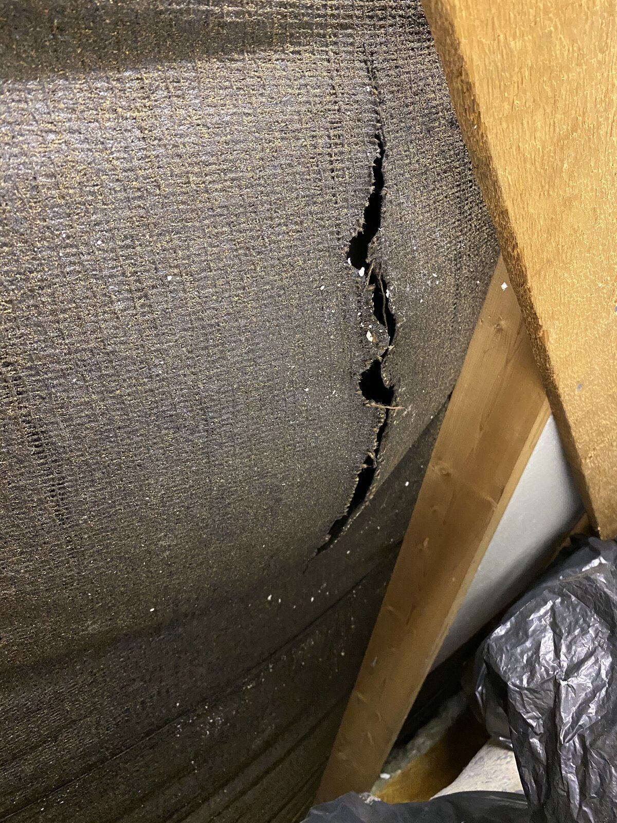

Hello,
I’m looking at repairing two areas of the roof felt,
whats the best approach?
Thanks.

Arrange safe access. Strip back tiles or slates
Ease up battens and remove nails
Trim back saggy felt
Slip new piece of felt up under battens and under the felt lap above.
Put roof back together.
That's the tough how to.
Problems arise if it's near a verge , hip , valley or ridge.. then best left to a competent person
