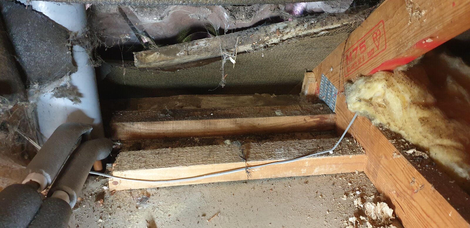

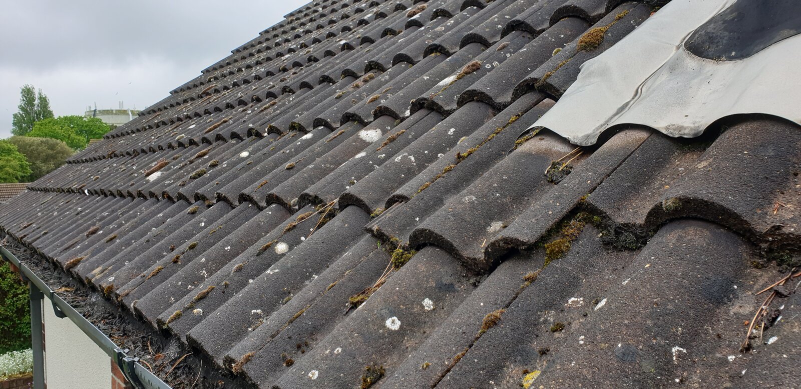

A leak in bungalow roof caused an ingress of water a couple of evenings ago. The following morning a quick view from the garden showed that one of the roof tiles had slid downwards creating a small opening. This tile normally sits under the flashing of a ventilation pipe. Upon checking out the loft more closely I have removed a section of the damaged fabric that lines the roof as well as some of the rockwall insulation between the joists. I have left the tile out of position in order that any damp will vent to the atmosphere but will close this prior to the next rainfall.

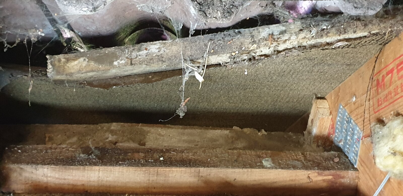

What I can see is that a wooden batten has come away from its fixing – perhaps into the vent pipe – and I am unsure how this should be repositioned into place. It is pretty difficult to get close to the batten as there is limited space in this position of the loft – right near to the gutter etc.
Any advice as to how I could go about sorting this would be much appreciated. Thanks in advance. :)
Yeah, I’d employ the services of a good roofer.
Could you not lift the lead pipe vent cover, remove a few tiles, replace the batten and refit the tiles?
Looks like when the stinkpipe was fitted the batten was cut and it was just hanging there?
You could remove a row of tiles and fit a batten underneath that one if it will go around the vent pipe. Then replace the failed batten and screw it to the new one underneath?
Or put in a new short rafter for the batten to sit on...
