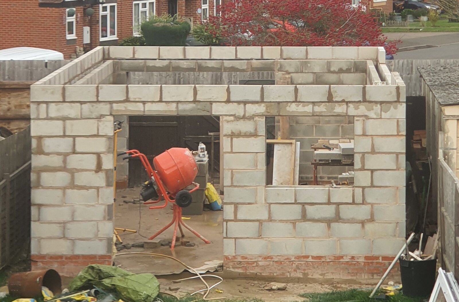

Photo showing build so far, all self built with help from friend's and family
