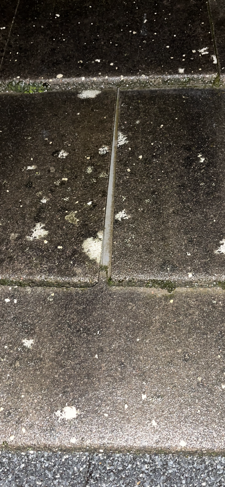

Hi Guys,
Whilst sorting another job out, I noticed that the roof tiles on my porch have separated and I’m guessing what I am looking at is the felt membrane. Whats the best thing to do here? Instead of getting a roofer out to re tile can I fill with mortar or a type of sealant?

Is the tile overlapping by about 1cm or I am looking at it wrong. If so you are relying on the membrane to keep water out.
It’s not overlapping. The tiles have just separated a little, probably by a few mm
I meant the top tiles overlap of the one beneath. You shouldn't be able to see the membrane, you should just see the tile below
It's the interlock on the tile channel you can see. Just needs nudged over a little.
