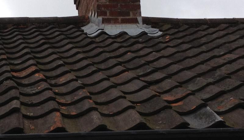

Have a few roof tiles that need replacing, cracked/damaged etc
Can someone help me identify what these type of tiles are called, to make it easier for me to find replacements? and possibly recommend where I can get them (I am located near Norwich)
Many thanks
They are similar to a Marley 'Anglia', only your look like clay fellas.
Only way to find out is lift one off and have a squint at the back of the tile.

thanks - what am I looking for on the back?
Words. :mrgreen:
Seriously, manufacturers emboss their name in the backs of the tiles. Having a sample in your hand will be useful should you visit a roofing or reclamation yard.

okay will look tomorrow
wanted to buy over internet so not much use to me i'm afraid - really need to know what they are to search for them

fair point, but can't find any stores that sell them out my way - hence why intending to use internet - and you should be very careful saying things like that, for all you know I may have been disabled!

Testes :?: Check out the grey one in the pic - it could be a later concrete one as good a match @ the time to the clay ones , whenever it was slipped in :idea:

You may be best off checking reclamation yards as yours could be obsolete. We have a good yard by us called Cawarden. If you can scan an image to them they may be able to i.d.
They are a clay PANTILE there are many variations in depth of pan and even in channel structure. taker a sample to a good reclaimation yard that keeps roofing materials..
